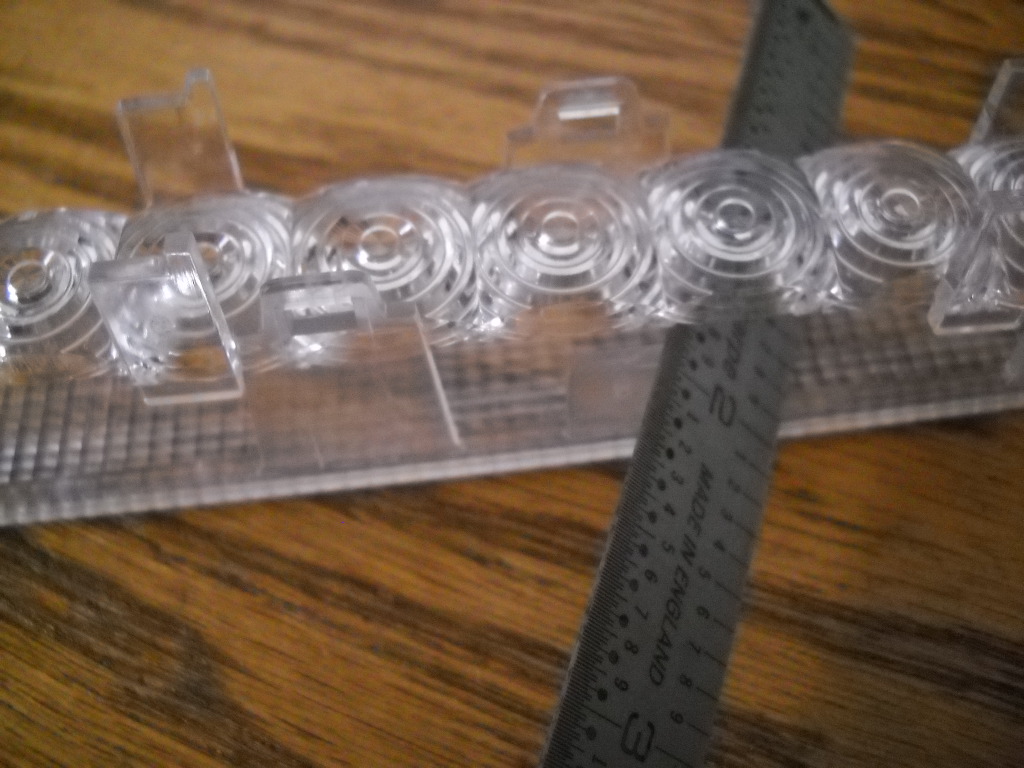

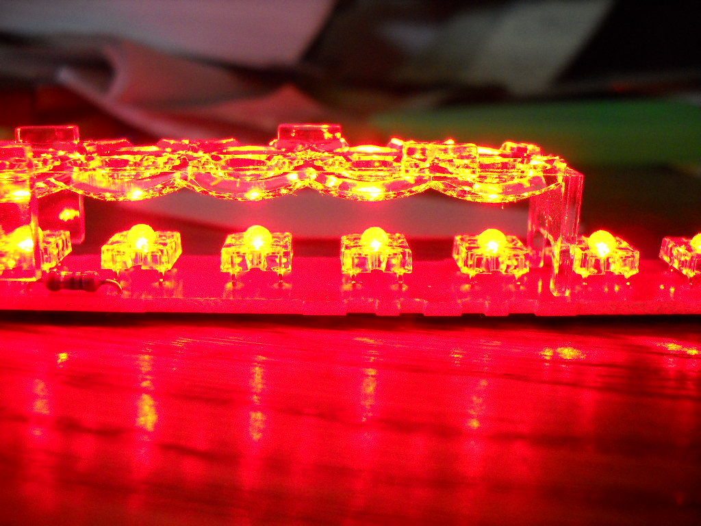

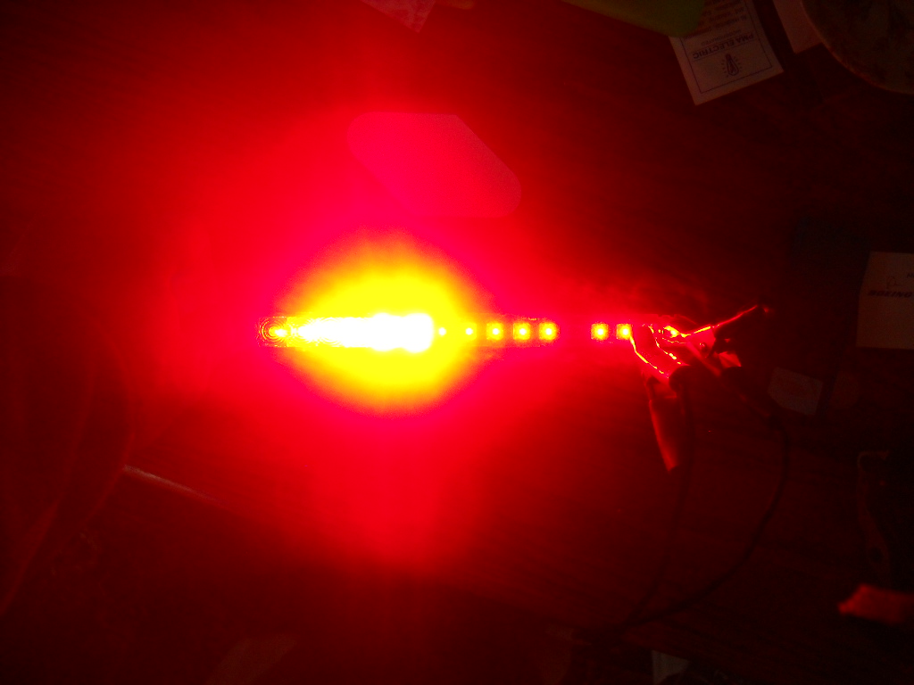

ok so i got around to getting some pics of the volvo 3rd brake set up. The first pic is crappy but the bright part is magnify piece in place the not so bright are just the leds.
second is a side shot
And then the diffuser lens lifted so you can see it
So maybe brighter leds are not the answer? Are there any "focuser" lenses out there that could be added to the board end of things?
The other car tail light leds i was looking at had a cup around the led. It was the old flashlight idea. Small light but the reflective dia is bigger/brighter.
just giving input.

Thanks for the visuals. The lenses are an important part of the LED lights. I think pretty much all LED lights have some type of lens or reflector to focus or diffuse the light as needed for the application.
