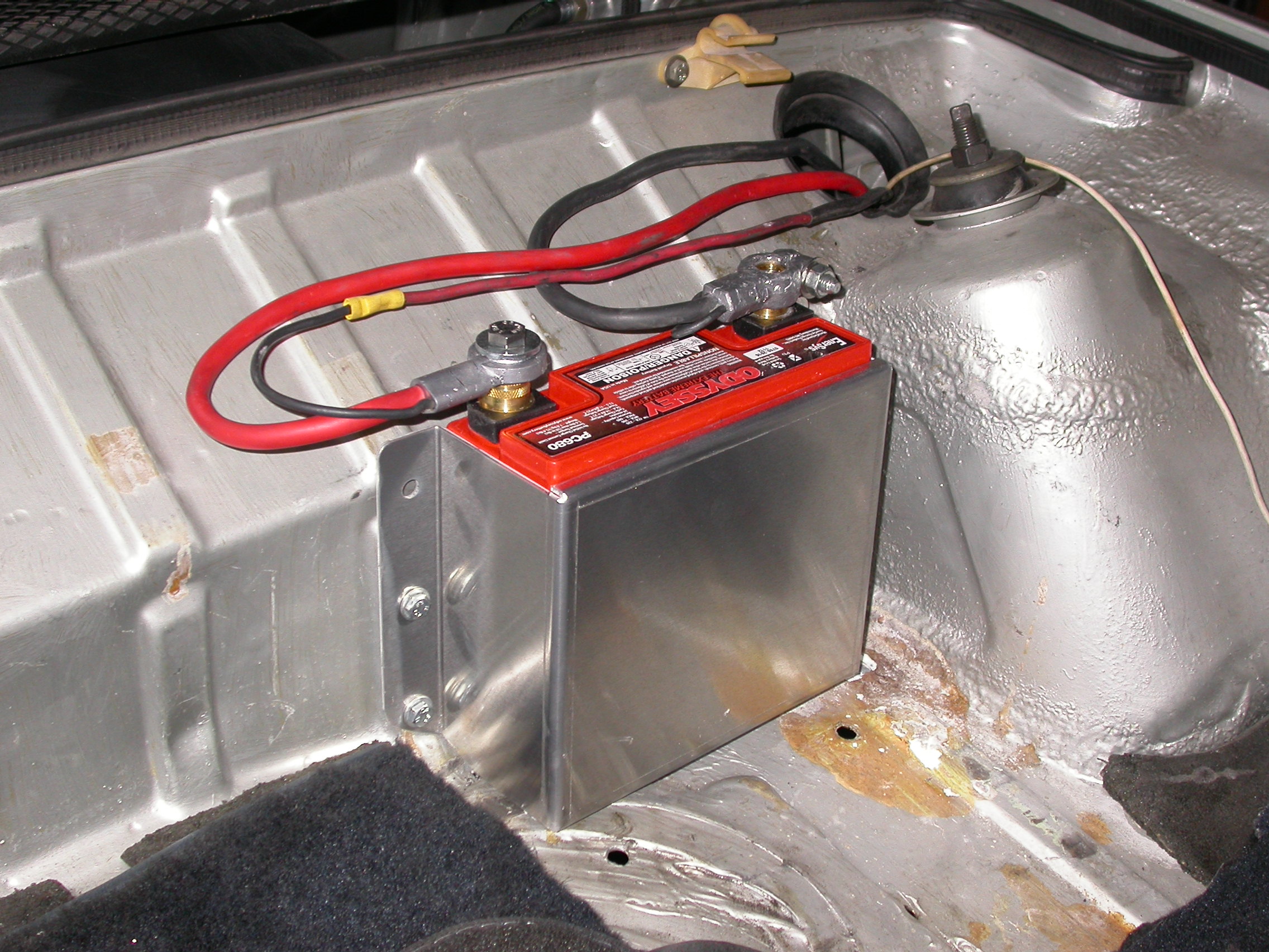

I've become a fan of the Odyssey batteries. I ran one for a couple of years in my 914-2.0 and it worked flawlessly. I recently installed one in my 914-6 and so far so good. I also have a buddy that has been running the same battery in his 911SC for many years w/ no problems.
They also make a simple, but effective formed sheetmetal mount that works good. My car had the battery tray removed and the battery installed in the trunk before I bought it, but it was done poorly. The Odyssey is a much cleaner installation.
Rand

I'm also running an Odyssey PC680 and love it. Compact, light, and sealed.
The Reno winters occasionally get pretty cold (to single digits) and it has started my car every week. I do put a trickle charger on every once in a while.

Been running the PC680 in stock location for many years, always just works
that first day in march when I need to crank the -6 about 10 times to get it
going. Just bought a new one for ~$119 even though the old one is not dead
yet.
