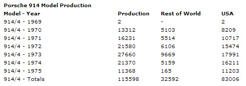

PS - An interesting data point in this recall campaign is that it applies to ~83,000 USA 914s, and was issued the year after the last 914 was produced. This is the strongest evidence I have come across that only ~83,000 914s came to our shores, because this recall campaign applied to all USA 914s imported to the USA.
Jeff - here is something to back up that observation:

QUOTE(poorsche914 @ Feb 11 2013, 07:42 PM) *
Slight hijack...
QUOTE(Jeff Bowlsby @ Feb 11 2013, 09:50 PM) *
WHERE did you find that? Source...? That must be a listing by calendar year not model year. Awesome, now that we know how many were shipped here, now we need to figuure out how many remain.
