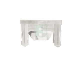

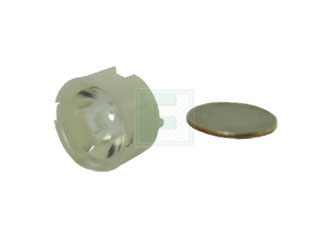

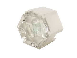

I've ordered some sample reflectors from Future Electronics. They have good prices and seem to have stock in hand.
I stayed with a tight beam angle 12 to 18 degrees assuming the light needs to be focused behind the car as much as possible.
I should have these in a few days then I'll do some testing to see which works best.
General Luminaire
Polymer Optics
Carclo Optics
