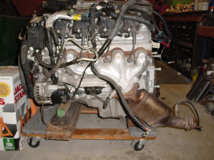

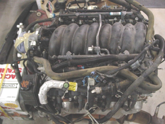

I wanted to avoid having a motor shipped, so I started searching for local yards that may have a LS1 with reasonably low mileage. What I found, was a salvage yard that specializes only in late model Camaro's/Firebird's, but motors go fast so I had to stay on top of them with frequent phone calls. They get two cars in, so I run down there right away. There's a '02 Firebird with 30 some K miles, and had the late and more desirable LS6 heads, but I found a mount for a nitrous bottle in the truck, so I passed. The other car was a "01 Z28 with 49K miles. Looked well kept and was hit in the rear. Started immediately, so I closed the deal. I had to come back the next day so they could pull the motor. Turned out that when I got there, they hadn't even started, so I waited another 1 1/2 hrs before they were ready to load it into my truck. Motor came complete with all the systems (harness, PCM, manifolds, cats, flex plate, starter, even the Camaro air intake box).
Andys
