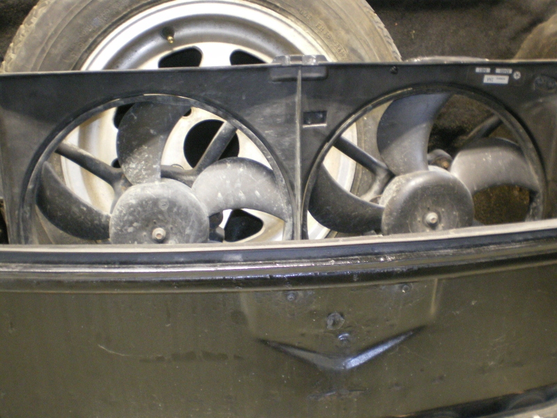

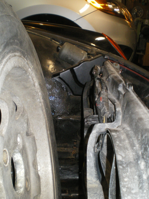

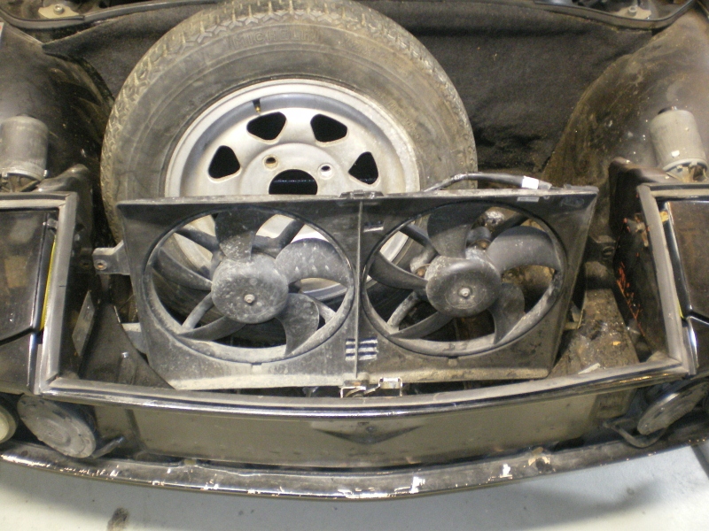

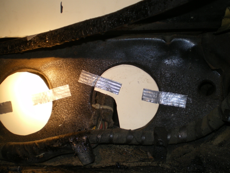

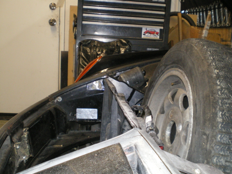

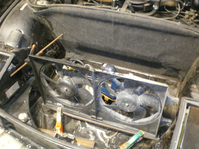

It's been too long so I'll post what I have. I've held back because the first fan assm has a bad bearing on one of the units and I ordered the wrong replacement (IMG:style_emoticons/default/headbang.gif) Jesus H. Anyway the radiator is held up in the snow storm so I went with "what I got" for now. I placed to fan unit for a quick birds eye view. Looks doable. Thanks for the tip BigCat. I went with your radiator suggestion too but it's not arrived.

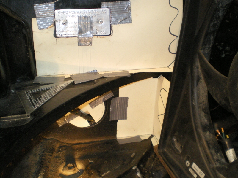

My plan ( I'm playing like I know what I'm doing (IMG:style_emoticons/default/happy11.gif) ) is to seal or box off the area immediately between the headlights to serve as a plenum of sorts. A quick temp install of the fans show they'll clear the sides enough.

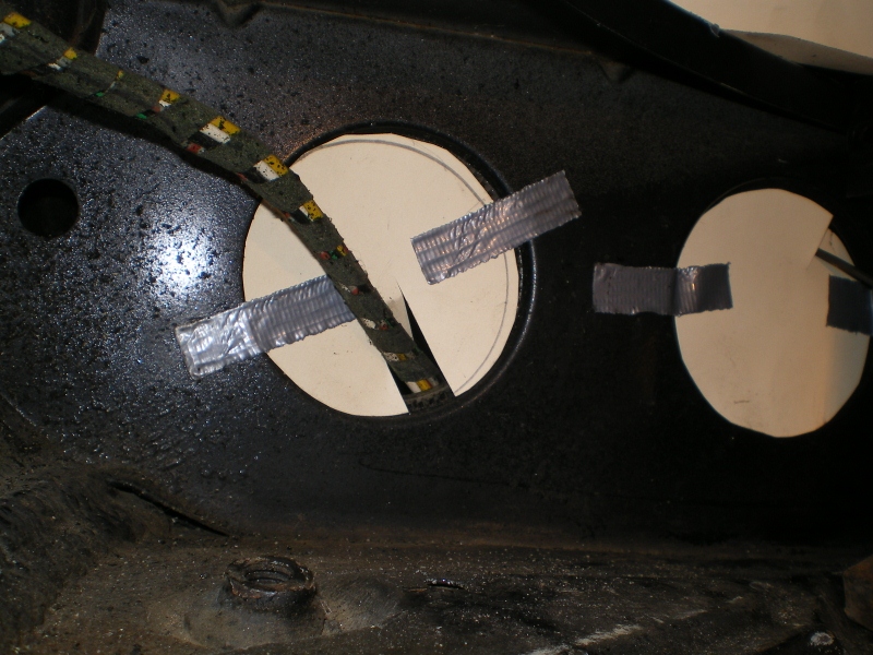

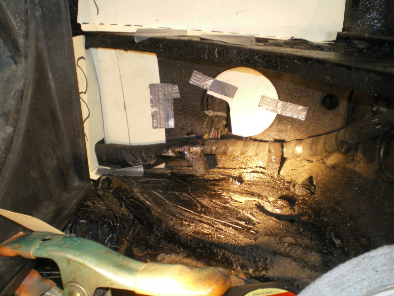

In order to do this the "box" must be reasonably sealed and here are a few lightning holes on these ribs that need to be sealed with the cardboard templates attached.
A few more but with the templates for the side pieces that will double as seals and attach points, I think (IMG:style_emoticons/default/smoke.gif)
