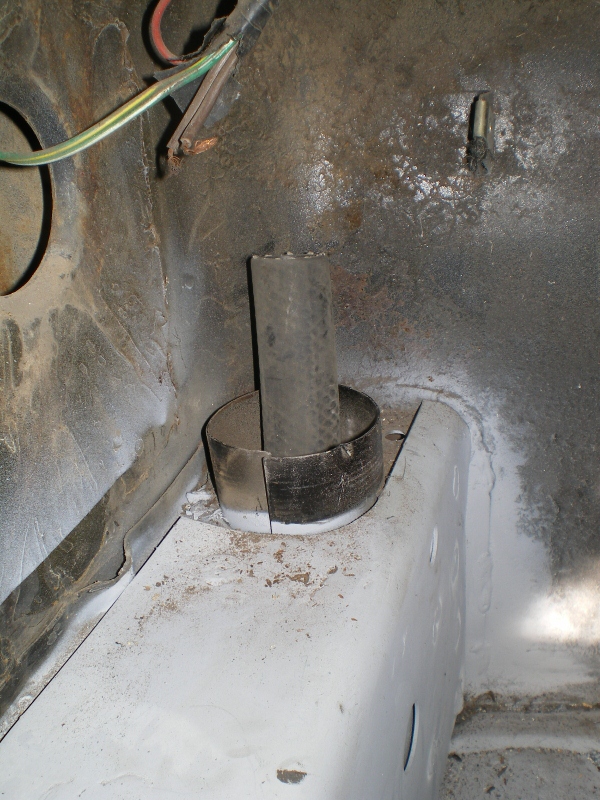

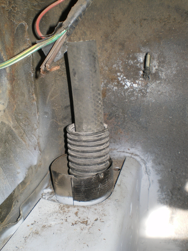

I'm going with a very good heater hose but not anything exorbitant. My heater hoses will not see the light of day so I see no need (at this time) to use green stripe or other big $$$ hoses. I was able to fish a piece thru the long w/o binding or kinking.
The trick is revealed. First fish the heater hose thru this vacuum/pool hose then fish the combination thru while rotating. The external hose has added benefits. It keeps the heater hose from crimping and adds some degree of wear protection to it, also. On final install I will trim the vac hose to conceal it. The metal opening will get a rubber grommet to center the heater hose where it passes thru on both ends. Will help to keep other critters out as well. (IMG:style_emoticons/default/happy11.gif)
