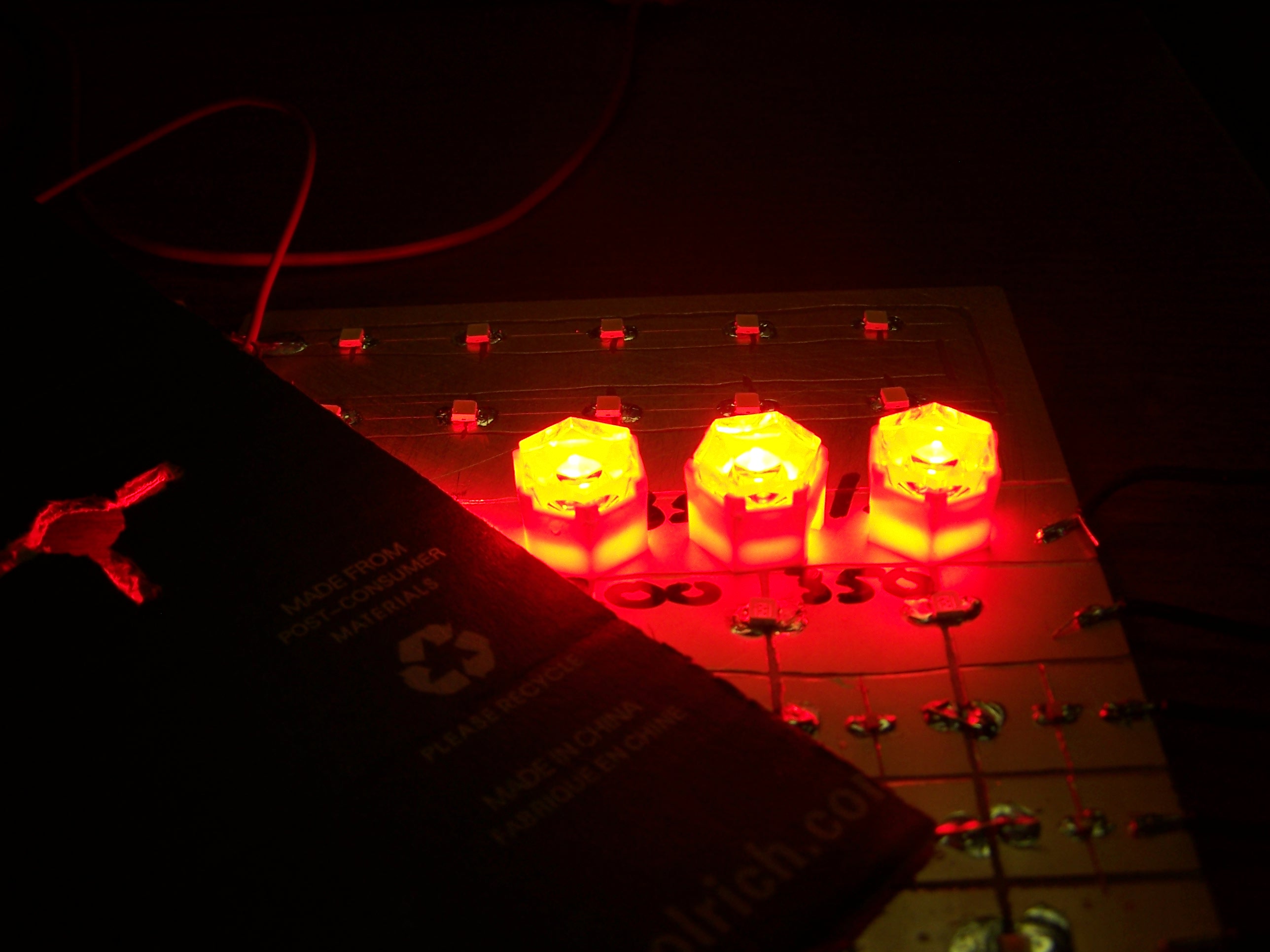

This first one is the Polymer Optics lens. This has a 12 degree beam angle.
I have only 3 samples shown here. This is with 200ma current through the red LEDs. At 200ma, the LEDs remain cool as ever. I've run these for 15 minutes at a time and they are just above ambient temp.
HereAttached Image

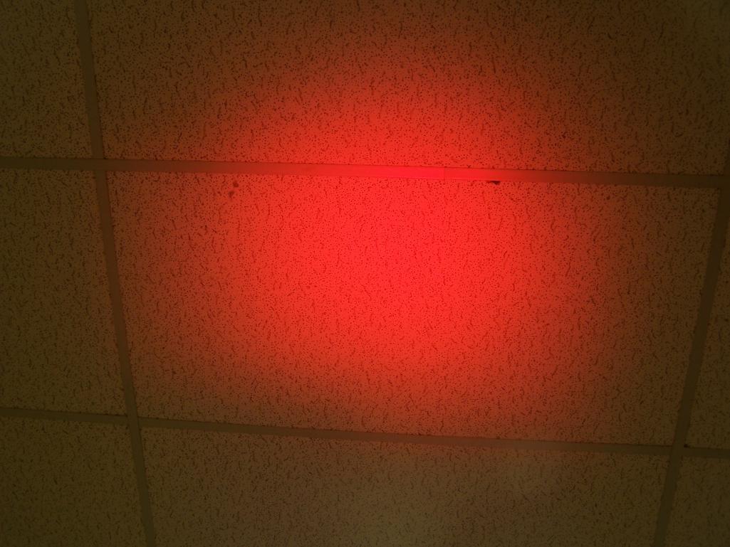

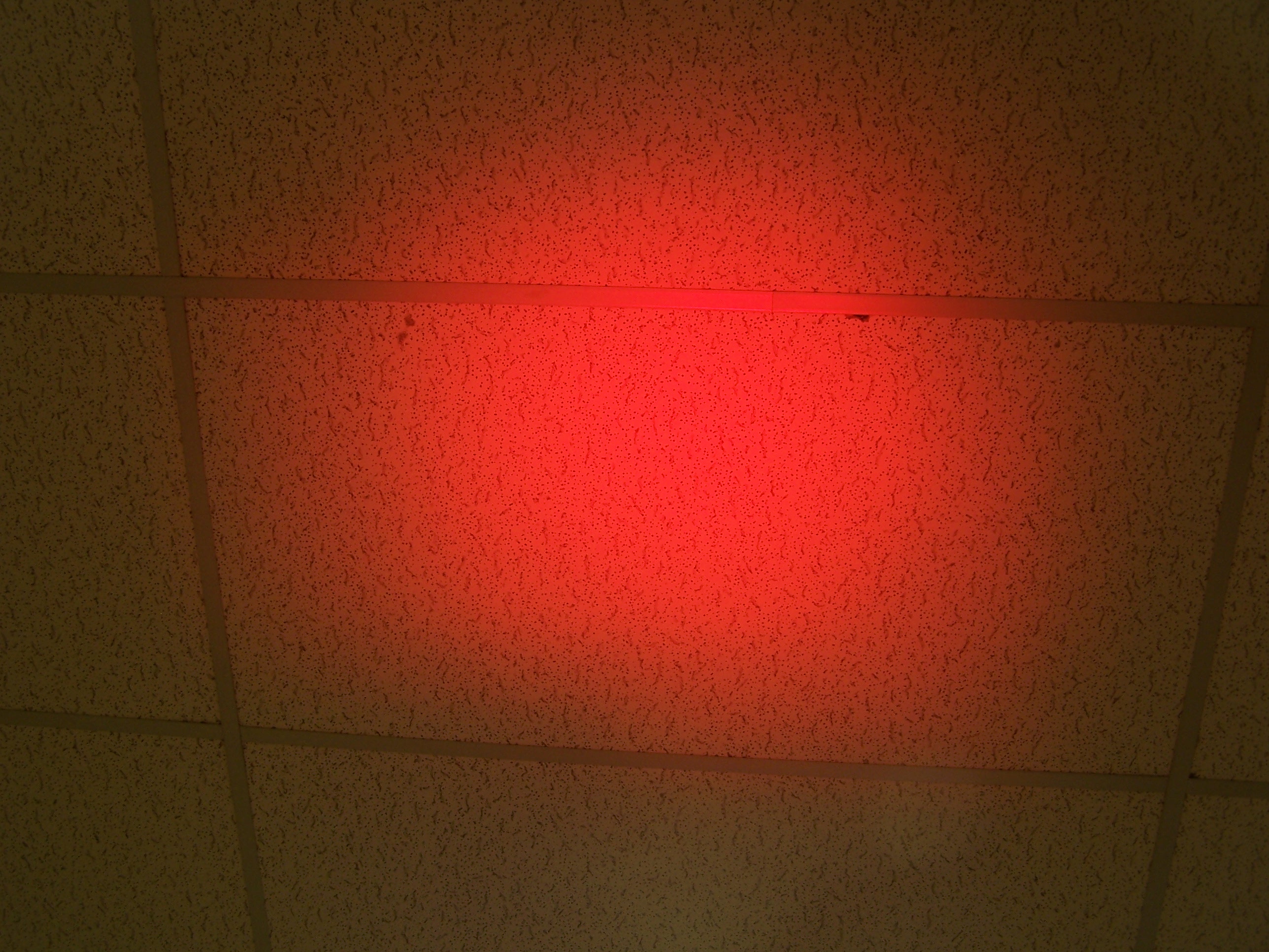

This is the pattern on the ceiling about 6 feet above my desk. The light is quite bright but as is observed, very focused. This is 3 LEDs, I'm planning to have 20 LEDs for the brake/running lights.
