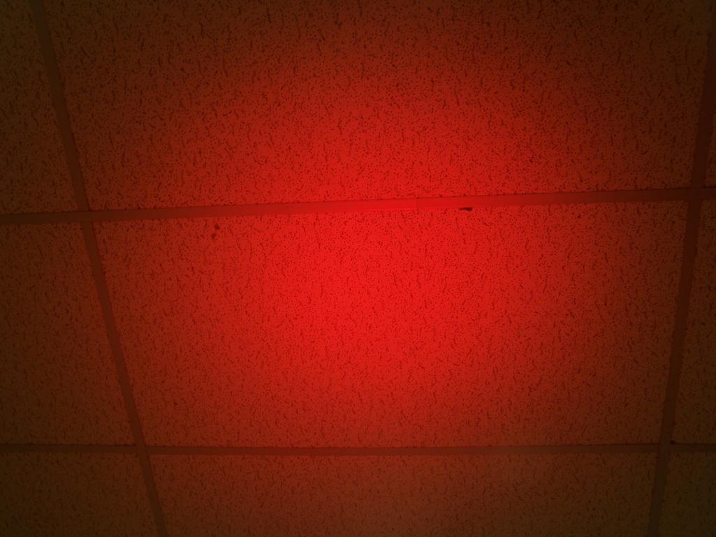

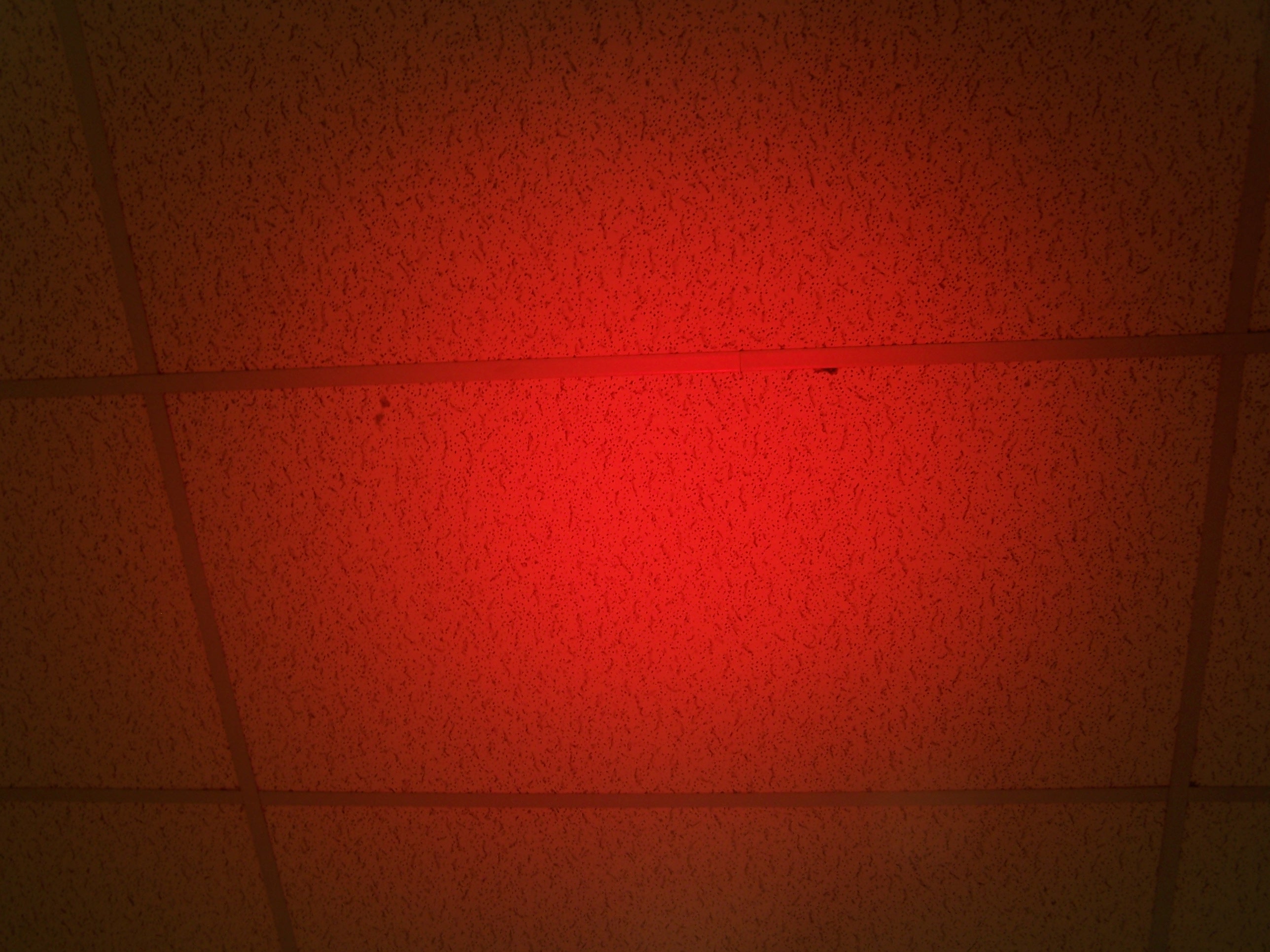

Next up are the Carclo lens with 18 degree beam angle.
The lenses are tiny items only 10mm across and are very efficient at focusing the light energy from the LEDs.
Just a comparison of the light with and without a lens. This is with 4ma of current.
This is the pattern on the ceiling with 3 LEDs running 200ma. The beam is a bit more dispersed as compared to the Polymer Optics lens. I'm liking these ones more but I still not sure if the beam is too focused.

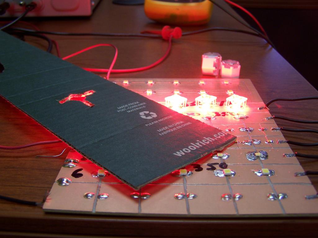

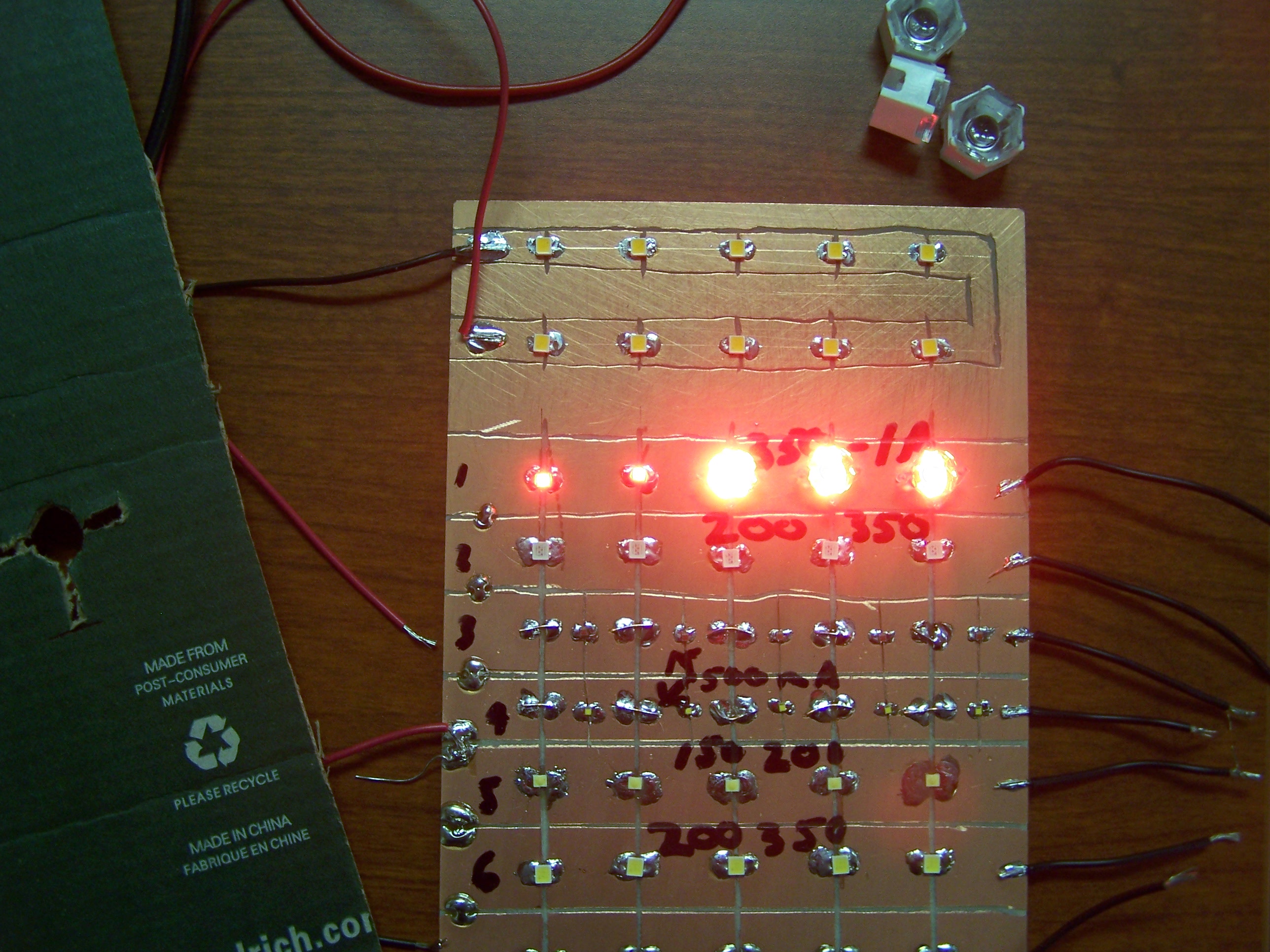

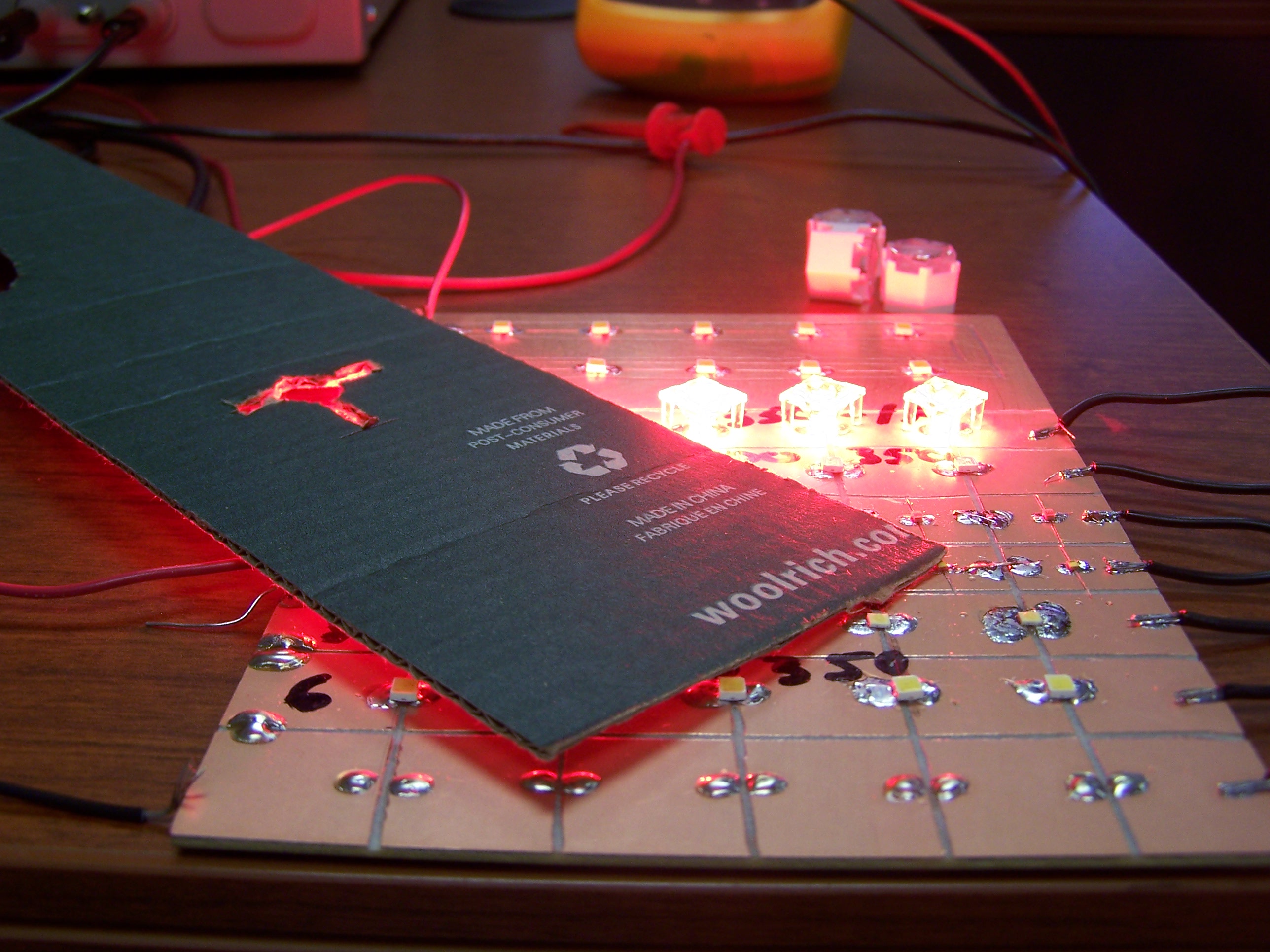

Spoke   Here's the test fixture that I've used to ...   Jan 29 2013, 11:52 AM
Spoke   Here's the comparison with the existing brake ...   Jan 29 2013, 11:54 AM
Spoke   The standard backup light is 25W which is slightly...   Jan 29 2013, 11:58 AM
