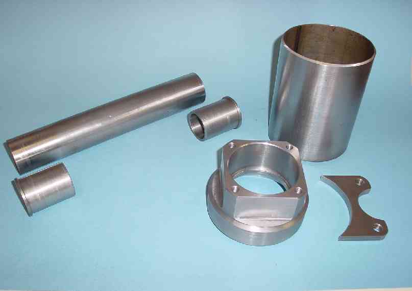

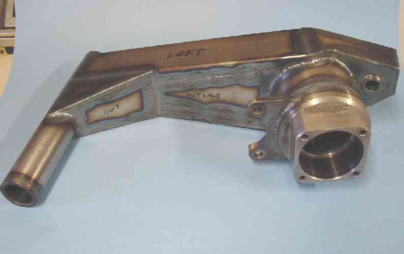

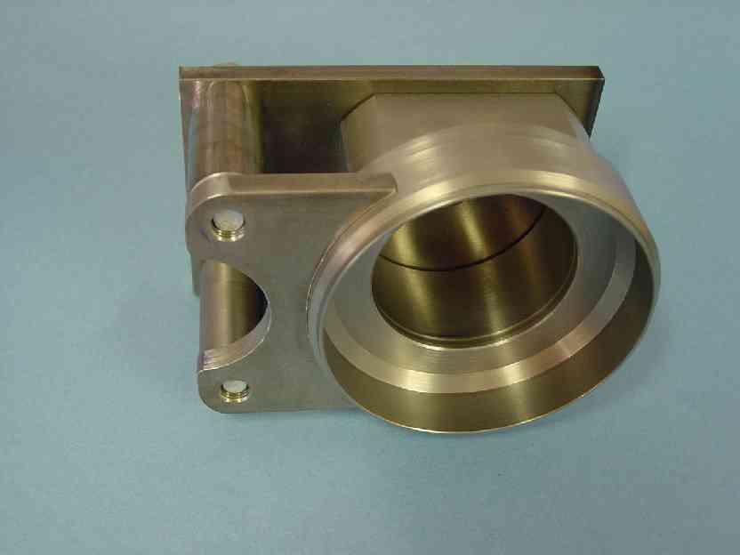

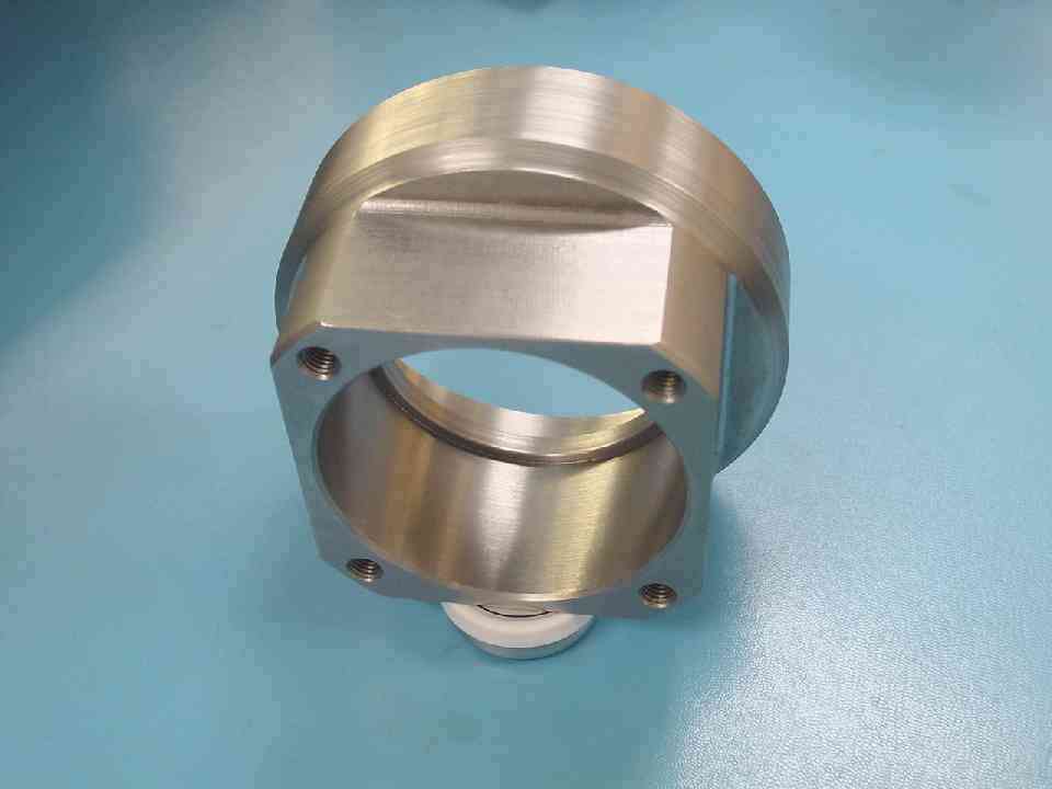

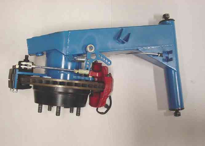

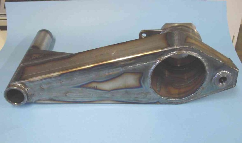

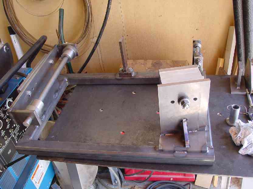

So we've got the motor/transaxle mounted, and the CV adapters made, how about we move on to making some custom trailing arms. The idea here, is to accomodate the larger 911 hub bearing (and 911 5 lug hub), and since the 911 axles combined with the 01E transaxle place the hub bearing farther outboard by 1.1", I can configure the trailing arm accoringly.
I first started by designing and fabricating a fixture that places everything at the proper relationships to each other. The fixture can make trailing arm geometry with zero, 1 1/2 and 3 degrees of camber relative to the pivot shaft. The stock angle in 1 1/2 degrees. Additionally, I can change the height of the (lower) shock mount to accomodate a lowered car. I chose to stay with the 1 1/2 degrees of camber, and the stock shock mount position (though in retrospect, I should have chosen a lower position). Oh, one other variable the fixture can accomodate, is the bearing carrier position. It can move inboard or outboard....as mentioned, I needed to move it outboard by 1.1" for my setup.
First on the list, was to machine the bearing carrier. That was a lot of work mostly due to all the hogging of steel when starting with a solid piece of round bar, but it got done! Then on to machining the other various components including the 911 caliper mount, the handbrake caliper mount, and so on. The pivot shaft housing (tube) is designed to accept Delrin bushings.
Once all the pieces were fabricated and placed in the fixture, I started TIG welding. Dang, that was a lot of work!
Hopefully, the photos will go a long way towards explaining haow it all got done, cause I don't type so fast!
