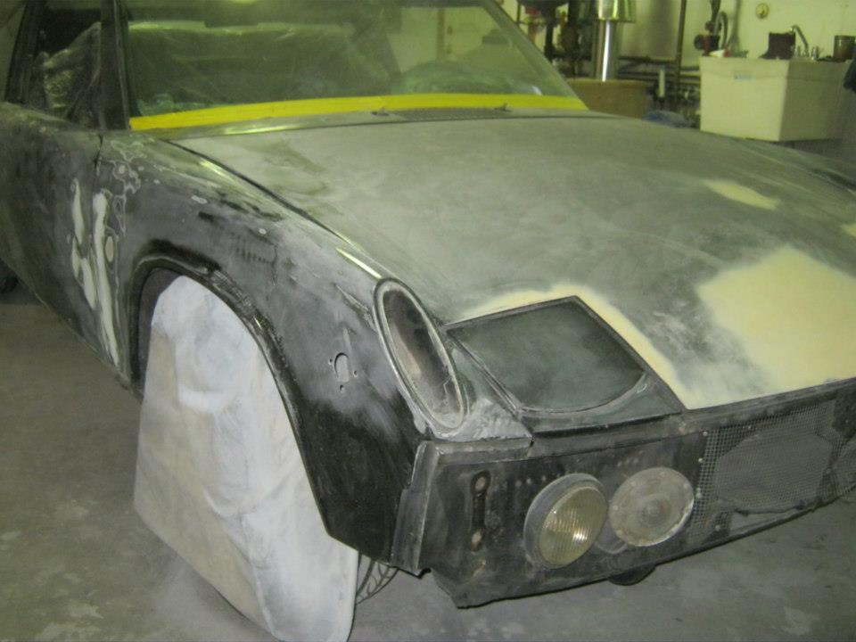

Steve has spent some time working my hood, but we may have to fall back on that.
It has never really lined up very well curve-wise with the front fenders. In this picture you can see the oversized cutouts in the the front bumper area. PO lived in the south, and between the AC he installed and the humid weather, cooling was a apparently problem, so he tried to solve the problem with bigger cutouts both in the bumper and the inner wheel wells. Unfortunately, he went too far. You can just barely see in this picture that the center "strut" PO tried to leave to stabilize the bumper area was too narrow, and it just cracked straight across near the top. The result is that the lower part of the hood latch moves around, and doesn't hold the damn hood down, so it lines up and looks like poo.
The hood has also separated from the frame, and the standard hillbilly repair of JB Weld done in the past did not hold (IMG:style_emoticons/default/new_shocked.gif) , which has now resulted in the frame cracking at the inner corners. I need to look at my parts cars to see if I have a better hood, or else I will be in the market for a good one.
