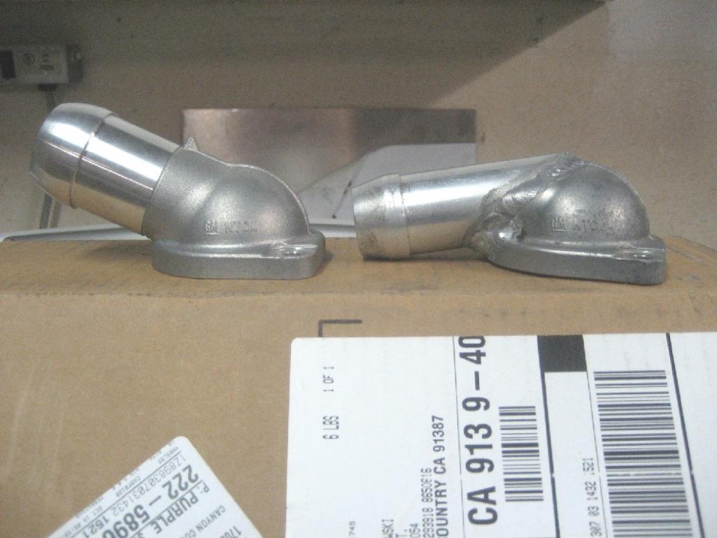

andys   As the cooling system is a crucial part of a V8 co...   Mar 13 2013, 12:16 PM

andys   As promised, here's what I did with the radiat...   Mar 14 2013, 01:47 PM
andys   I found a couple of more photos (with the exit duc...   Mar 14 2013, 04:44 PM

andys   I stubled across a couple more coolant pipe photos...   Mar 16 2013, 09:37 PM
