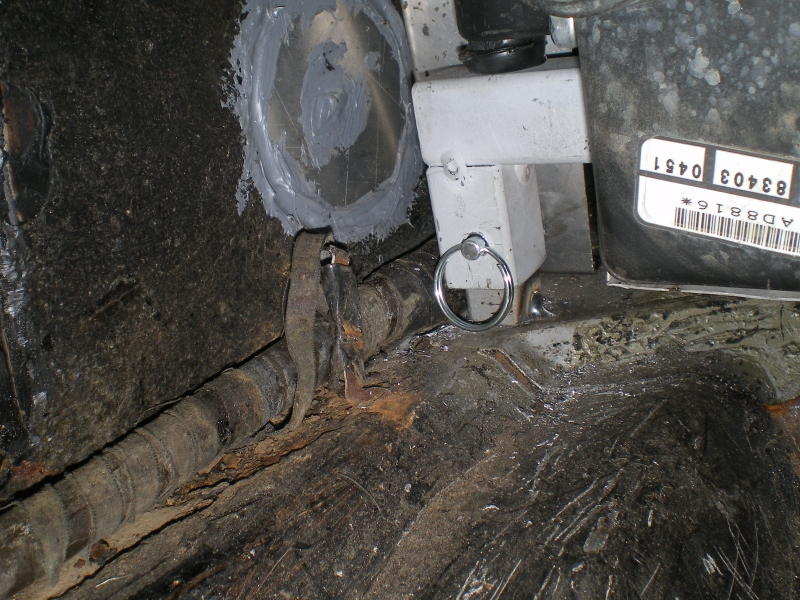

What's it been? A year since I got Blackie running. I finally get it tuned to a daily driver status and should have been happy as a Lark then but what do I do? I sold the engine (w/90 hour's on the Hobbs) on the last Dawn Patrol GMR run. So I pulled the engine and began preparing Blackie for her transformation.
Before I go any further check out my Jack Stands. Min height 19.5", 12 ton and should hold up to a 6.7 quake or direct nuclear attack.
And out she comes.
One thing you have to love about these cars is that you can remove an interior in 15 minutes. 30 min's if you have a console. This was one shot before the interior is gutted.
and an hour later I'm scraping tar floorboards.

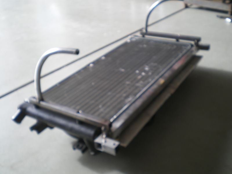

I'm glad this part is behind me. I had that thing in and out 50 times. Anywho, this is what I came up with. Let me clarify I; Bigcat suggested the radiator and fan set up. I just put em together. It's an Intrepid fan/s unit and Sirocco radiator. The fan set up is defective and was used as a mock up while a new one is shipped. The 2 are < $150 combined with shipping.
Here is the radiator/fan in it's removable frame.

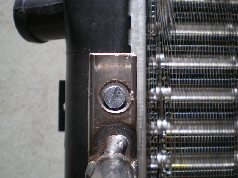

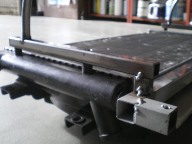

A look at the radiator to frame attach point. There are two per side. and yes those are cheese head screws.

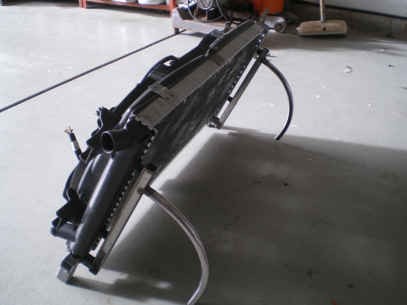

A side view of the same shot. That is a faucet washer compressed between the rad post and the frame.

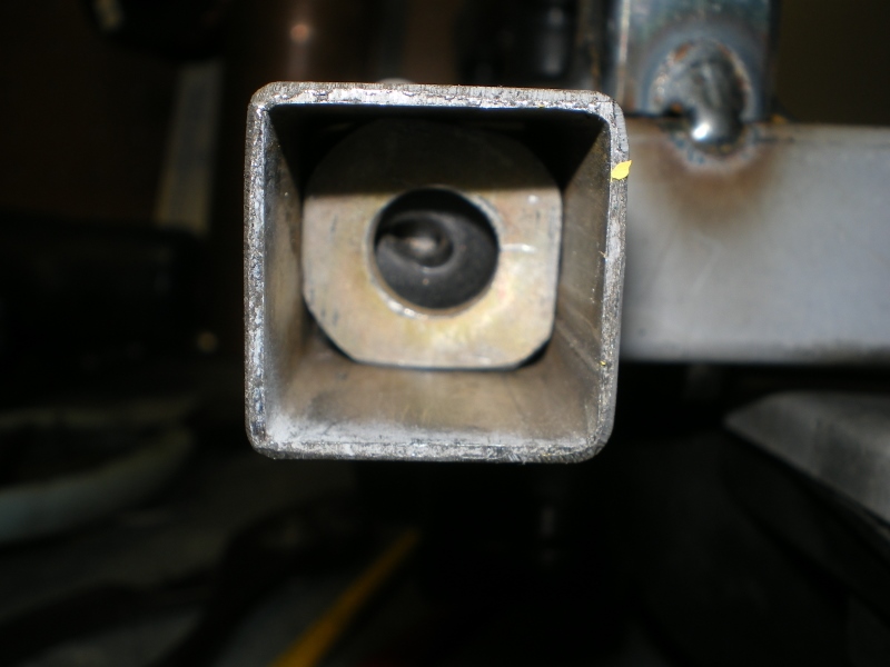

The square 1" legs of the frame will sit over these posts

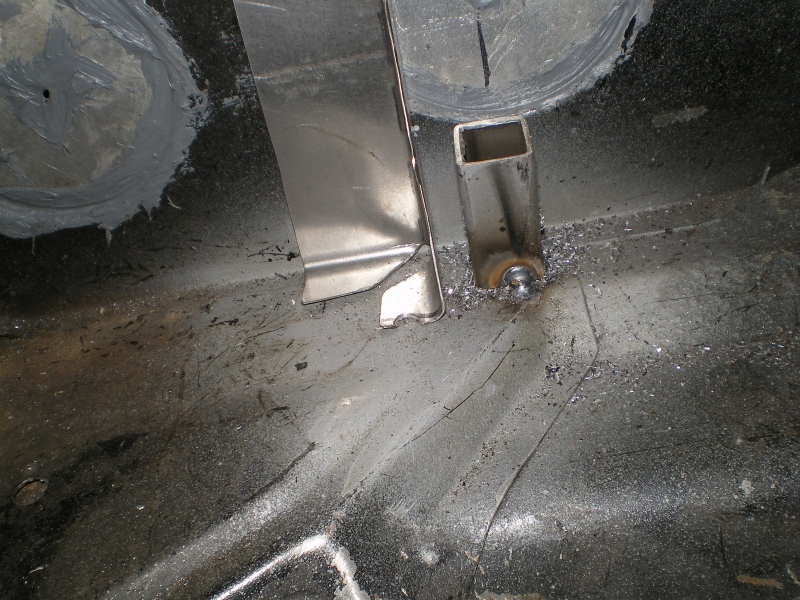

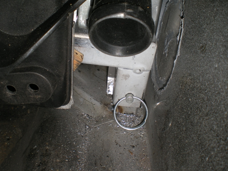

And the smaller round legs will sit atop these

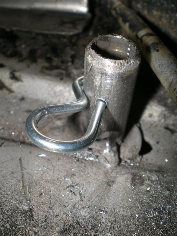

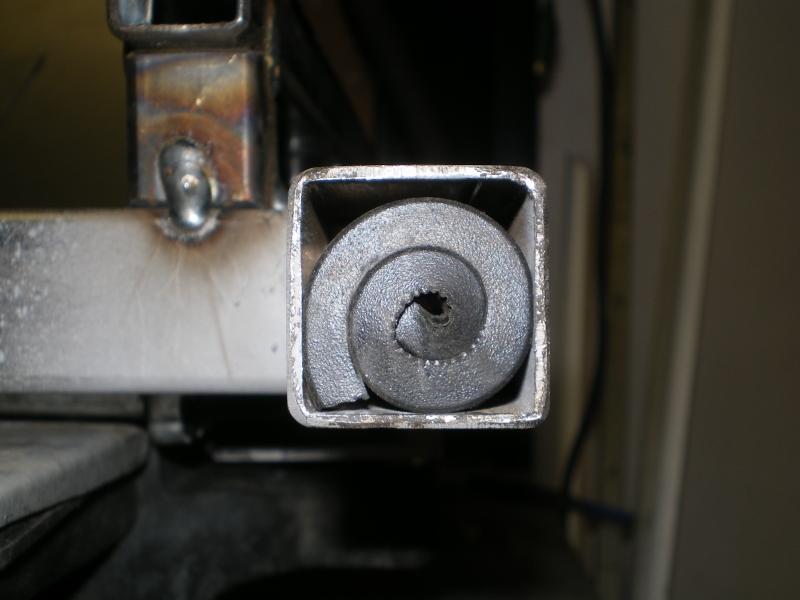

The square receiver end gets a rubber cushion
With this slightly massage washer to protect the rubber from wearing against the post.

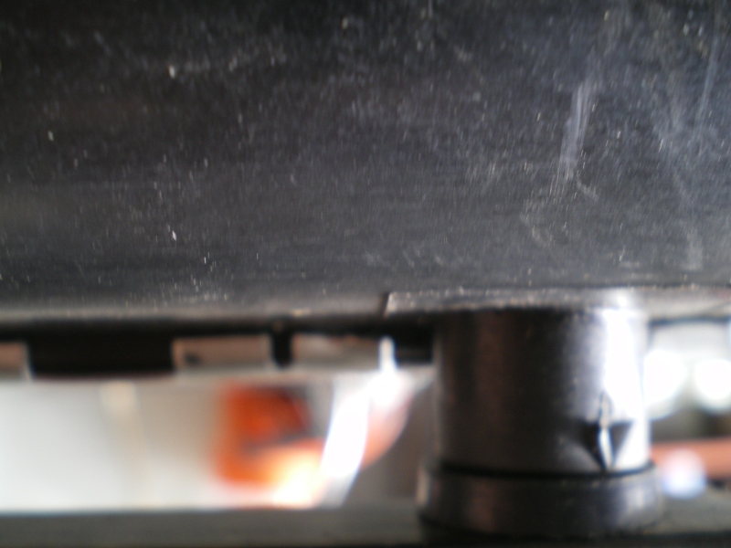

Then the unit is set and held in place by these hitch pins. For future access I will be able to remove all the radiator, shroud, etc. < 10 min's. (IMG:style_emoticons/default/biggrin.gif)

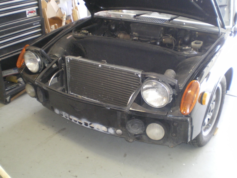

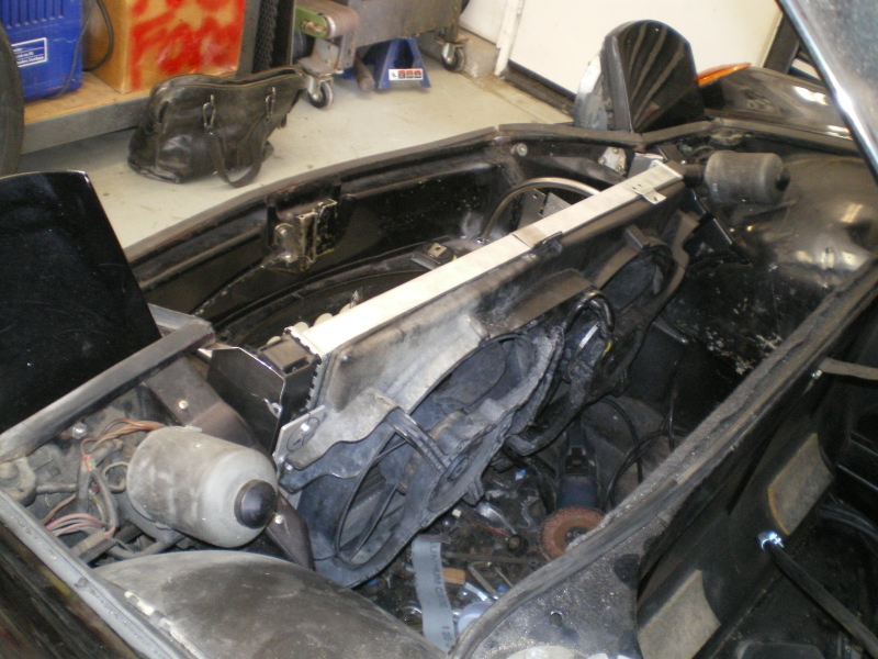

And in place
