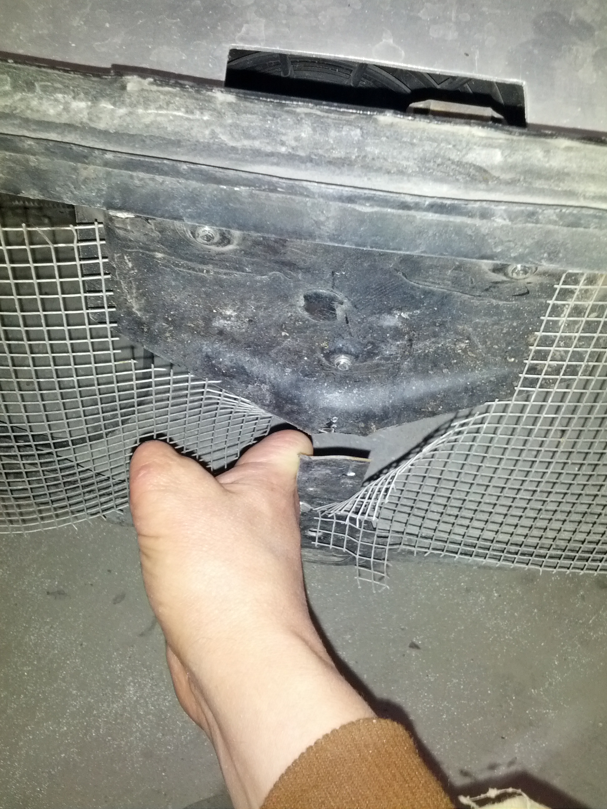

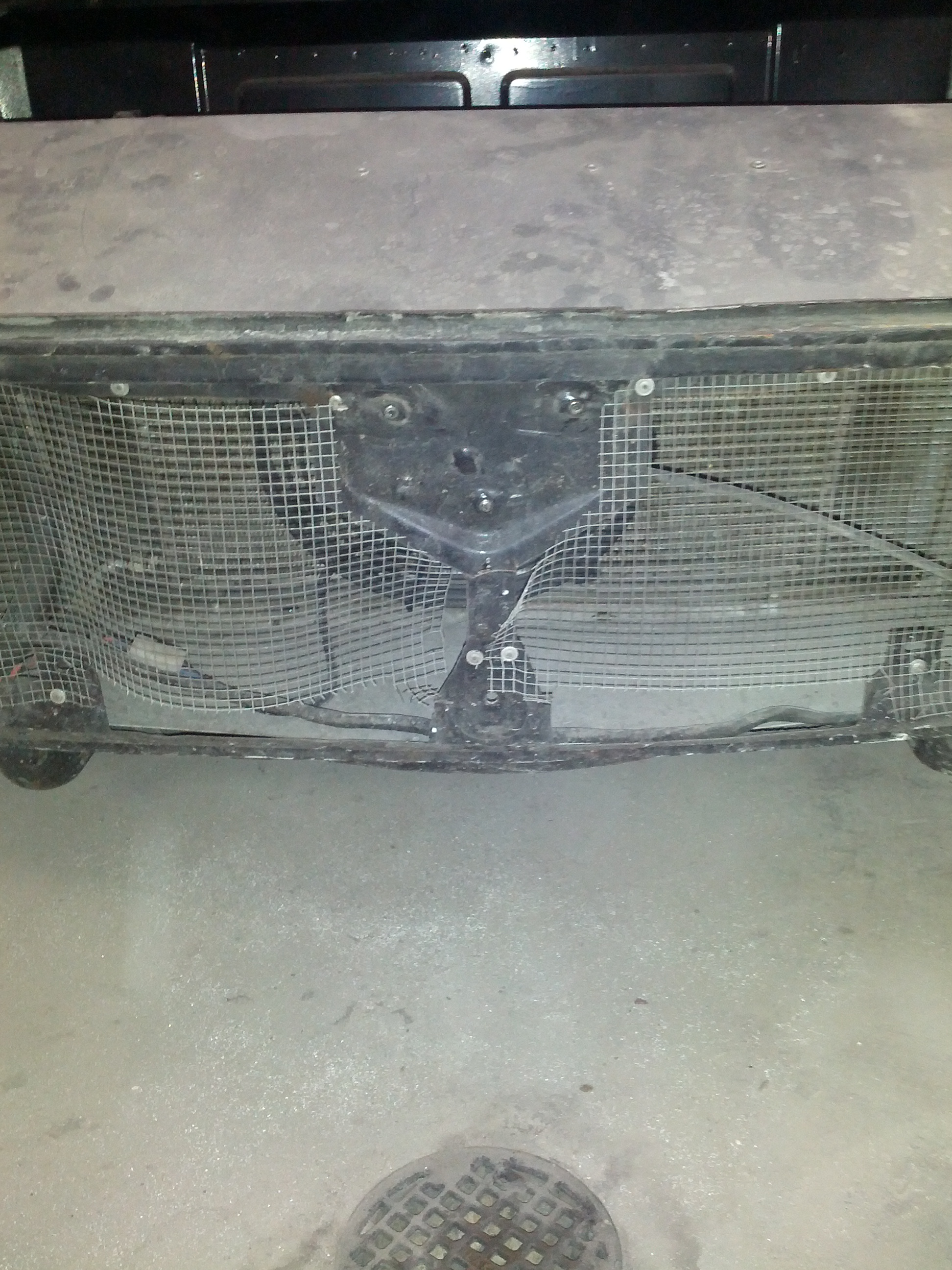

Here are some better pictures of the problem with the hood latch & cutouts.
Here you can see how PO really only left the bare minimum or metal behind the bumper.
And, as it turned out, less than the bare minimum, since it cracked right across and left the hood latch without any support in 2 of 3 directions.
Steve is going to come up with something to replace the strength without closing down the air flow any more than necessary.
(BTW, we are planning to come up with something a little nicer than chicken wire when we put her back together)
