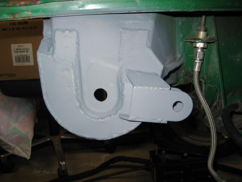

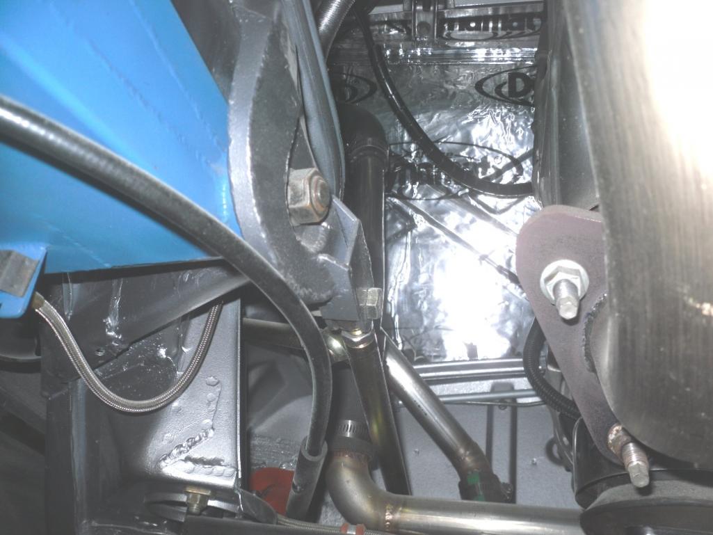

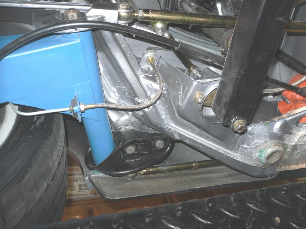

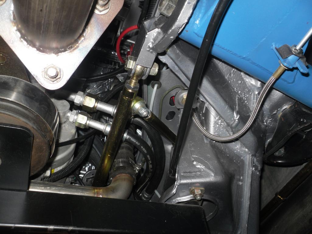

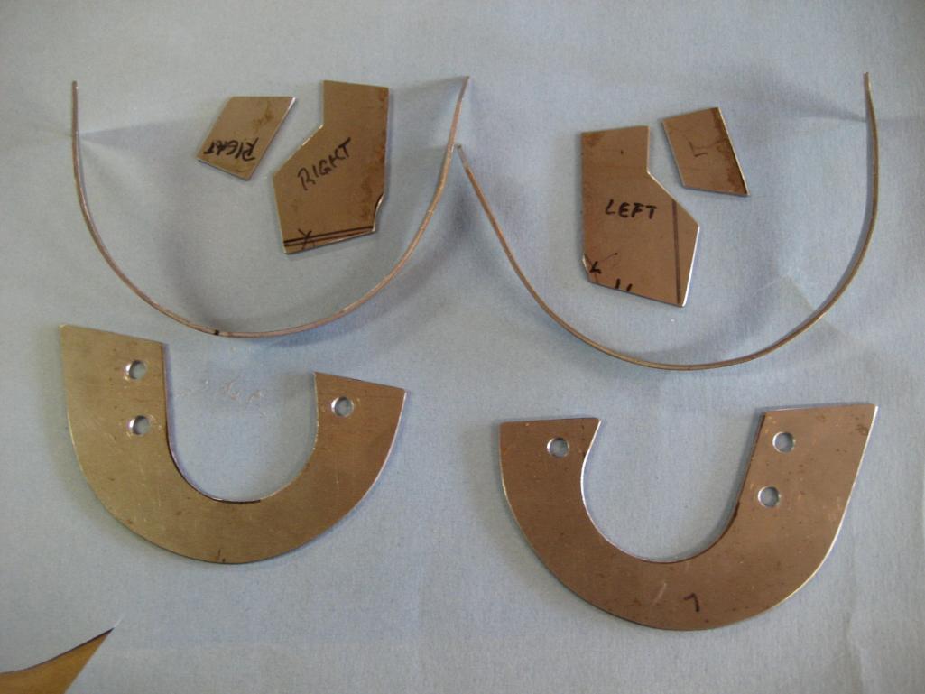

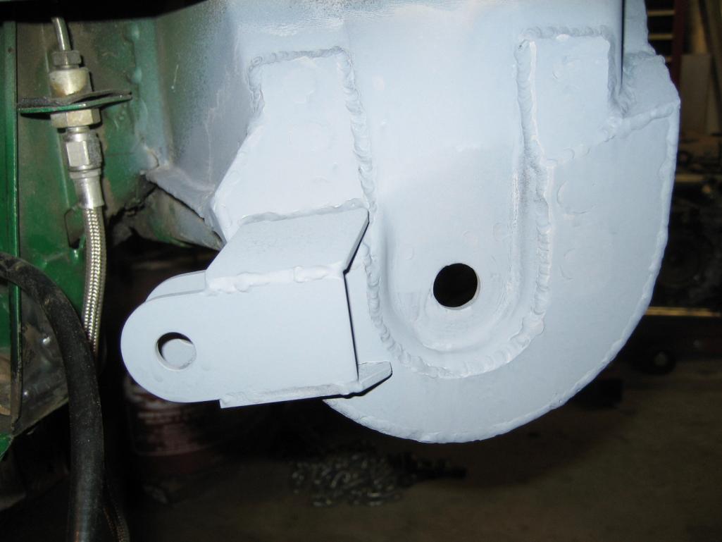

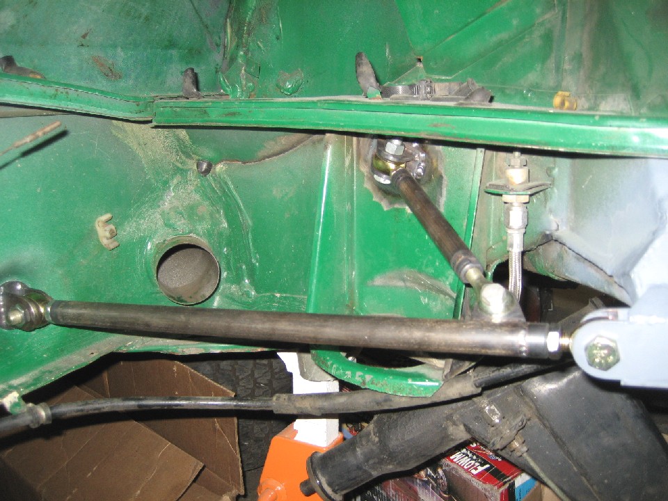

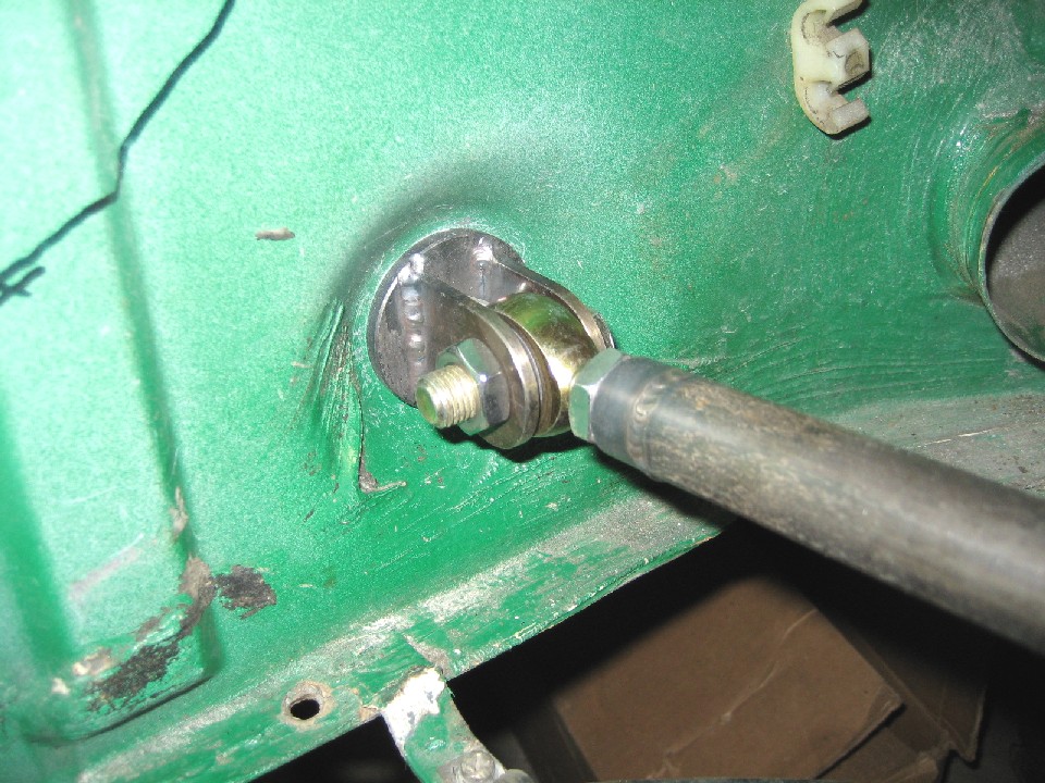

I re-enforced the inner suspension ears with a sort of scab plate and boxed combo along with the traditional link to the firewall. I made cardboard templates for the scab plates, cut out some sheet metal, and TIG welded those into place. As with most inner ears, the hole for the pivot shaft usually gets worn out-of-round, so I made sure to add some weld bead and ream the holes true.
I added some double shear pickup points to mount some removable re-enforcement links. What I decided on, was to make a compound link that has two legs; one goes straight forward to the firewall, and the other angles upward and anchors to just above the motor mount structure. Some heims and threaeded clevis', and it's done......oh, and zinc plated. I don't have any real clear shots of the final installation, but I threw in a few where hopefully you casn pick out the re-enforcement scheme.
Attached Image Attached Image Attached Image Attached Image Attached Image Attached Image
