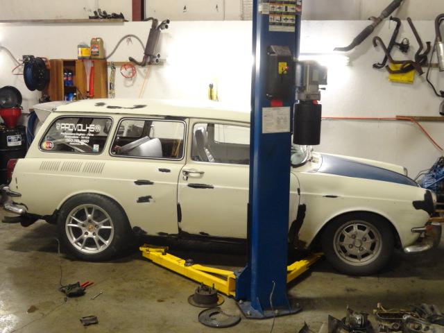

I've had a long term project going now to turn my '67 Squareback into my shop car. While I love driving my 914, it has limitations as a daily parts hauler. I love old styling with new technology and updates, so my goal is to turn my humble Square into the wagon that Porsche never made. I want it to drive and handle more like a Porsche than a VW wagon and it's got to be a true "Sleeper" (not a real problem; since it's a wagon). (IMG:style_emoticons/default/shades.gif)
(IMG:http://www.914world.com/bbs2/uploads_offsite/images.thesamba.com-9730-1324689630.1.jpg)
(IMG:http://www.914world.com/bbs2/uploads_offsite/images.thesamba.com-9730-1324689631.2.jpg)
This has been a 4-5 phase project.
Phase-1 - Convert it to Porsche 914 2.0L motor. Make it physically adapted to the car and running MS2 w/ Ford EDIS ignition. Get it tuned to be a daily driver. DONE!!
(IMG:http://www.914world.com/bbs2/uploads_offsite/images.thesamba.com-9730-1324689631.3.jpg)
Phase-2 - Make the motor look good and freshen it up with new P&Cs. The heads were freshened only about 2K miles before I got it, by me when it was in a clients 914 that he converted to Subie power. I noticed that once I had a few miles on it myself, it was using a bit of oil. So I upgraded to a new set of 96mm P&Cs. So now it's a 2056.
I had my local powder coater do all the tins in black and the plenum and runners in grey for a stock look. I'm running T-4 H/Es with a modified bus header and a Summit Racing Flow Master clone muffler. So I had those ceramic coated in black so they are not attention grabbers from the back. This car is a sleeper (IMG:style_emoticons/default/happy11.gif)
DONE!!
Phase-3 - Convert the rear suspension to the later style IRS and install a Porsche 923 trans out of a Porsche 912E. The rear suspension is DONE!! While at it, I upgraded it with 914 rear brakes, urethane bushings, adjustable spring plates and a rear sway bar. (IMG:style_emoticons/default/driving.gif)
(IMG:http://www.914world.com/bbs2/uploads_offsite/images.thesamba.com-9730-1324689632.4.jpg)
Since the trans is taller than a stock 4-speed and cutting into the car can't happen due to rear seat issues. I gained the 1.5" I needed by spacing the body off the rear suspension with spacers. So here I sit, on the final leg of phase-3. I now need to couple the motor/trans and lift it into it's final place and fab rear engine hanger mounts for the rear bar. It's late and I'm tired. . .
Phase-4 - Front suspension upgrade. Currently in-work
Phase-5 - Paint so it doesn't look so crappy, though it does add to the "sleeper" persona. . .
Stay tuned for more later. . .

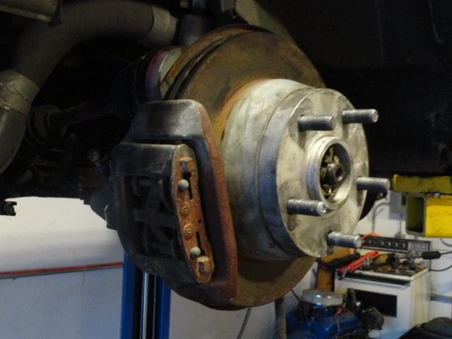

Brakes: I recently scored a complete rear-end off a Porsche 924 turbo so i could switch to Porsche wheels and brakes the right way. Since I already had IRS rear-end under it, I just swapped out the backing plates and the hub assembly. At this time I didn't swap the stub axle since I the stub is identical other than the CV required. Since I already had that sorted out, I figured, why bother at this time??
New brakes mocked-up:
(IMG:http://www.914world.com/bbs2/uploads_offsite/images.thesamba.com-9730-1362459160.1.jpg)

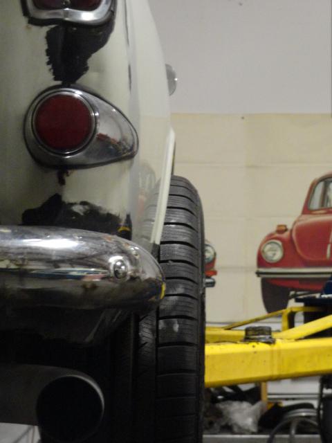

Mocked-up with 17"x8" 40ET Porsche wheels w/ 235-50-17 wheels w/ the 23mm factory spacers:
(IMG:http://www.914world.com/bbs2/uploads_offsite/images.thesamba.com-9730-1362459160.2.jpg)

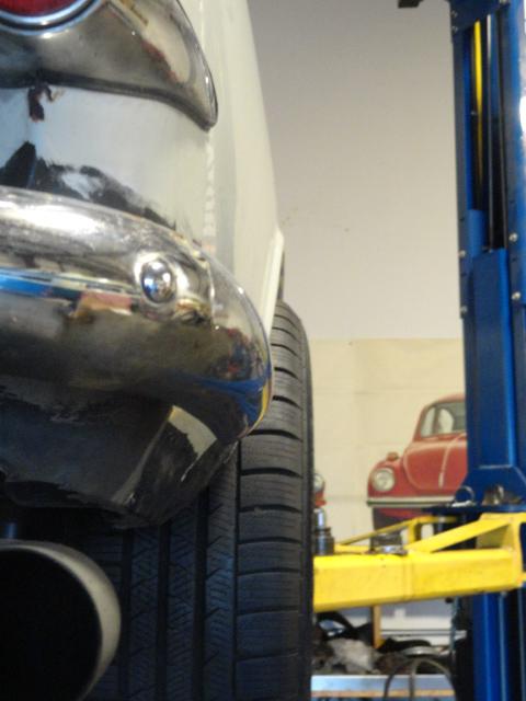

Mocked-up with 17"x8" 40ET Porsche wheels w/ 235-50-17 wheels w/o spacers:
(IMG:http://www.914world.com/bbs2/uploads_offsite/images.thesamba.com-9730-1362459161.3.jpg)

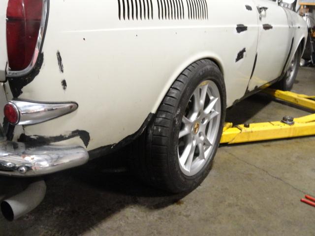

On the ground (yeah, it's on the fenders):
(IMG:http://www.914world.com/bbs2/uploads_offsite/images.thesamba.com-9730-1362459161.4.jpg)
A glimpse of the old and new:
(IMG:http://www.914world.com/bbs2/uploads_offsite/images.thesamba.com-9730-1362459162.5.jpg)
I'm gonna have to stretch the rear fenders about 2.5" - 3" in order to get everything to fit. I'm going to be doing all the body work with these over-sized tires AND the factory spacers so that there's plenty of clearance ion the inner side (which was tight without the spacers). When completed, I plan to run slightly smaller tires on these rims, but also this will allow me to run 17'/18" BBS LM wheels if they should ever present themselves for a good price. 8)
