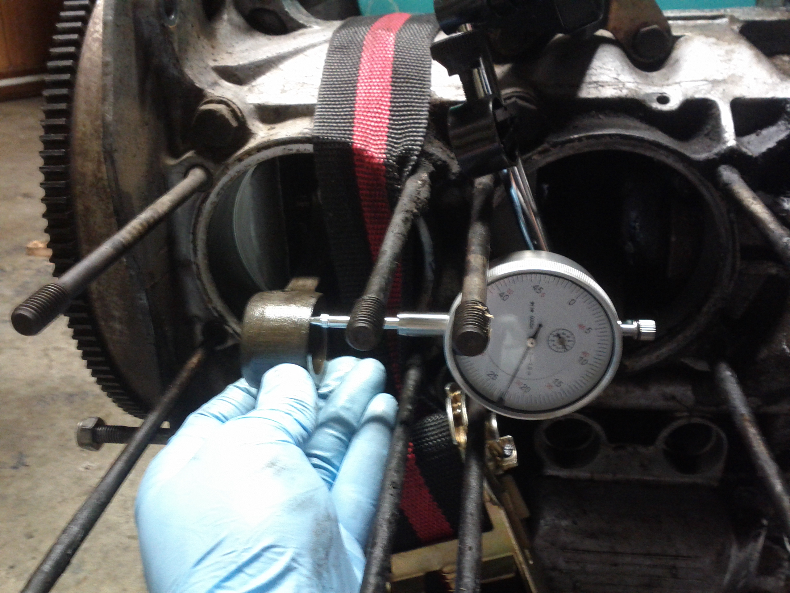

So I'm waiting for an engine yoke to show up before I crack the case and I'm getting anxious to get some work done.
I felt some side to side play at the end of the connecting rods (in the axis of the crankshaft) so I set up the dial gauge and started measuring.
Cyl Maximum play:
1 0.061"
2 0.0535"
3 0.057"
4 0.0545"
I don't think this is a normal measurement to take but do these seem too loose?

euro911   Is it a wobble, or just side to side play? What r...   Mar 6 2013, 12:46 AM
AE354803   Is it a wobble, or just side to side play? What ...   Mar 6 2013, 10:47 AM
Vacca Rabite   There is a gap between the bushings and the crank....   Mar 6 2013, 09:56 AM
euro911   A 'deep clunk' is usually indicative of a ...   Mar 6 2013, 11:30 AM
