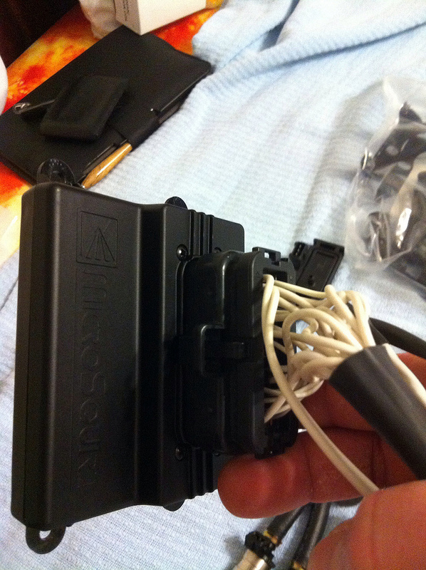

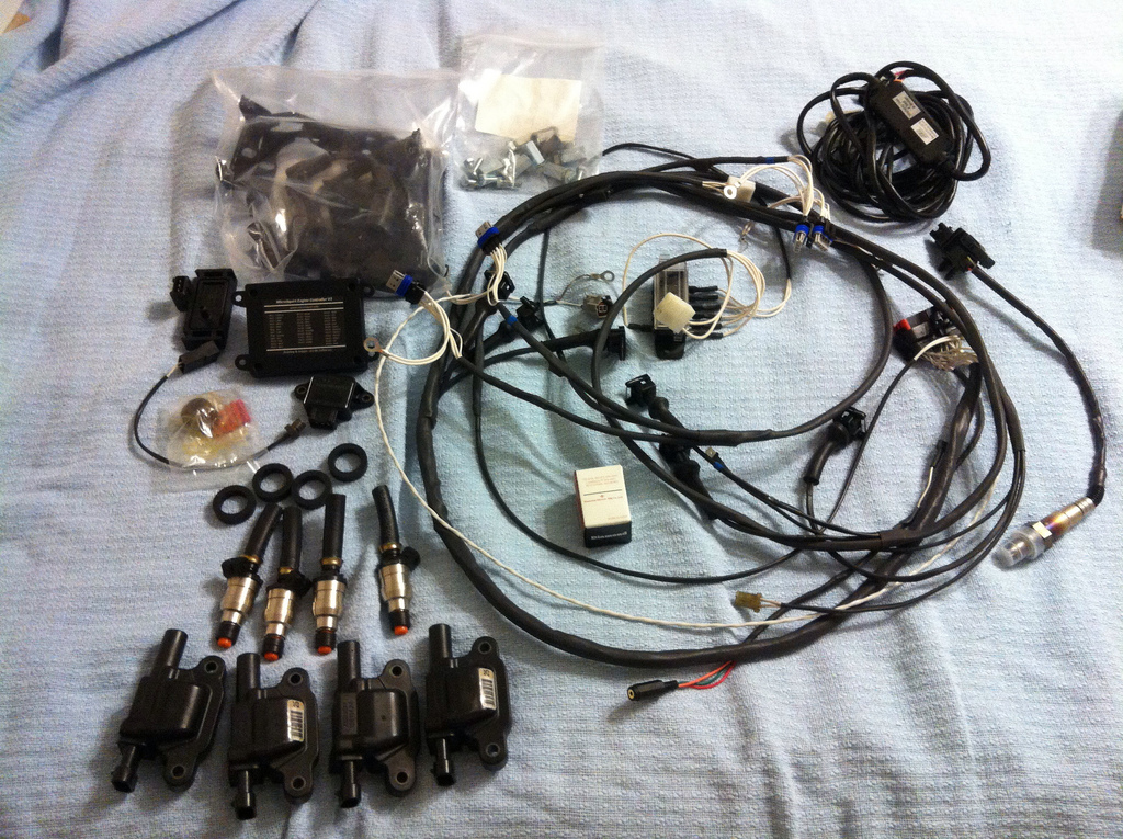

I got more stuff today!!!
Original Customs 100% eFI kit. Let McMark take the engineering out of your eFI project.
(IMG:http://www.914world.com/bbs2/uploads_offsite/farm9.staticflickr.com-1435-1362710932.1.jpg)

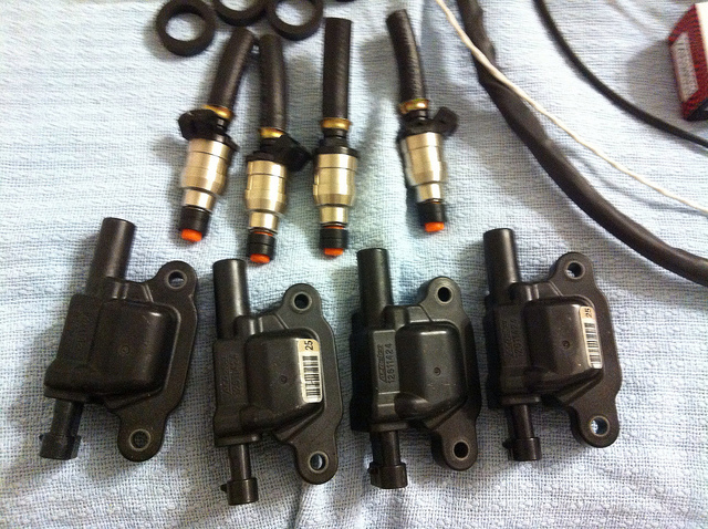

New fuel injectors? Coil on Plug? Hell yeah!
(IMG:http://www.914world.com/bbs2/uploads_offsite/farm9.staticflickr.com-1435-1362710933.2.jpg)

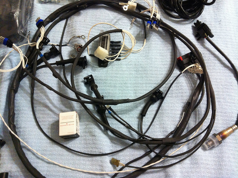

Prebuilt wire harness? Yup.
(IMG:http://www.914world.com/bbs2/uploads_offsite/farm9.staticflickr.com-1435-1362710933.3.jpg)

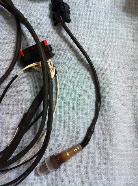

O2 sensor included? You better believe it.
(IMG:http://www.914world.com/bbs2/uploads_offsite/farm9.staticflickr.com-1435-1362710933.4.jpg)
Weathertight Microsquirt controller? Included. Can you say mounted in the engine compartment with no worries? Yes you can.

There are a couple things that I am missing yet, but I can start taking chuncks out of this job for real now.
