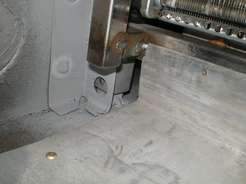

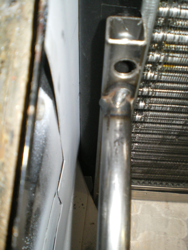

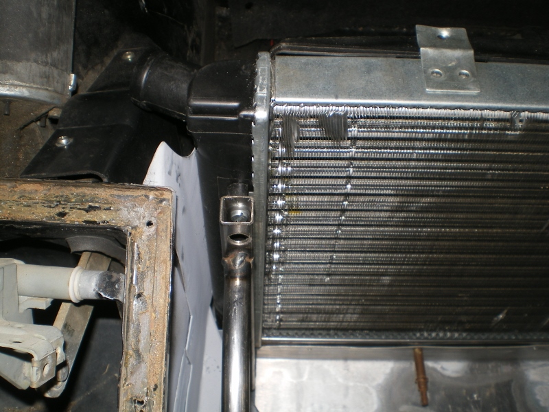

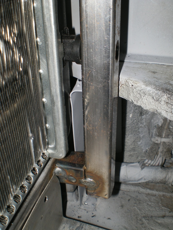

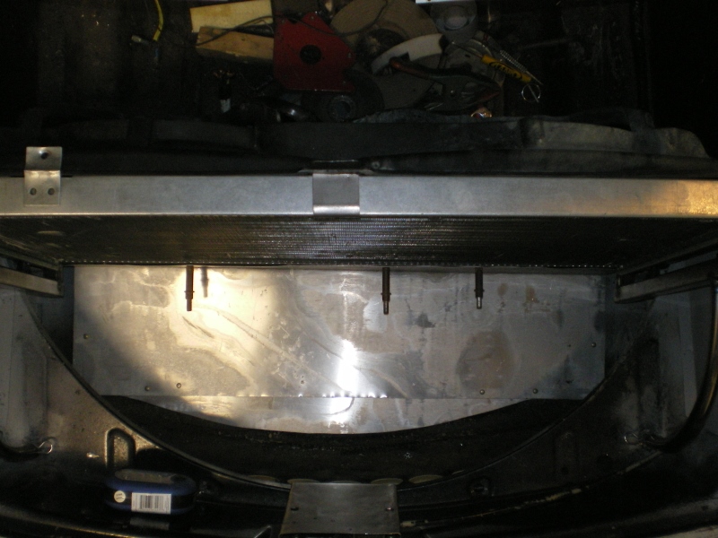

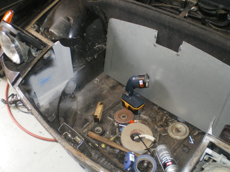

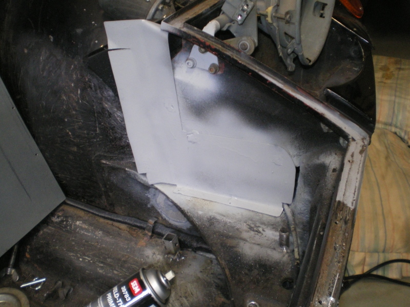

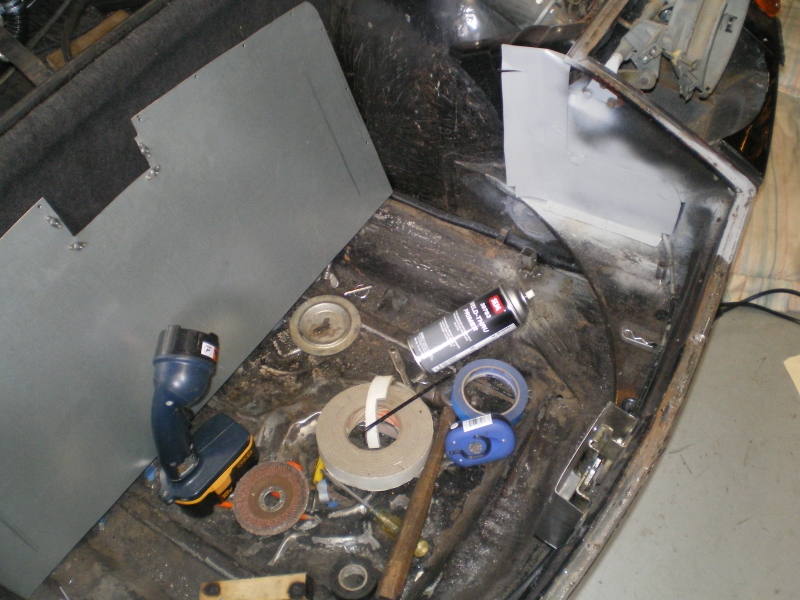

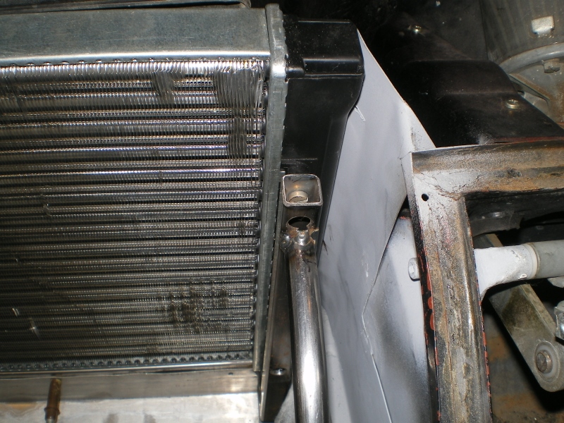

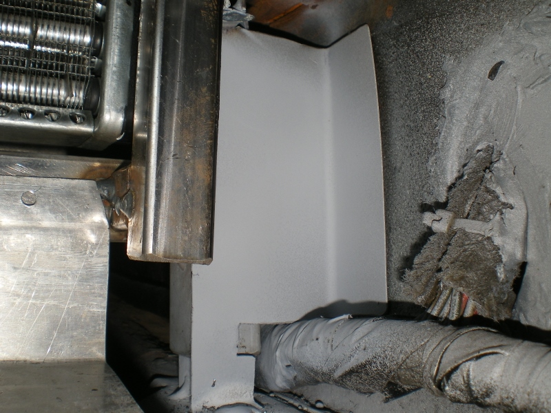

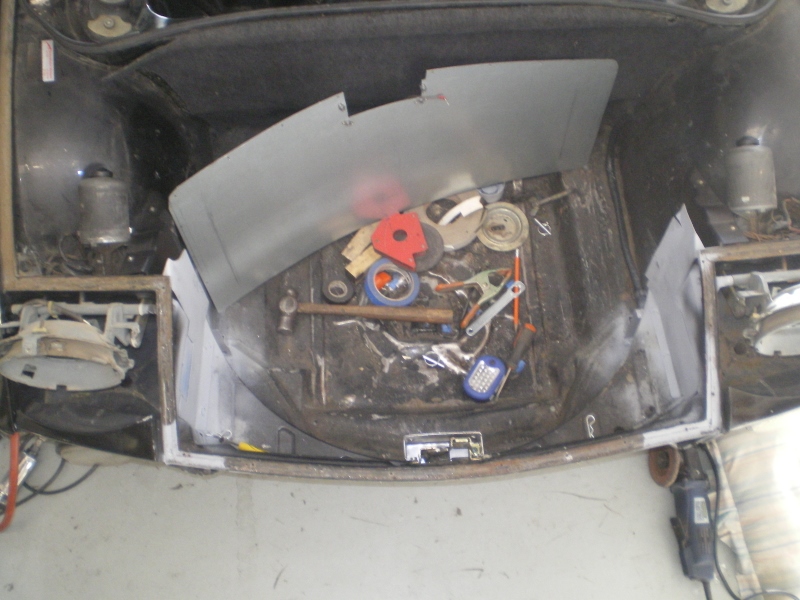

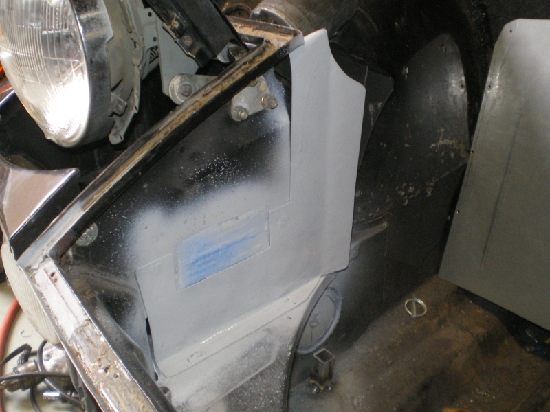

Hey thanks, Chris. How's your's coming along? I was busy as Hell last week, didn't get (IMG:style_emoticons/default/stromberg.gif) done so I ended up on page 3. (IMG:style_emoticons/default/lol-2.gif) Got to hit it again yesterday so I did a final fit then welded in the side pieces that should mostly seal the gaps between the radiator and sides. There will be strips of felt or Armorflex between the metal and plastic radiator, eventually.
This piece will need to be massaged against the wall and then all seams and gaps get sealed with Wurth's at metal to metal junctions.
Then the bottom piece which was done with aluminum for obvious reasons.
