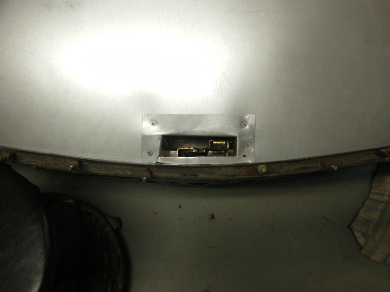

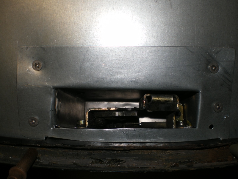

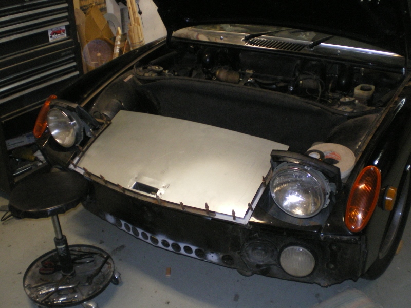

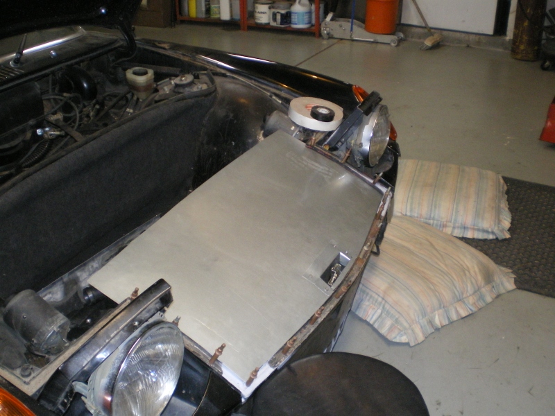

The top/cover piece slides beneath the rain channel. This piece will be pop riveted in place to facilitate easy removal. Plate nuts, rivenuts or any other kind of nut would not work as the piece slides against the bottom of the channel and anything placed there would obstruct the travel of the cover piece. I'll use blind rivets which will not allow water thru like an ordinary pop rivet would. They're only pennies each and drill out in < 5 seconds each.
I was determined to keep the hood OG (sans Hood pins) so this is how I went about it. These screws will be replaced with black allen head cap screws.
