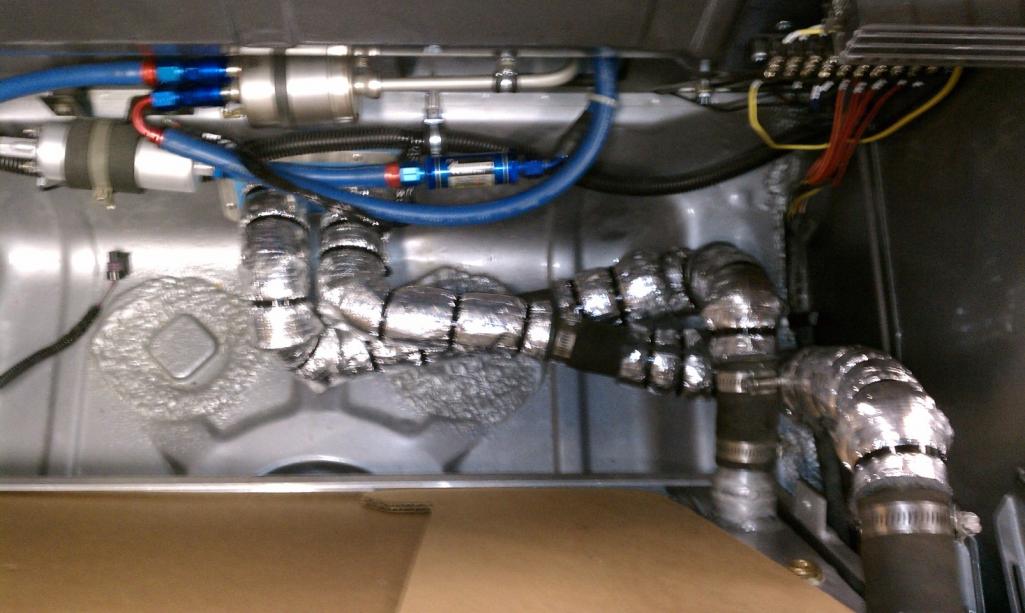

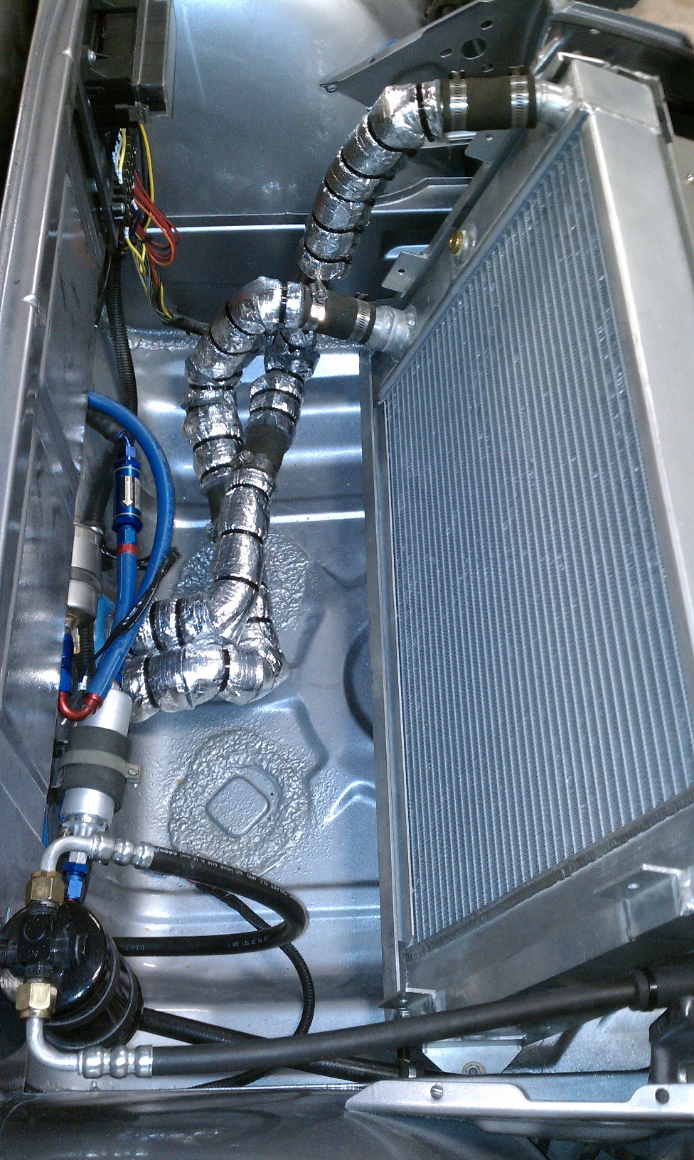

I found a couple of more photos (with the exit ducting removed) of how the piping routed in the front trunk and insulated.
