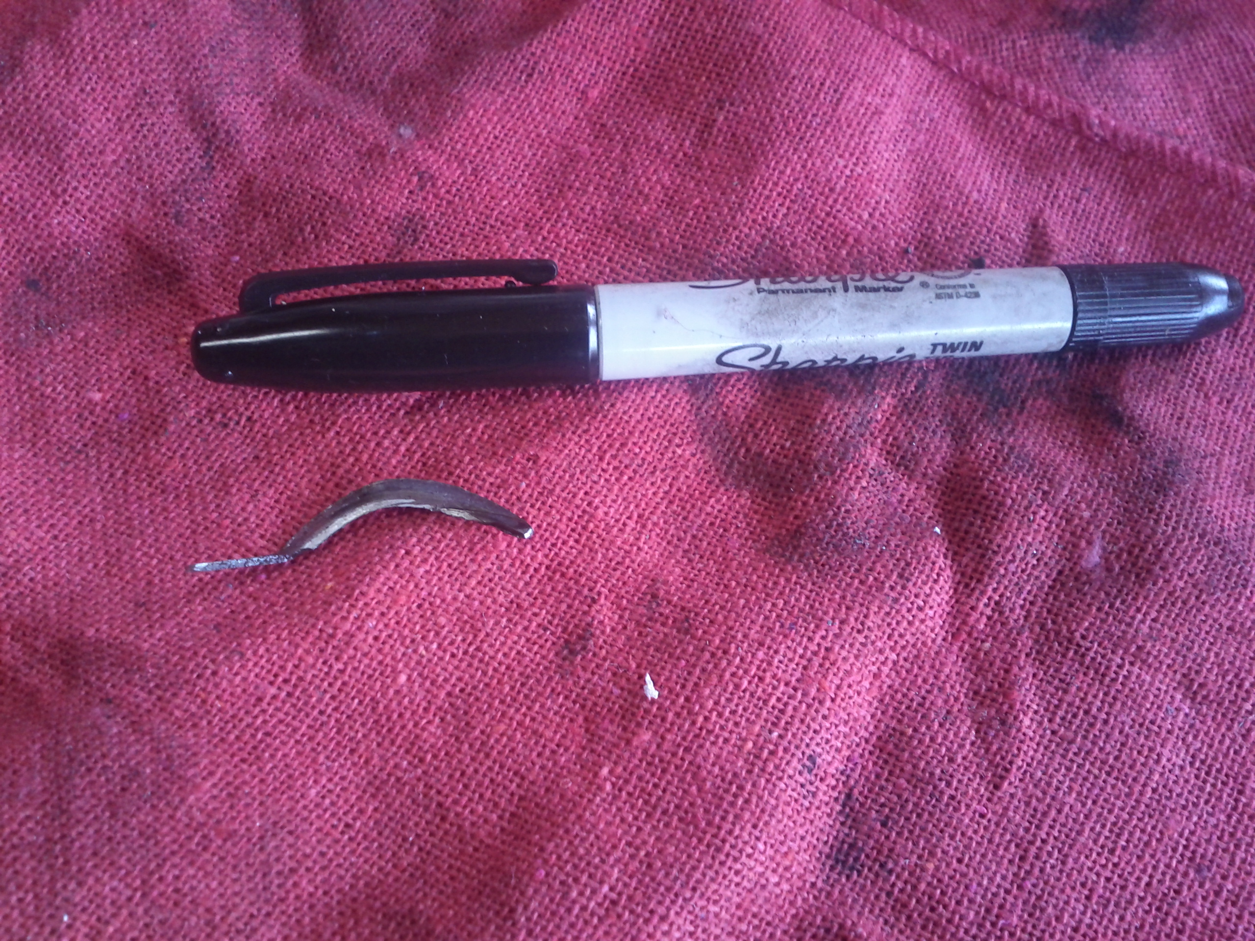

Engine torn down and all case bolts removed. Can't get the case split using just a rubber mallet. Should have bought the damn case splitting tool, oh well, until next weekend.
I found this large piece of metal in the taco plate/inspection port area, hopefully I can find where it came from and it's the reason for the noise.

AE354803   Engine torn down and all case bolts removed. Can...   Mar 16 2013, 05:01 PM

Valy   The cam looks to be aftermarket. The bolts between...   Mar 19 2013, 06:20 PM
Valy   Here is how the cam bolts should look like so they...   Mar 19 2013, 06:25 PM
Vacca Rabite   :agree: Your cam bolts self machined themselves i...   Mar 19 2013, 06:32 PM
AE354803   :agree: Your cam bolts self machined themselves ...   Mar 19 2013, 08:36 PM
Valy   The cam gear angled teeth create an axial pushing ...   Mar 19 2013, 10:19 PM
AE354803   Based on this pictures from Van's 914 engine r...   Mar 19 2013, 11:25 PM
Valy   The bolts don't hit the bearing. I think that ...   Mar 20 2013, 09:59 AM
