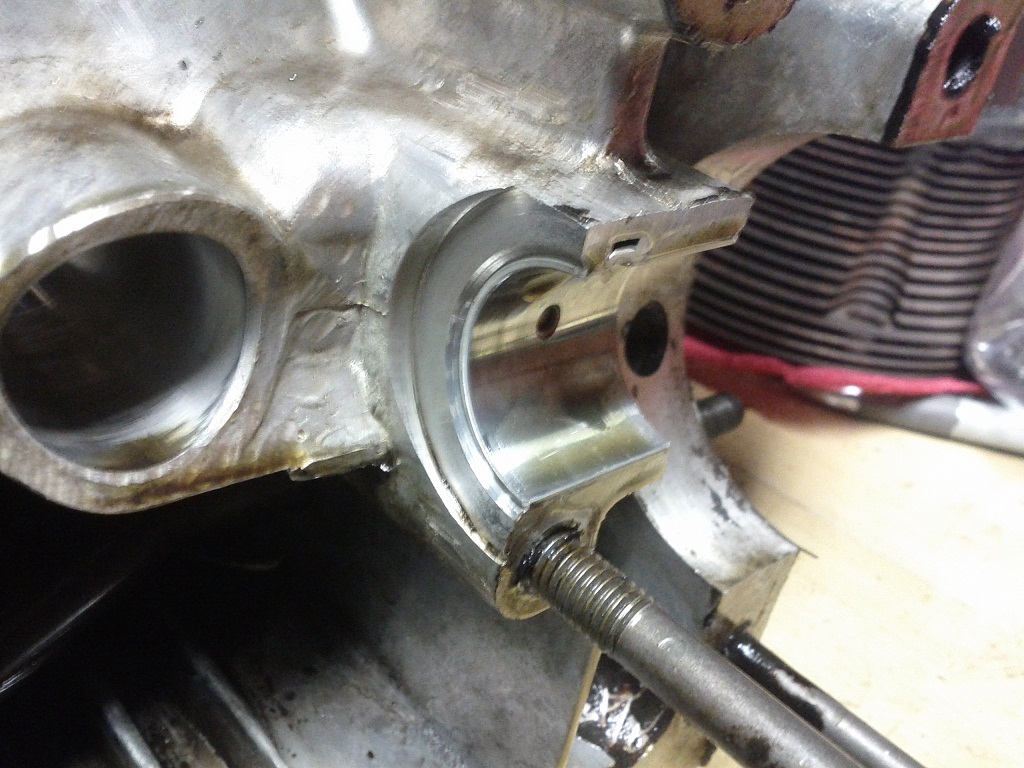

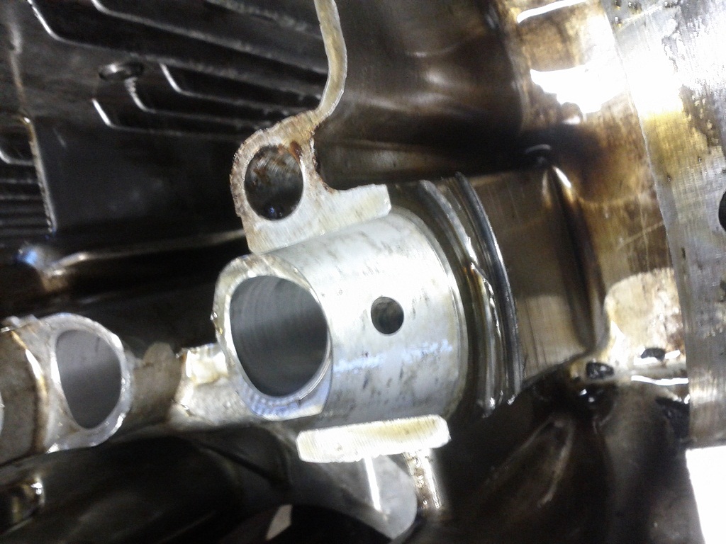

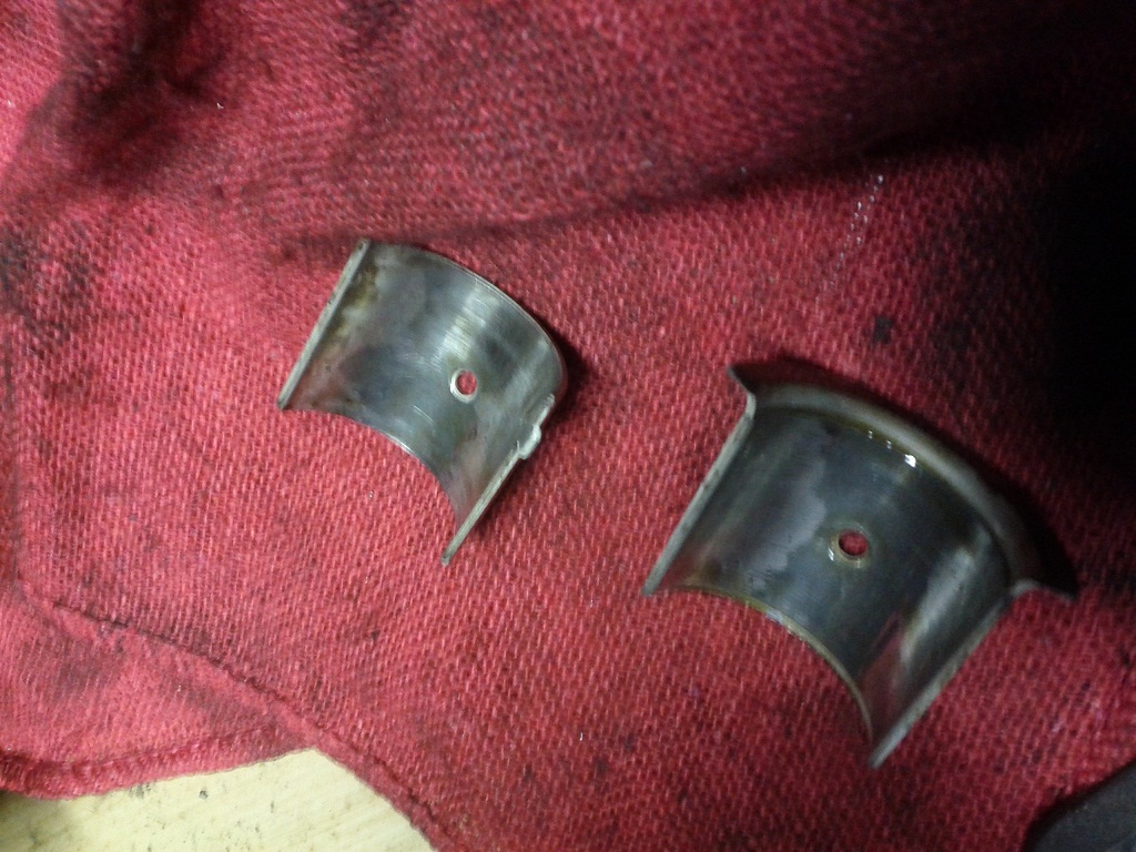

Found an issue (hopefully THE issue). The camshaft bearing on the outboard of the engine (fan side) had the thrust portions of the bearing worn completely off on 3 of 4 sides (see attached picture) The portion of the threads that protrude from the rear of the cam gear had then also cut into the case area surrounding the outboard bearing.
The damage looks like it may be just cosmetic, I'd estimate about 1 mm cut in, luckily it doesn't look like anything too important is in that location. However the inboard side of the outboard bearing has what looks like a small chamfer cut into it now, I'm guessing from after the thrust portion of the bearing was worn away.
My big question is why would this happen? Bad bearing? Maybe installed with camshaft bolts that were too long and had interference to begin with? The missing thrust bearing portion would agree with the cam bolts hitting.
Discovered a few other things also, not as bad,
1. cam is stamped with a VW symbol, so it's not a webcam as the PO stated (probably came with the bus pistons, hooray!) part # 022 1*9 101A (*=8,9,0 hard to read)
2. no oil baffle plate present in the engine
3. None of the bearings appear to be wiped. Didn't get to check the rods yet.
My main questions:
1. Where do I proceed from here? I will definitely get the case inspected but should I be concerned about that missing material (see pictures) and what specifically should I have looked at?
2. How do I determine the cause and keep this from happening again?
3. Are those bolts too far out of the back of the cam gear?
Thanks in advance! Andy

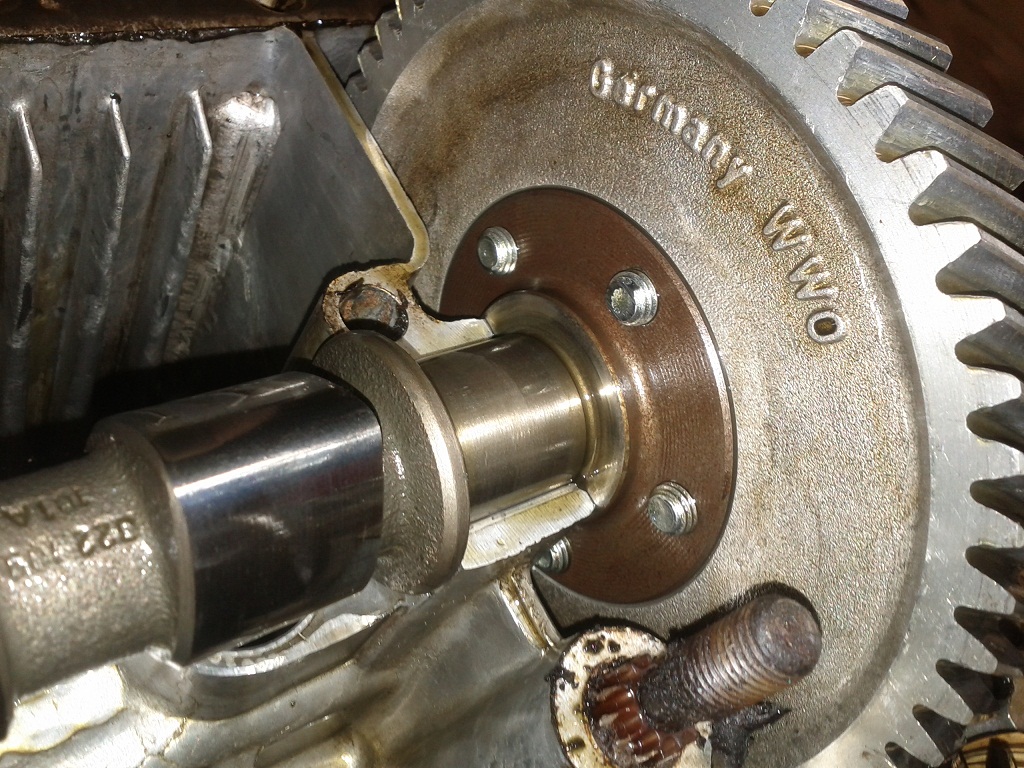

Valy   The cam looks to be aftermarket. The bolts between...   Mar 19 2013, 06:20 PM
Valy   Here is how the cam bolts should look like so they...   Mar 19 2013, 06:25 PM
Vacca Rabite   :agree: Your cam bolts self machined themselves i...   Mar 19 2013, 06:32 PM
AE354803   :agree: Your cam bolts self machined themselves ...   Mar 19 2013, 08:36 PM
Valy   The cam gear angled teeth create an axial pushing ...   Mar 19 2013, 10:19 PM
AE354803   Based on this pictures from Van's 914 engine r...   Mar 19 2013, 11:25 PM
Valy   The bolts don't hit the bearing. I think that ...   Mar 20 2013, 09:59 AM

Vacca Rabite   You shoukd have zero play on the cam drive gear. I...   Mar 22 2013, 06:13 PM
