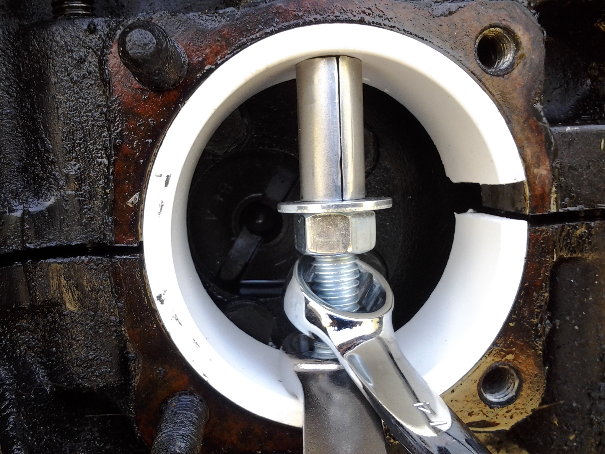

It's a bit late but I made a case splitter out of a PVC pipe connector.

AE354803   I'm measuring the piston-cylinder gap. Spec i...   May 8 2013, 06:43 PM
Valy   All pistons have oval skirts as you measured. The ...   May 8 2013, 07:56 PM
AE354803   The top had the same large gap all the way around,...   May 8 2013, 09:19 PM
AE354803   During platigage fit today, found out the cam thru...   May 11 2013, 06:57 PM
