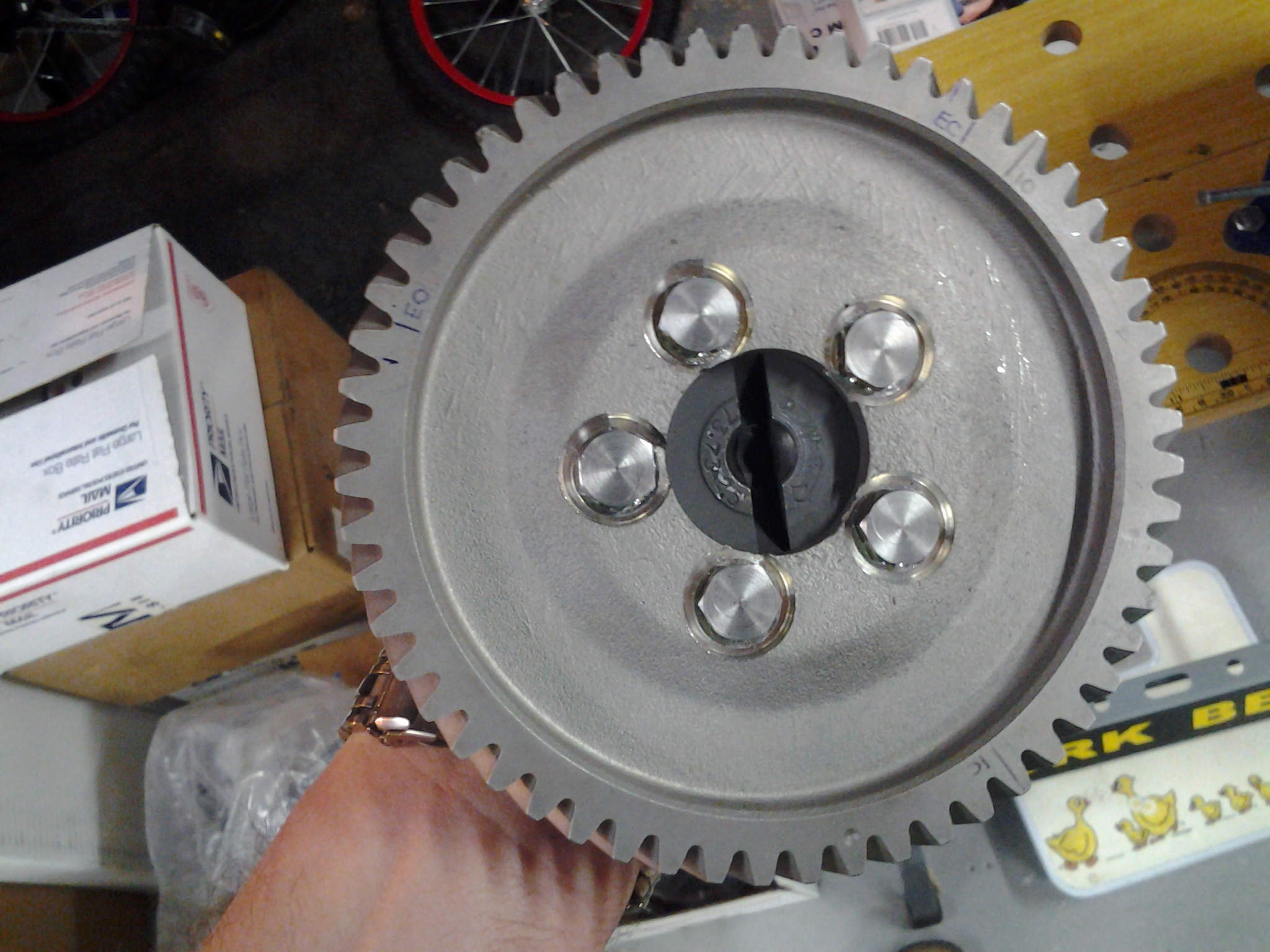

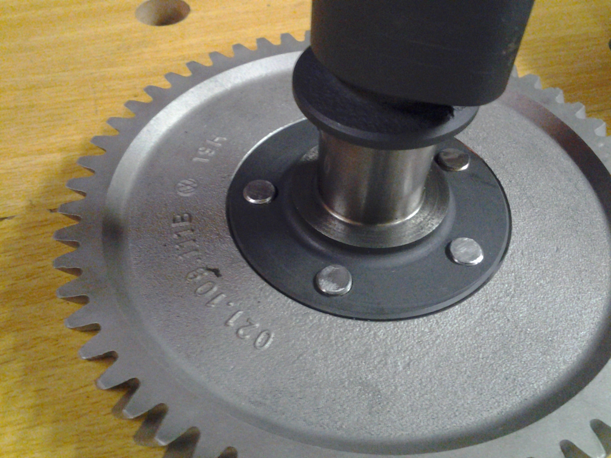

Valy   The cam looks to be aftermarket. The bolts between...   Mar 19 2013, 06:20 PM
Valy   Here is how the cam bolts should look like so they...   Mar 19 2013, 06:25 PM
Vacca Rabite   :agree: Your cam bolts self machined themselves i...   Mar 19 2013, 06:32 PM
AE354803   :agree: Your cam bolts self machined themselves ...   Mar 19 2013, 08:36 PM
Valy   The cam gear angled teeth create an axial pushing ...   Mar 19 2013, 10:19 PM

Cap'n Krusty   If the crankshaft gear were even slightly flawed, ...   Mar 29 2013, 09:44 AM
AE354803   Thanks Cap'n, I'm replacing the cam gear a...   Mar 29 2013, 10:00 AM
