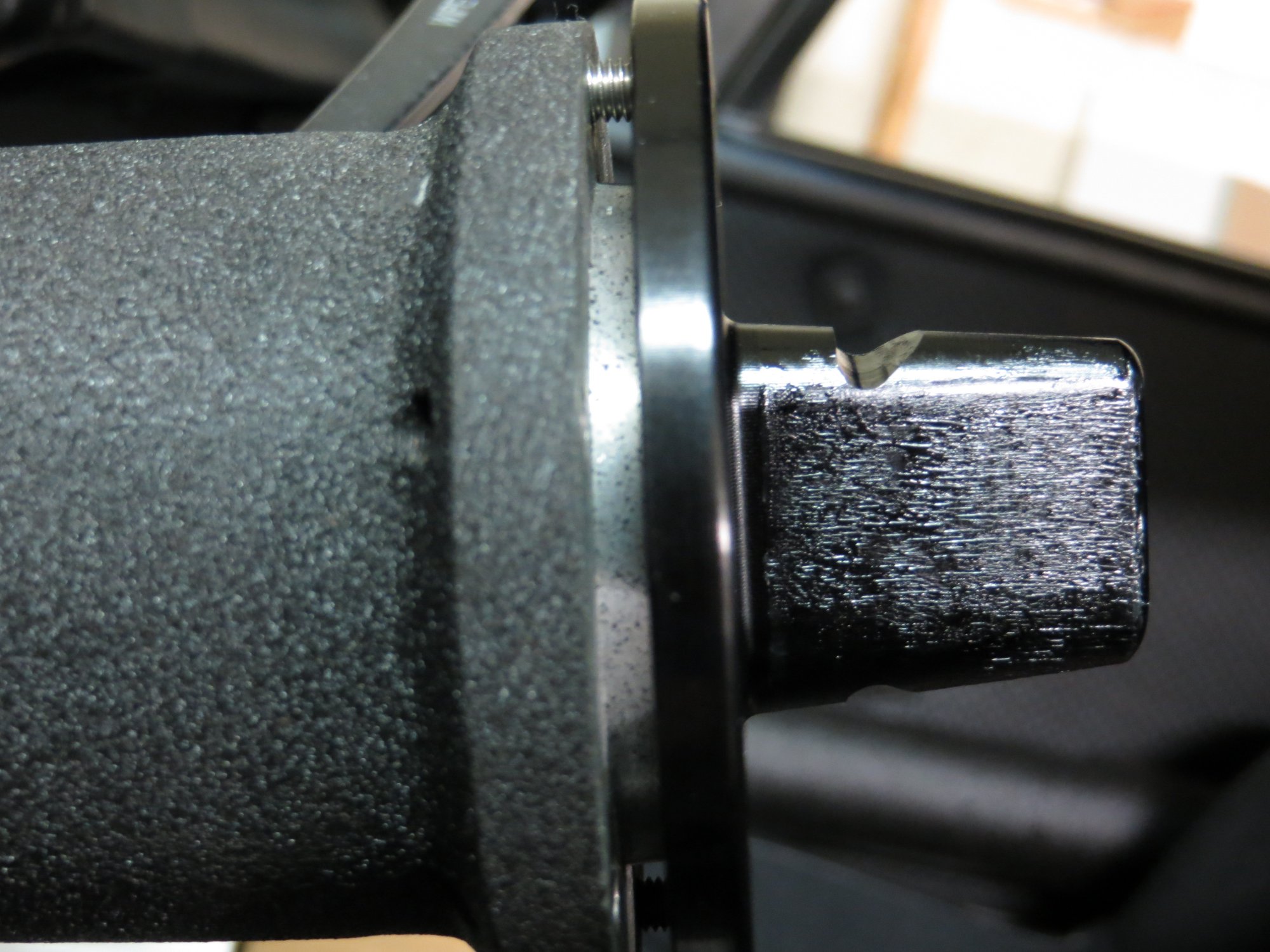

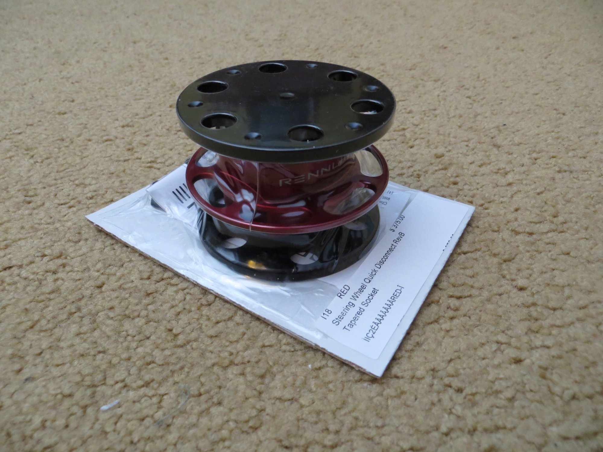

I went with the Rennline which is a really nice piece indeed:

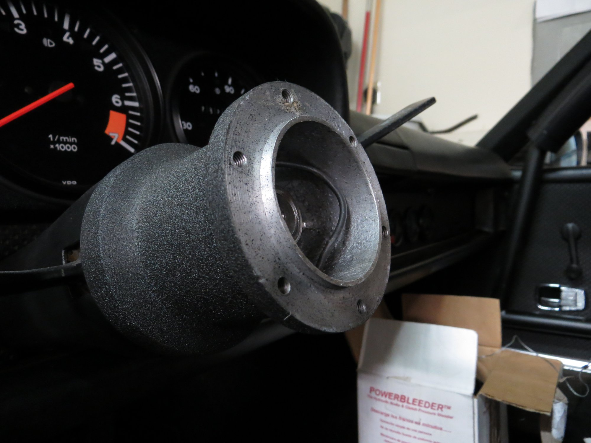

However, my Momo adapter as this "step" in it:
Which means there aren't too many threads holding on:
So looks like I need to machine the step off. Kinda sucks because that step locates the wheel. This adapter is all cast aluminum too, not like the welded steel adapters offered today.
Anyone think the step shouldn't be machined off?

914dave   The wheel doesn't need to be perfectly concent...   Mar 19 2013, 08:31 PM
tomeric914   True, but this QR doesn't have a horn contact ...   Mar 19 2013, 09:44 PM
pcar916   Longer bolts and a spacer(s)?   Mar 20 2013, 05:47 AM
jcd914   Longer bolts and a spacer(s)? :agree: That w...   Mar 20 2013, 06:50 AM

Harpo   :agree: Machine off the lip so they are flush. Th...   Mar 20 2013, 03:23 PM
tomeric914   :agree: Machine off the lip so they are flush. T...   Mar 20 2013, 06:45 PM

tomeric914   I ended up using my right angle die grinder and a ...   Mar 23 2013, 09:29 AM
tomeric914   Here's a view from the side: Installs and r...   Mar 23 2013, 09:32 AM
tomeric914   Dave, this photo is for you. My view may be diffe...   Mar 23 2013, 09:36 AM
