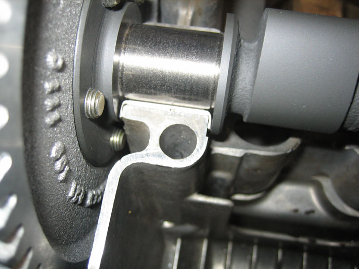

The cam gear angled teeth create an axial pushing force on the cam. I don't remember the direction but I would guess it causes the bolts to grind the case, especially if the thrust surface of that bearing is gone.
The cam turns at half the crank speed so it may be that one longer bolt was making the noise.
I can't estimate the damage from the pictures but you could provide the thrust surface on any side if the case so a double thrust bearing might work.

Based on this pictures from Van's 914 engine rebuild, you can see pretty much what happened to me. My thrust bearing portion was missing from the right hand portion (flywheel direction) of his photo, the cam spins CCW when viewed from the fan side which makes the helical gears force it toward the flywheel end of the case.
I think that the bolts against the case forced the cam toward the fan side which forced the inward mating surface to wear the thrust bearing and then over time the bolts ate away at the aluminum case by oscillating back and forth into it.
(IMG:http://www.914world.com/bbs2/uploads_offsite/www.ephotomotion.com-14801-1363757148.1.jpg)

Valy   The cam looks to be aftermarket. The bolts between...   Mar 19 2013, 06:20 PM
Valy   Here is how the cam bolts should look like so they...   Mar 19 2013, 06:25 PM
Vacca Rabite   :agree: Your cam bolts self machined themselves i...   Mar 19 2013, 06:32 PM

Valy   The cam gear angled teeth create an axial pushing ...   Mar 19 2013, 10:19 PM
AE354803   Based on this pictures from Van's 914 engine r...   Mar 19 2013, 11:25 PM
Valy   The bolts don't hit the bearing. I think that ...   Mar 20 2013, 09:59 AM

AE354803   During platigage fit today, found out the cam thru...   May 11 2013, 06:57 PM
