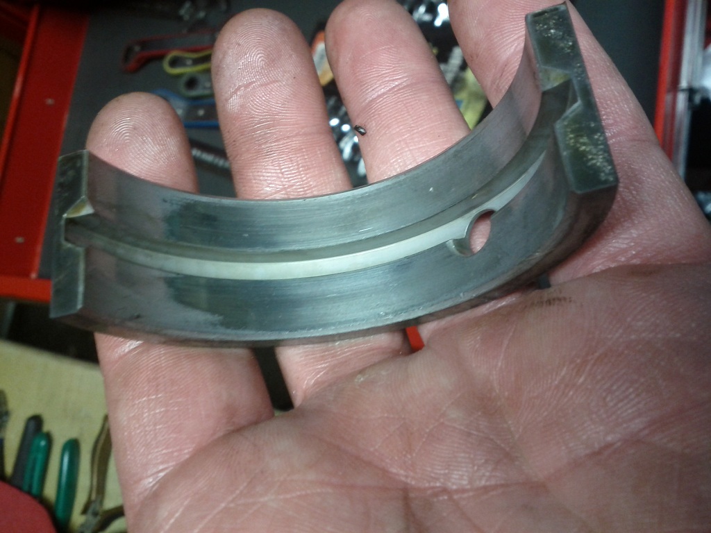

The bolts don't hit the bearing. I think that they shaved the case and that shaving got on and behind the thrust lip causing it to fail. That's the reason you found a full lip detached from the bearing.
I would check for other damage caused by those shavings.

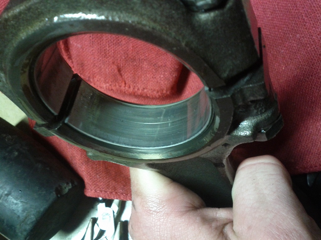

I checked the side play of the rods on the crank, it ranged from 0.009 to 0.011 inches. I didn't have a chance to look up the spec yet but it didn't seem terrible, maybe a little on the high end.
I took the rods out tonight. As Valv stated, I found what looked like damage from small particulate in a few of the bearings. Luckily (or because the shavings were aluminum) it only damaged the bearings. I was planning to replace them anyway.

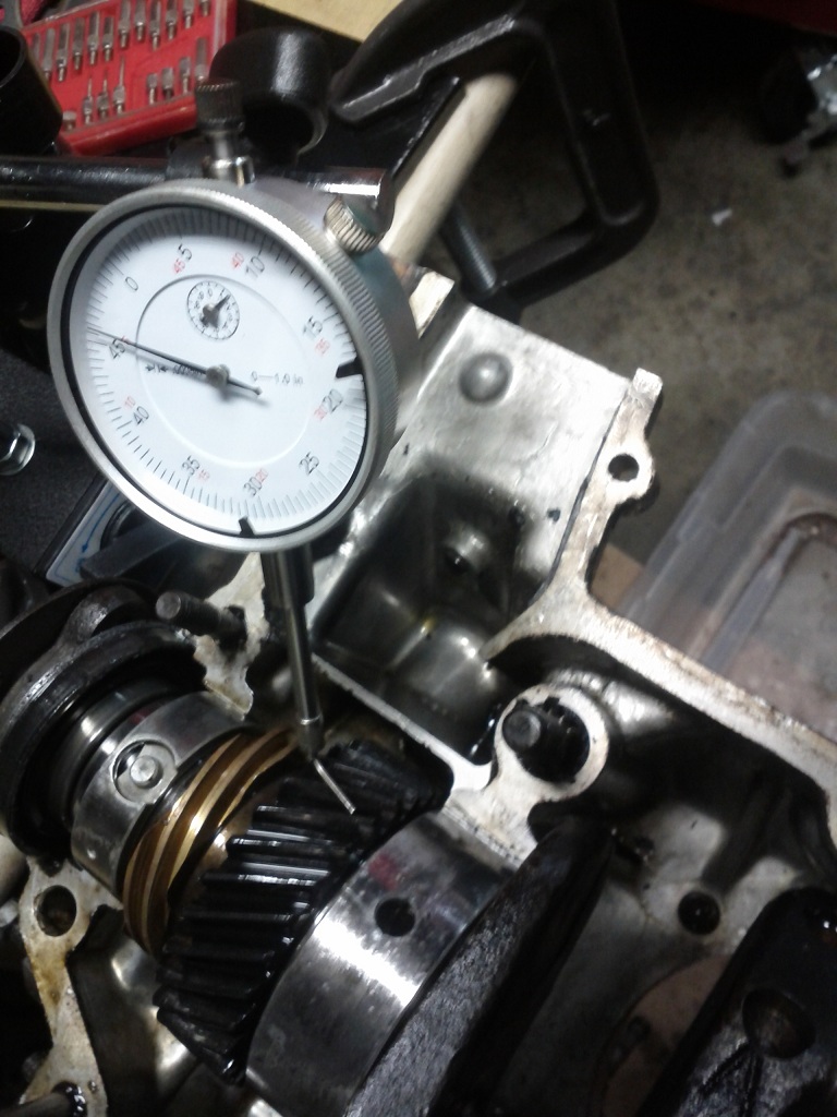

I rigged up a roundness check for the crank gear that drives the cam using my dial gauge and a 45* long tip. I had it set up so that the long arm would ride from one tooth to the next before it fell in the gap. This gave me a surprisingly small jump (0.004") from one tooth to the next, it read out in a sort of sine wave. As I turned the shaft I watched the gauge and saw the change in average reading. The average reading changed approximately 0.005", which to me indicates that the gear should be fine.
Does anyone know a better way to measure roundness? I am concerned about the extra abuse taken by the gears because of the cam bolt interference with the case.
