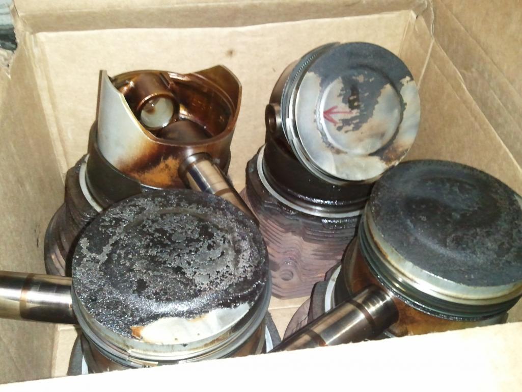

I've taken 2 of these apart, both from 72's and both most likely original. I swear I found one dished and one domed. euro-spec was flat and it's likely that anyone going to the trouble to rebuild would either reuse what they had or go to the euro spec.
I can't find any good pictures of the pistons from EA0033579 (claimed to come from a 72, I bought the entire engine from the owner who had just crushed the car, I didn't get the serial number from the body) which I recall being dished. here's a shot of the pistons that came out of EA02497. It had ~80k confirmed miles on it when I got it and had been garaged for 15'ish years, so most likely original. |

Dave_Darling The W-code engines had domed pistons. Not sure ab... Mar 22 2013, 09:21 PM

nathansnathan The EA engines did have domed pistons as did the W... Mar 23 2013, 07:50 AM
nathansnathan I should add, there is definitely info missing the... Mar 23 2013, 09:15 AM
Dave_Darling The European 1.7s had D-jet, just like the US-spec... Mar 23 2013, 02:44 PM![]() ![]() |
