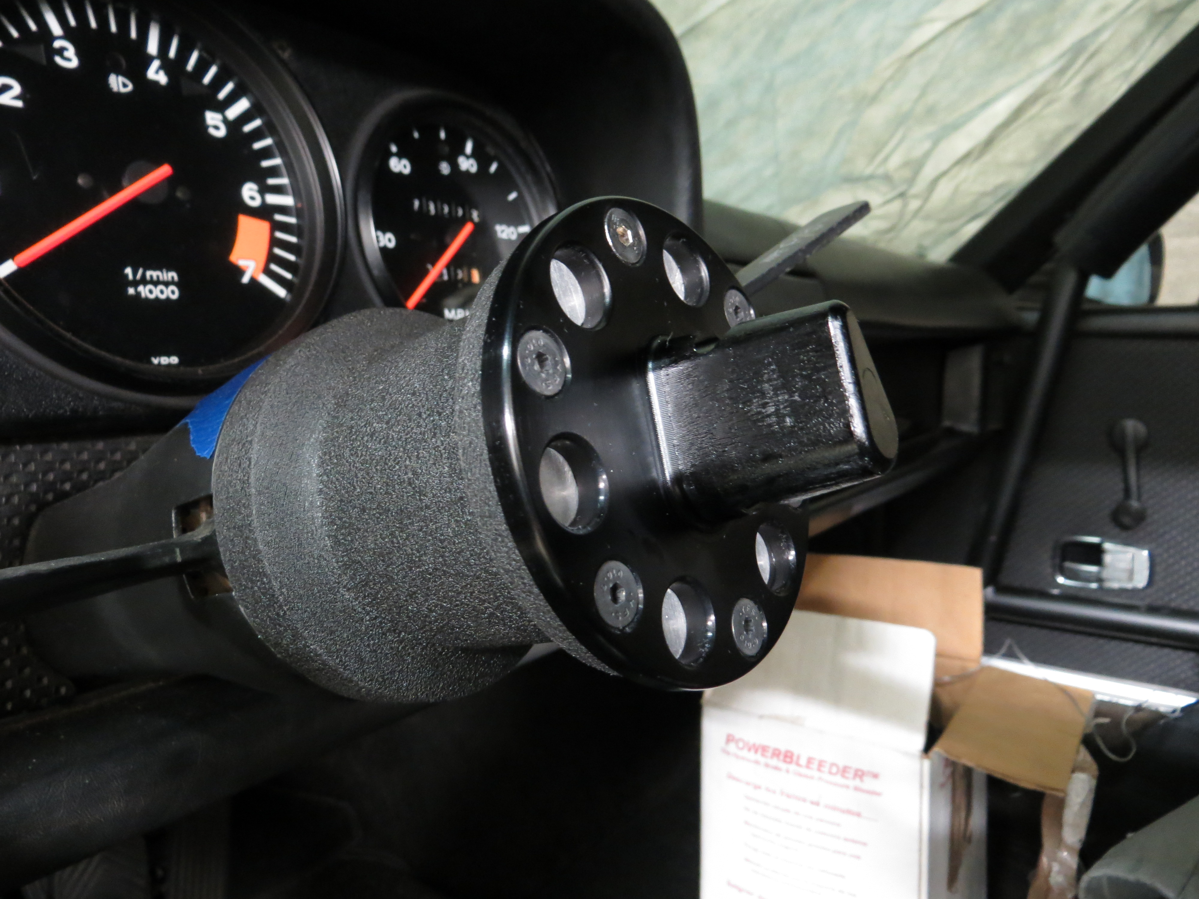

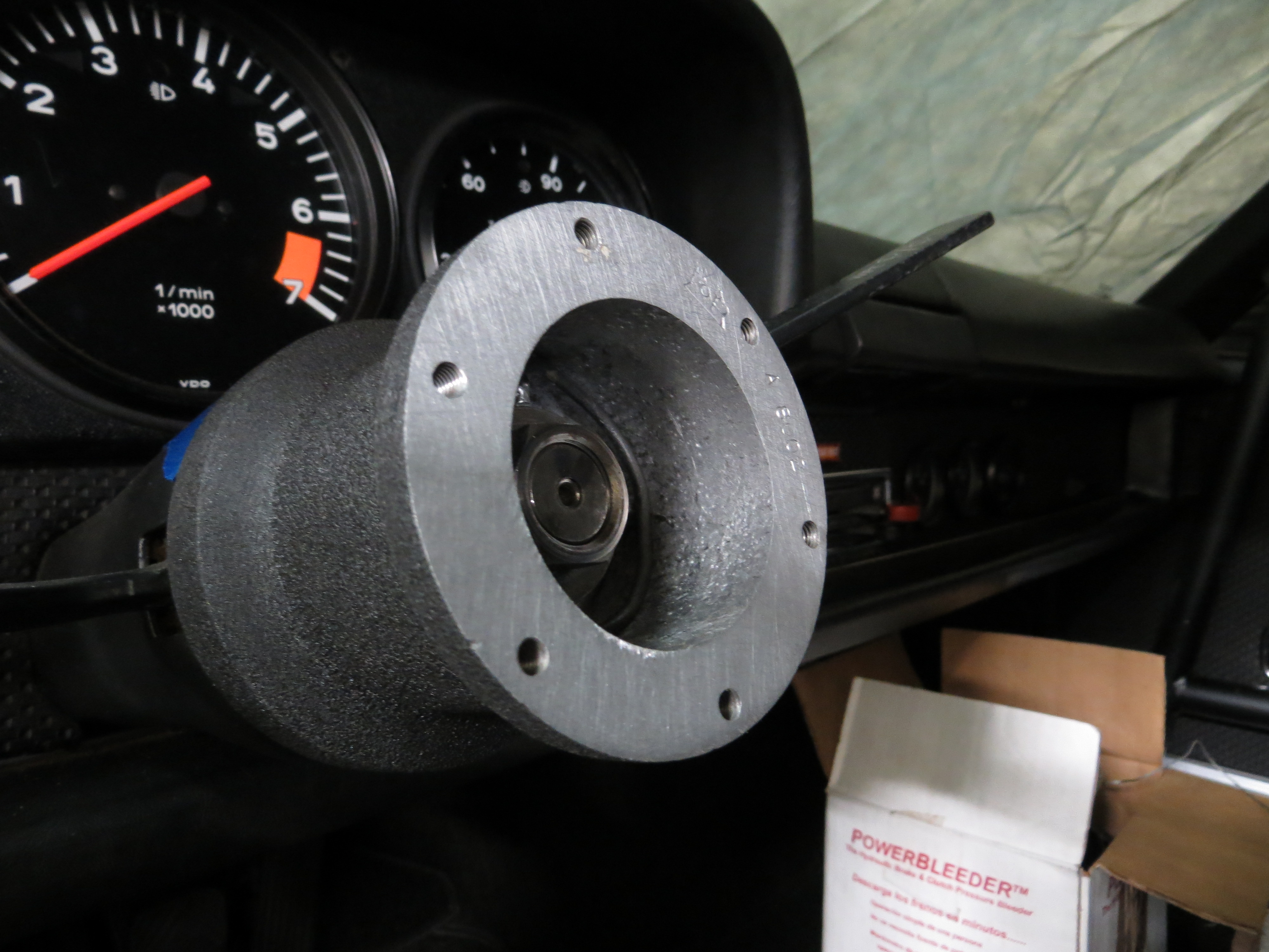

I ended up using my right angle die grinder and a 2" diameter Roloc 100 grit disc to knock down the lip:
Then put on the male socket:

Harpo   :agree: Machine off the lip so they are flush. Th...   Mar 20 2013, 03:23 PM
tomeric914   :agree: Machine off the lip so they are flush. T...   Mar 20 2013, 06:45 PM
pete000   Hmmm, just wondering why you would want one of th...   Mar 20 2013, 03:49 PM
tomeric914   I ended up using my right angle die grinder and a ...   Mar 23 2013, 09:29 AM

tomeric914   Dave, this photo is for you. My view may be diffe...   Mar 23 2013, 09:36 AM
