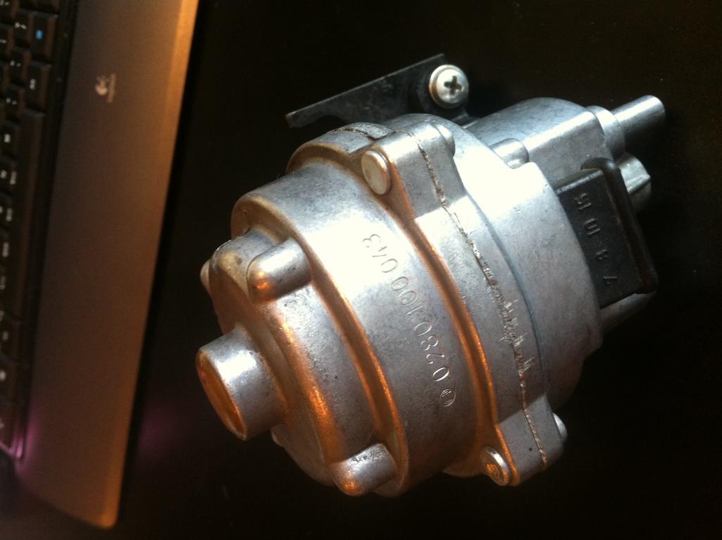

I bought it in Germany at a Volkswagen dealer for 50 Euro. I also found a Bosch tester at a flea market there. I was also told that Volkswagen Classic intends to support the classic car sceen with original Bosch parts. The problem with the remanufactured MPS is probably the adjustment for altitude and density compensation.

76-914   What Curt said :agree: Also, you bought a new MAP ...   Mar 25 2013, 02:47 PM

76-914   You have a NEW MPS? If so, nice find. If it's ...   Mar 26 2013, 08:49 AM
Edchina   I bought it in Germany at a Volkswagen dealer for ...   Mar 26 2013, 12:07 PM
