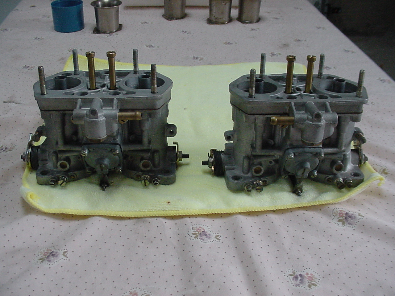

Yea it is kind of a waste (Weber 36/38 DVG) but I have a number of projects that are sucking up $$$ so I am trying to make it a while with this set up. Had a huge stumble before changing to the 60s on the Accelerator jets. The stumble is mostly gone now. Waiting for a 70 to come in. But while its better, it seems to not want to idle. Regardless of how I try to adjust it acorroding to the instructions, it seems to want to die. At anything above idle it seems to be fine. The problem was there before the change but it was no better after. Did a good cleaning on everything else but did not change anything other than the accelerator diaphram. One thing I noticed is that fuel seems to be dripping into the primary. I am not sure if it was like this before as I had not looked in.
I am assuming this is not normal, so any thoughts on what I goofed up?

something like these. versatile.

Mblizzard   OK I am beaten! Maybe it is just me but I hav...   Mar 25 2013, 01:20 PM
'73-914kid   what size motor do you have? those 44's are pr...   Mar 25 2013, 01:43 PM
Mblizzard   I hope they are not too big. I have a 1.8 with a ...   Mar 25 2013, 03:51 PM
'73-914kid   the general consensus is that the 44's are too...   Mar 25 2013, 04:07 PM
Mblizzard   Got them through Redline. The may not have shippe...   Mar 25 2013, 04:18 PM
Vacca Rabite   Get the 40s. You can get 44s to work but you will...   Mar 25 2013, 04:20 PM
Mblizzard   Not sure I want only a "top end" motor. ...   Mar 25 2013, 05:20 PM
Vacca Rabite   You can choke the 44s down to 40 levels, but you s...   Mar 25 2013, 06:14 PM
SirAndy   I changed to 40s and had a much better rev range. ...   Mar 25 2013, 08:32 PM
Mblizzard   Maybe Art can turn the 43s into 40s. I will contac...   Mar 25 2013, 07:46 PM
monkeyboy   44's are way too big. 40's would be better...   Mar 26 2013, 08:51 AM
Chris H.   Are you changing the cam?   Mar 26 2013, 08:56 AM
Mblizzard   It already has a carb cam. Zach took your suggesti...   Mar 26 2013, 09:38 AM
Vacca Rabite   Do as Art says. If I had I would hav spent a lot ...   Mar 26 2013, 10:20 AM
DBCooper   You might have asked Art how much to set up the 44...   Mar 26 2013, 11:02 AM
mr914   I've used the DGAV carbs for 20 years F5 emul...   Mar 26 2013, 11:15 AM
Mblizzard   I have a call into Dave to talk about the best app...   Mar 26 2013, 12:29 PM
SirAndy   Do you have a recommendation for a rotary pump? CB...   Mar 26 2013, 12:43 PM
SirAndy   http://www.cbperformance.com/ProductDetail...roduc...   Mar 26 2013, 12:44 PM
DBCooper   +1. Saves you a few bucks on the separate pres...   Mar 26 2013, 03:09 PM
Mblizzard   After talking with ACE it seems like there is not ...   Mar 27 2013, 02:39 PM
DBCooper   Huh. Well, if there's no difference in cost g...   Mar 27 2013, 09:42 PM
