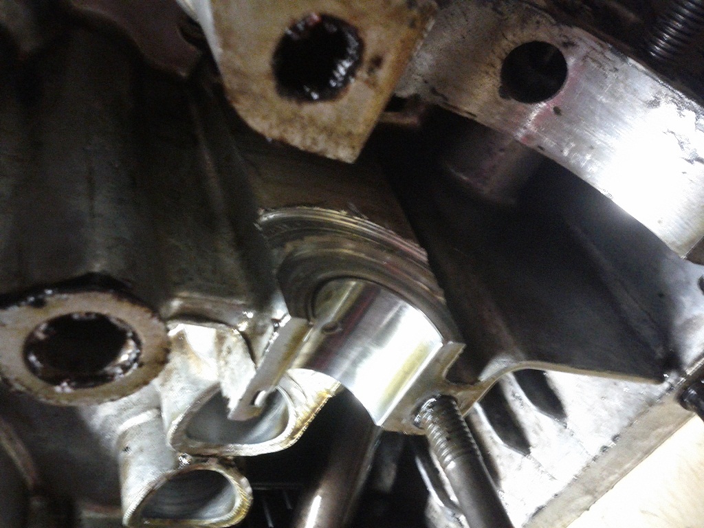

I guess I could answer my own question with something like "the bolts just shaved the case, not enough to be heard but enough to drizzle fine magnesium dust down between the cam and thrust bearing surfaces, leading to the failure."
http://www.914world.com/bbs2/uploads/post-...-1363672654.jpg

Valy   The cam looks to be aftermarket. The bolts between...   Mar 19 2013, 06:20 PM
Valy   Here is how the cam bolts should look like so they...   Mar 19 2013, 06:25 PM
Vacca Rabite   :agree: Your cam bolts self machined themselves i...   Mar 19 2013, 06:32 PM
AE354803   :agree: Your cam bolts self machined themselves ...   Mar 19 2013, 08:36 PM
Valy   The cam gear angled teeth create an axial pushing ...   Mar 19 2013, 10:19 PM
AE354803   Based on this pictures from Van's 914 engine r...   Mar 19 2013, 11:25 PM
Valy   The bolts don't hit the bearing. I think that ...   Mar 20 2013, 09:59 AM

bugsy0   So what's the conclusion on why the original c...   Mar 28 2013, 10:36 PM
bugsy0   I guess I could answer my own question with someth...   Mar 28 2013, 10:49 PM
Vacca Rabite   Well, aluminum. Not magnesium. T4 cases are alum...   Mar 29 2013, 07:21 AM

AE354803   The top had the same large gap all the way around,...   May 8 2013, 09:19 PM
AE354803   During platigage fit today, found out the cam thru...   May 11 2013, 06:57 PM
