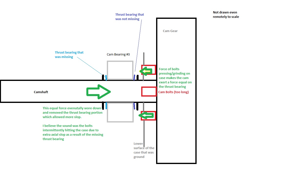

The bolts don't hit the bearing. I think that they shaved the case and that shaving got on and behind the thrust lip causing it to fail. That's the reason you found a full lip detached from the bearing.
I would check for other damage caused by those shavings.

Disregard my previous post - I found this. Surely the engine builder would have heard the bolts hitting the case, no?
I don't believe it had anything to do with the debris. The bearing was missing in the cylinder portion of the case, while the shaving was occuring in the cam gear portion. Those portions are separate, aside from oil flowing between them. See the drawing for what I believe happened, it makes sense and would explain why the noise went away above 3000 rpms.
Above those speeds it must have built up enough centrifugal momentum to essentially stabilize itself and not hit the case, or the engine was running smoother and more evenly.
Just theories though.
I don't know how the PO missed that while assembling. The engine must have been thrown together quickly and without a dry assembly or much checking anywhere else.

Valy   The cam looks to be aftermarket. The bolts between...   Mar 19 2013, 06:20 PM
Valy   Here is how the cam bolts should look like so they...   Mar 19 2013, 06:25 PM
Vacca Rabite   :agree: Your cam bolts self machined themselves i...   Mar 19 2013, 06:32 PM
AE354803   :agree: Your cam bolts self machined themselves ...   Mar 19 2013, 08:36 PM
Valy   The cam gear angled teeth create an axial pushing ...   Mar 19 2013, 10:19 PM
AE354803   Based on this pictures from Van's 914 engine r...   Mar 19 2013, 11:25 PM
Valy   The bolts don't hit the bearing. I think that ...   Mar 20 2013, 09:59 AM
