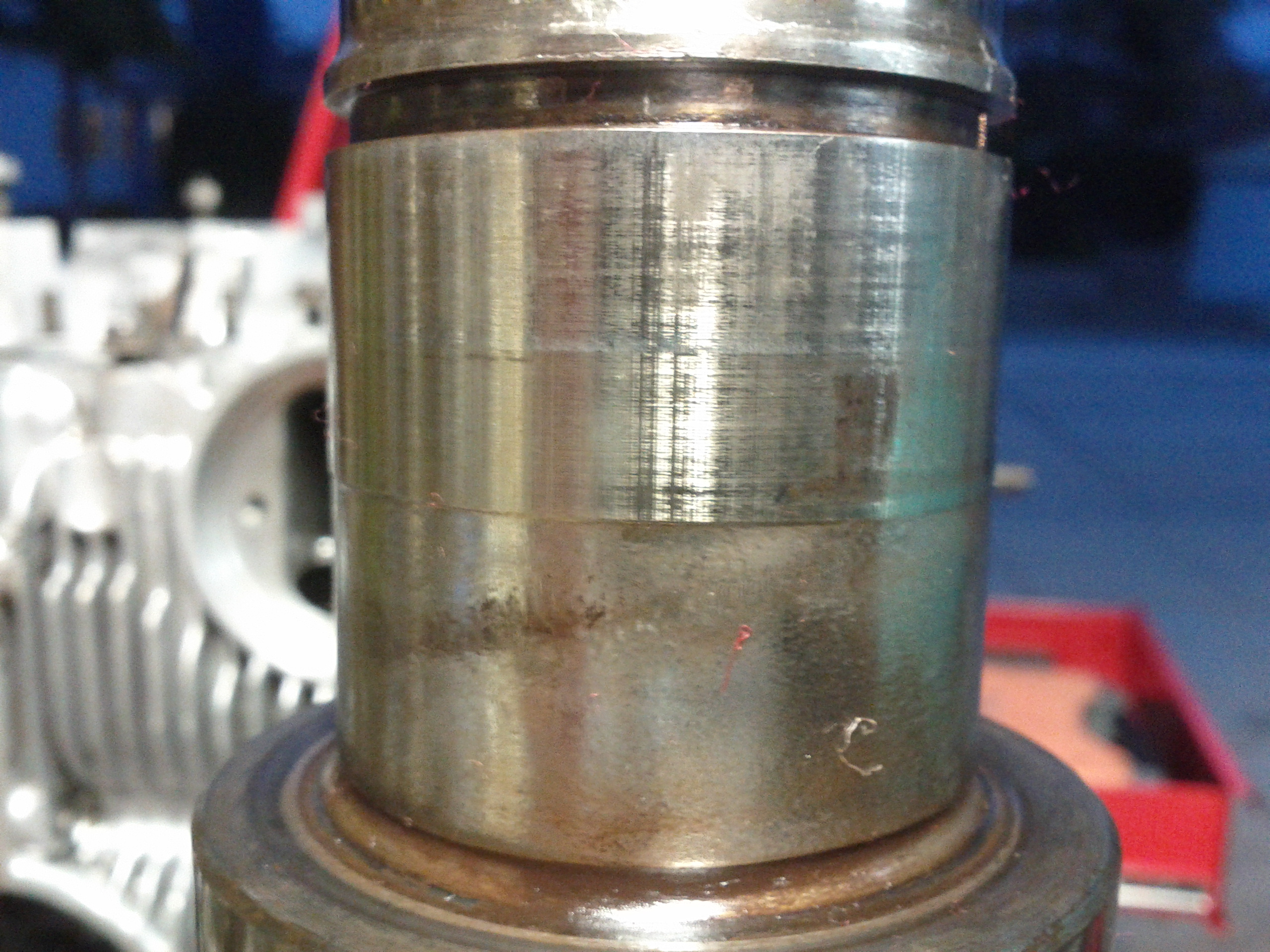

Just wonderful, finally took the crank gear assembly apart and took some measurements. Crank timing gear was so loose I could get it off by hand without heating it. shit
Shaft Diameter gets smaller where the timing gear rests (see picture) it's also out of round, I didn't quantify that though
Shaft OD: 1.6550"
Shaft OD at gear: 1.6500"
Gear ID (old): 1.6550"
Gear ID (newish): 1.65225"
so, I need to either get an undersized gear if that is possible, or get material built up on the crank. hooray! (IMG:style_emoticons/default/headbang.gif)
Would it be easier to replace the crank with a good used unit or get some material built up and machined back down?
No longer back on the road by end of april
Andy

AE354803   Just wonderful, finally took the crank gear assemb...   Mar 29 2013, 10:19 PM
Vacca Rabite   Thats not good! Nice metal shaving on the cran...   Mar 30 2013, 07:28 PM
AE354803   Trying to find a used crank that isn't undersi...   Mar 30 2013, 11:22 PM

AE354803   Where can I remove material from the Keith Black p...   May 5 2013, 11:43 PM
AE354803   I've been looking at the pistons and I think I...   May 8 2013, 01:08 PM
AE354803   I'm measuring the piston-cylinder gap. Spec i...   May 8 2013, 06:43 PM
Valy   All pistons have oval skirts as you measured. The ...   May 8 2013, 07:56 PM
AE354803   The top had the same large gap all the way around,...   May 8 2013, 09:19 PM
