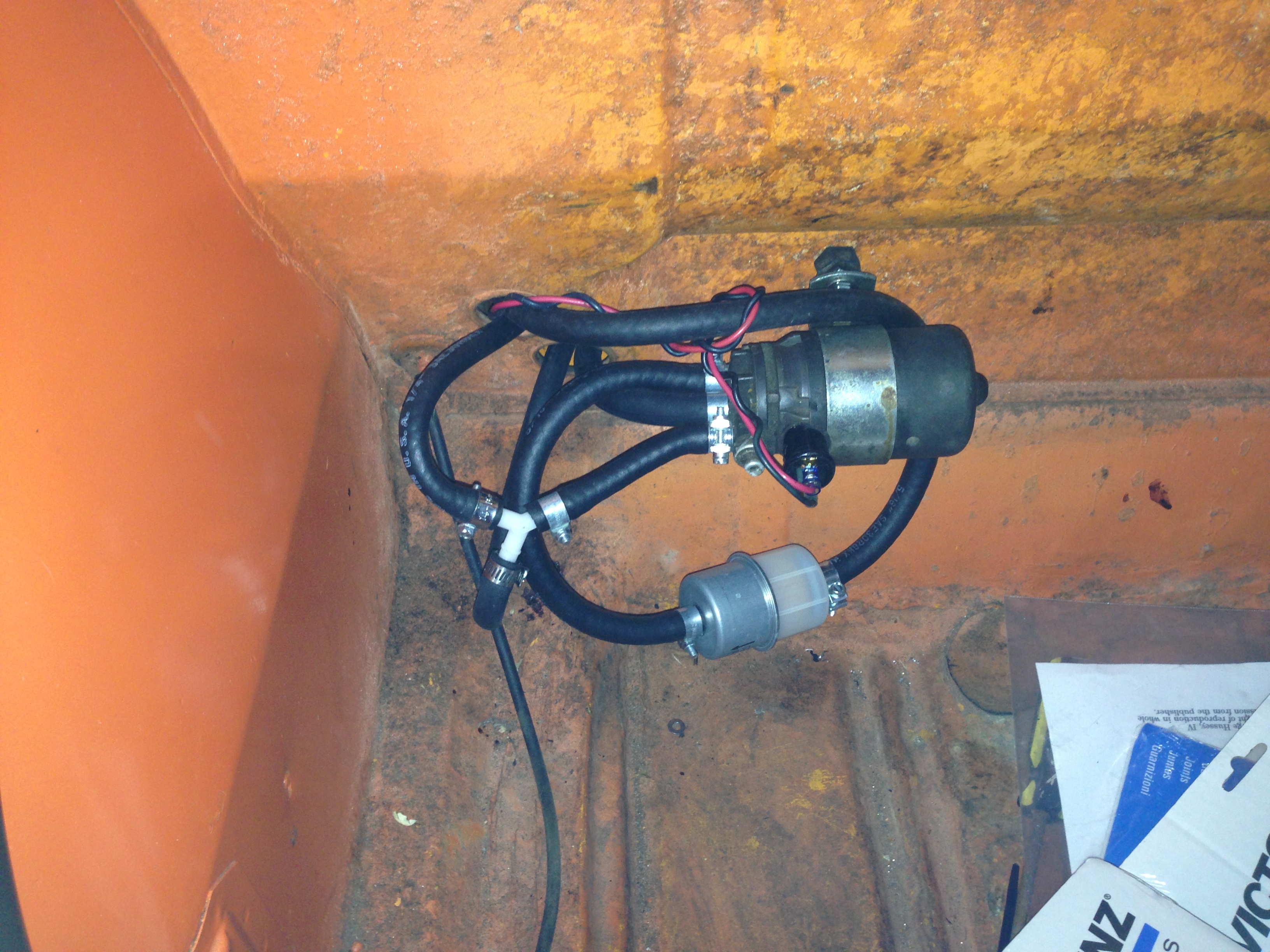

fuel pump

Dave_Darling   Your hoses are not right. Especially if that...   Apr 9 2012, 08:22 PM
ChristopherB   Thanks dave. That was a picture when I got the ca...   Apr 10 2012, 12:31 PM
vsg914   That hose on the pcv valve goes on the plenum port...   Apr 10 2012, 12:40 PM
