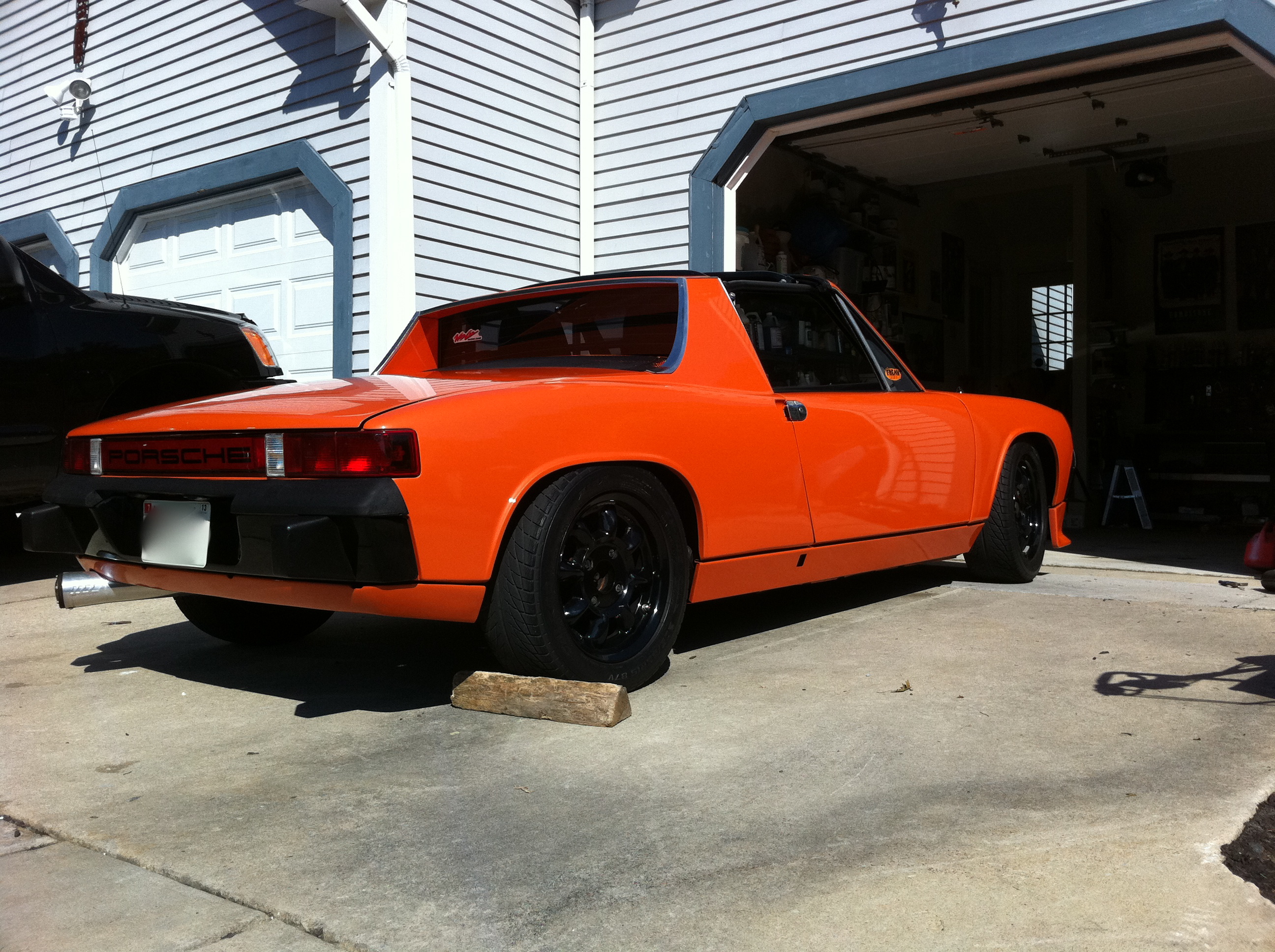

ChristopherB   Thanks. I love the car. I think it looks and dri...   Mar 31 2013, 06:21 PM
ChristopherB   Here are some photos just to make this more intere...   Mar 31 2013, 06:29 PM
ChristopherB   I did not even know what a valve cover was when I ...   Mar 31 2013, 06:30 PM
