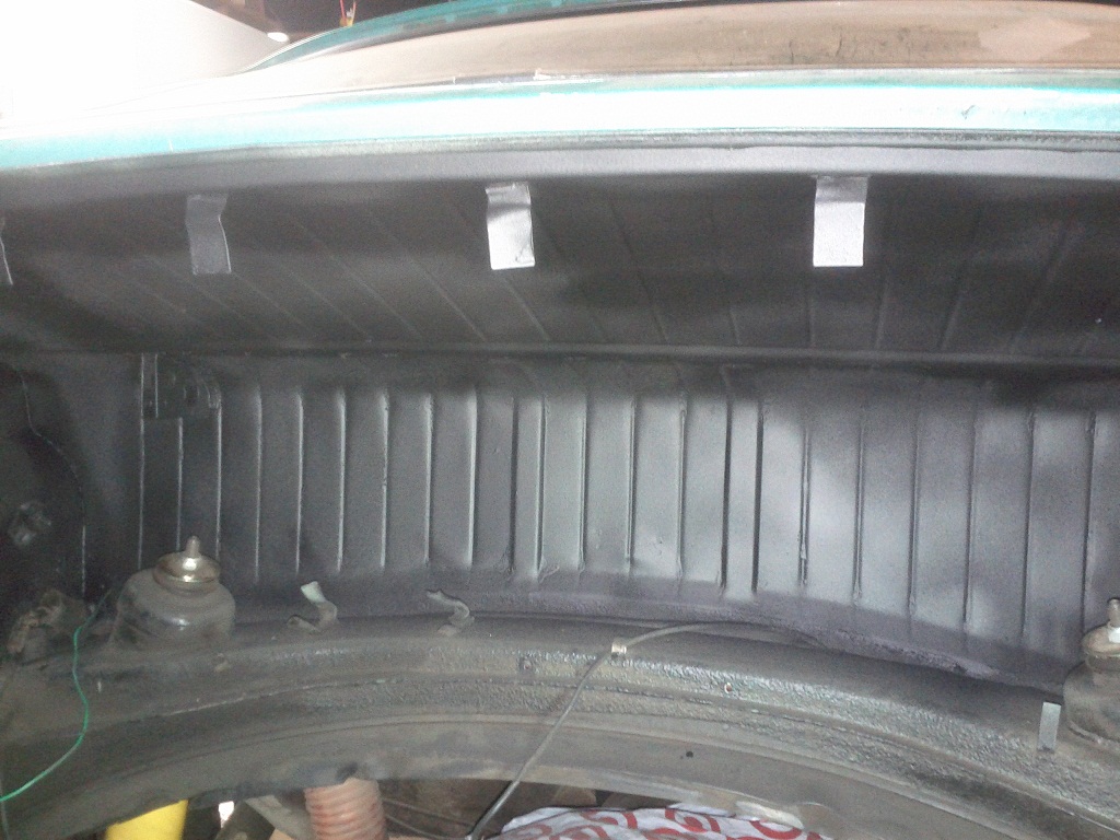

Repainted the firewall and tray behind rear seats on sunday, I've been using Rustoleum Self Etching Primer and Rustoleum Pro Grade Undercoating for the floor pan and in the engine bay. They seem to adhere very well and they have the any direction spray nozzles. Put them in to stave off any rust formation and once all the body work is finished I'll get it painted for real.

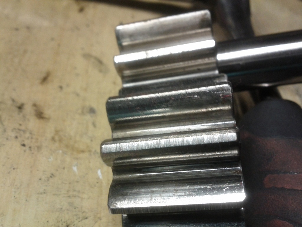

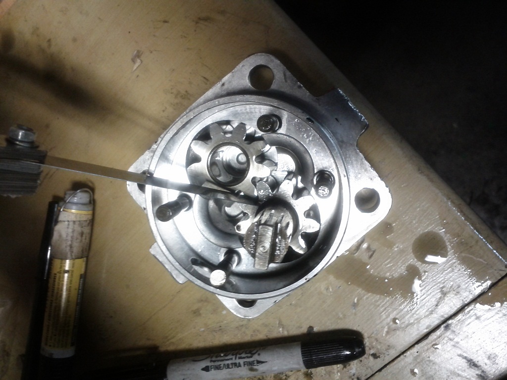

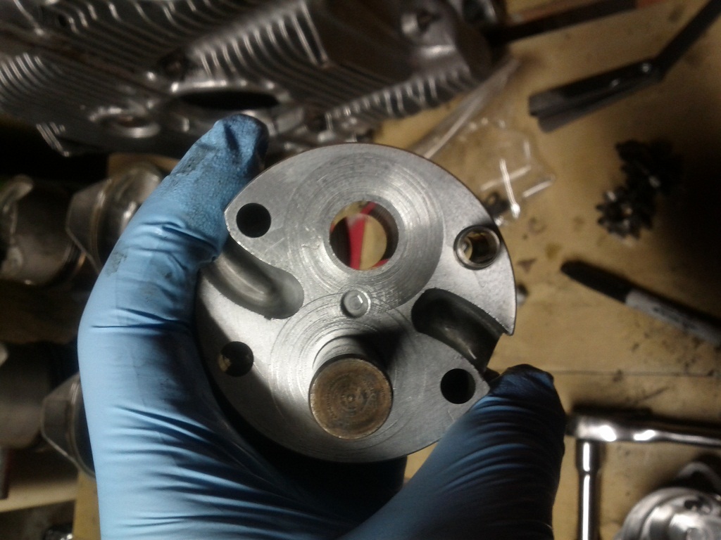

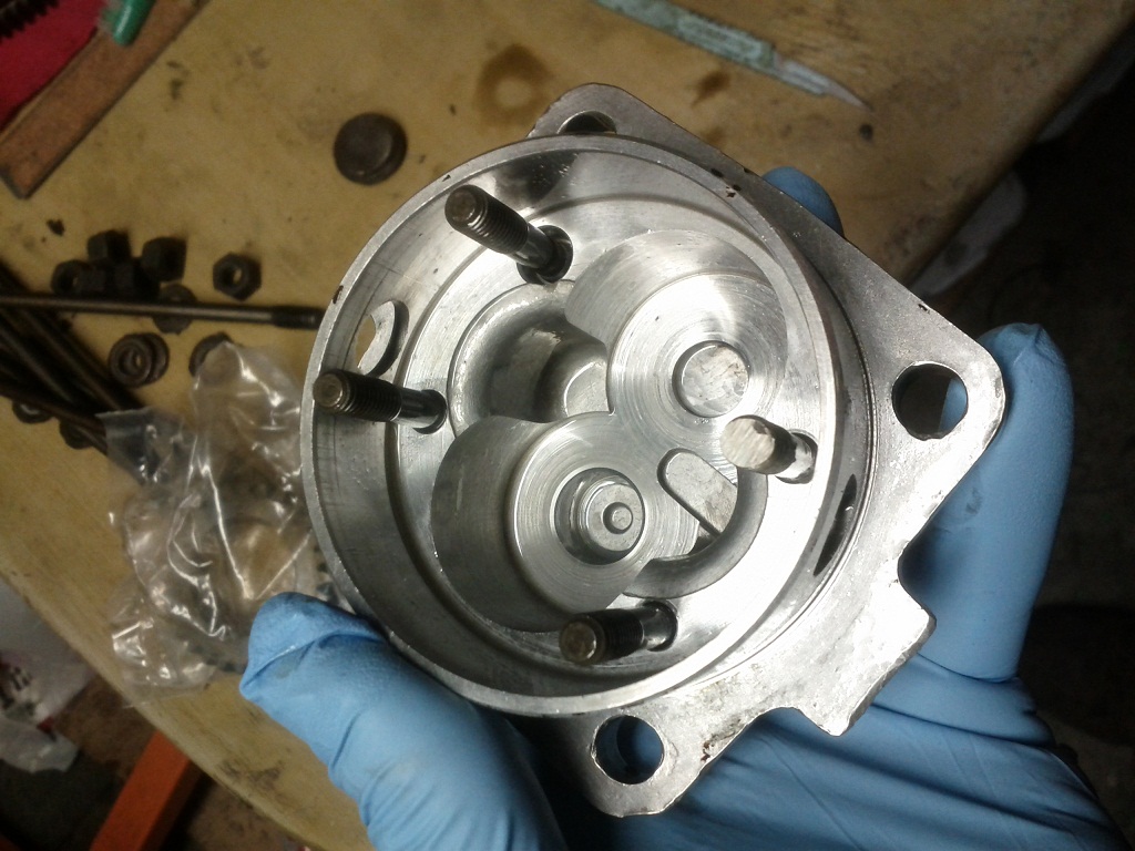

Took apart the oil pump and took measurements. It was working very well when I took the engine apart (80 psi when cold, 33 psi at 3000 rpm). Never had an issue with pressure or temperature.
I found some wear and evidence that it had seen hard metal particles going through it. The edges of the gears were grooved slightly, there were matching grooves in the walls, but everything was pretty tight. Could only fit a 0.006" shim in between mating gears.
Going to try to find a used type IV stock pump. I'm not very worried about putting this one back in though.
Advice?? I would really like to stay with the type IV, I like the ears for pulling the pump and I don't want to overwhelm my oil system, especially since I only have 1 relief valve.

Vacca Rabite   Pump failure comes at the driveshaft. Yours looks ...   Apr 2 2013, 07:34 AM
craig downs   Not necessarily The pin that is pressed in can ove...   Apr 2 2013, 09:05 AM
AE354803   Not necessarily The pin that is pressed in can ov...   Apr 2 2013, 09:41 AM
Vacca Rabite   Not necessarily The pin that is pressed in can ov...   Apr 2 2013, 09:50 AM
Valy   The measurement you should care about is the axial...   Apr 2 2013, 10:42 AM
AE354803   I can really only measure axial movement for the d...   Apr 2 2013, 10:47 AM
Valy   Lapping compound can't do any good. If you ins...   Apr 2 2013, 12:48 PM
