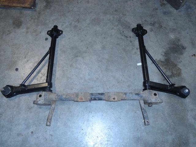

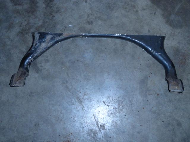

Am I missing something here????? :shock: The "point of no return cut" takes place. . .
(IMG:http://www.914world.com/bbs2/uploads_offsite/images.thesamba.com-9730-1365011759.1.jpg)
(IMG:http://www.914world.com/bbs2/uploads_offsite/images.thesamba.com-9730-1365011759.2.jpg)

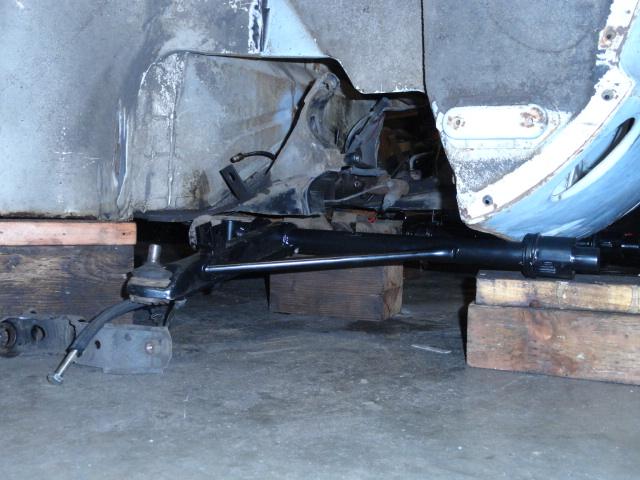

The lid is ready to come off on my plans for the front-end. Out with the old beam, in with highly tunable Porsche 914/911 front suspension. :twisted: Don't worry, the center beam will be powder coated like all the rest once any mods that need to take place happen first.
(IMG:http://www.914world.com/bbs2/uploads_offsite/images.thesamba.com-9730-1365011759.3.jpg)

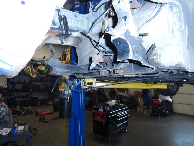

Mocked-up to the general position where this front-end will call home from now on. Before that happens, MUCH prep work will take place beginning with boxing in the area that was cut out in order to gain back the strength.
(IMG:http://www.914world.com/bbs2/uploads_offsite/images.thesamba.com-9730-1365011759.4.jpg)
