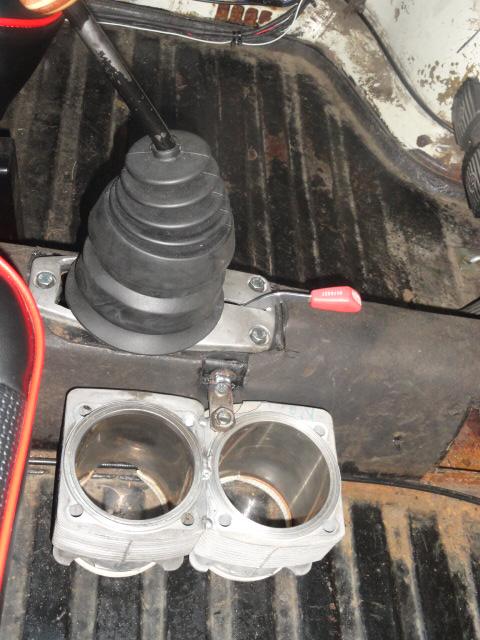

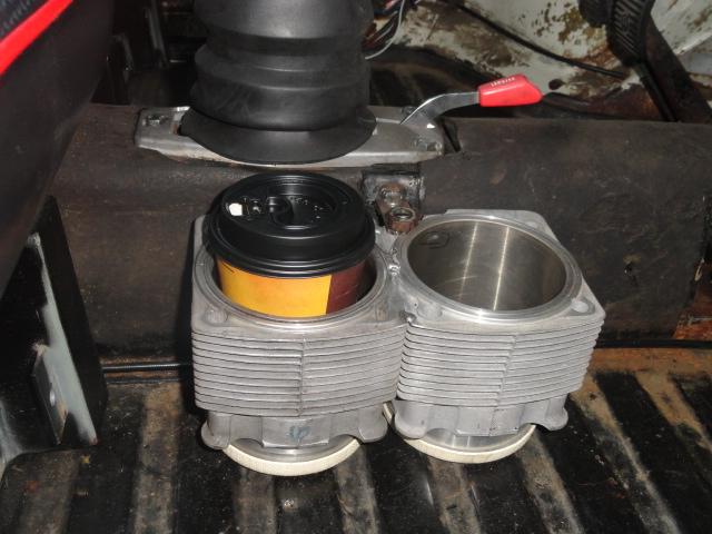

One thing that consistently bugs me about ALL A/C VWs is that there are no cup holders in the car. Typical aftermarket one-size-fits-none solutions generally suck and are flimsy. The Squarsche needed a set, so I came up with these (after seeing sixnotfour's cool drink cup), which could be the words fastest cup holders. (IMG:style_emoticons/default/biggrin.gif) I made them out of a pair of un-usable Porsche 911 Nikasil-coated Aluminum cylinders. I first TIG welded them together, added a piece of pinch-welt to the base (from an old set of beetle pop-outs I had) and then mounted them to a bracket I welded to the tunnel to keep them from moving around while driving. They fit a large McDonald's coffee (Mmmmmmmm. . .) great as well as any of the drink cups.
(IMG:http://www.914world.com/bbs2/uploads_offsite/images.thesamba.com-9730-1348758346.1.jpg)
(IMG:http://www.914world.com/bbs2/uploads_offsite/images.thesamba.com-9730-1348758347.2.jpg)

QUOTE(aircooledtechguy @ Sep 27 2012, 10:05 AM) *
...Porsche 911 Nikasil-coated Aluminum cylinders. I first TIG welded them together, added a piece of pinch-welt to the base (from an old set of beetle pop-outs I had) and then mounted them to a bracket I welded to the tunnel to keep them from moving around while driving. They fit a large McDonald's coffee (Mmmmmmmm. . .) great as well as any of the drink cups.
I was thinking about this today.
Wouldn't this set up effectively make hot drinks cool and cold drinks warm a lot faster then usual? After all, those jugs are made to shed heat quickly.

aircooledtechguy   One thing that consistently bugs me about ALL A/C ...   Sep 27 2012, 09:05 AM
Vacca Rabite   ...Porsche 911 Nikasil-coated Aluminum cylinders....   Apr 3 2013, 12:22 PM
aircooledtechguy   I was thinking about this today. Wouldn't th...   Apr 3 2013, 03:18 PM
