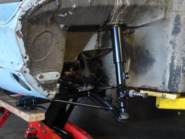

Phase-4 - Front suspension upgrade. Currently in-work

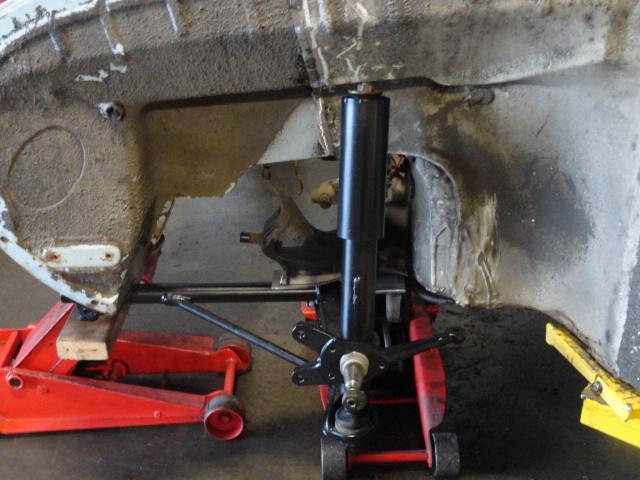

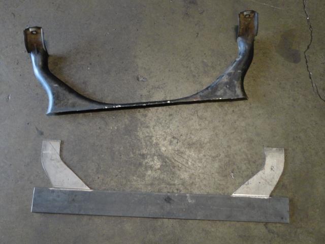

Made a fair bit of progress today. Made the box-in section for the frame horns to regain the strength. I made the load bearing part out of 1/4" thick flat stock. The rest that actually goes up the front of the horns is 1/8" steel. Once I have it all tacked in place, I'll be boxing-in the outer edges where the center truss mounts. I plan to tie it into the body of the car with plates and gussets since this is where 80% of the stress is on this front-end.
(IMG:http://www.914world.com/bbs2/uploads_offsite/images.thesamba.com-9730-1365125066.1.jpg)
Here's a couple shots after I raised it up in place so I could see how it would all fit in the car. I can already tell that I will need to make a small pocket for the aft end of the torsion bars and clearance the bottom of the frame horns where the strut arms connect. The shock struts are approx where they will be mounted, eventually. . . (IMG:style_emoticons/default/happy11.gif)
(IMG:http://www.914world.com/bbs2/uploads_offsite/images.thesamba.com-9730-1365125066.2.jpg)
