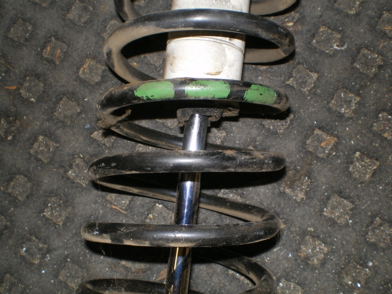

OK, I'm not done with this subject, yet. Just got side tracked. I removed my factory springs (100lb) and they do indeed have 3 green dots. They didn't appear to be dots when viewed from below but as this pic reveals they are identifying marks.

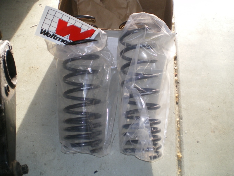

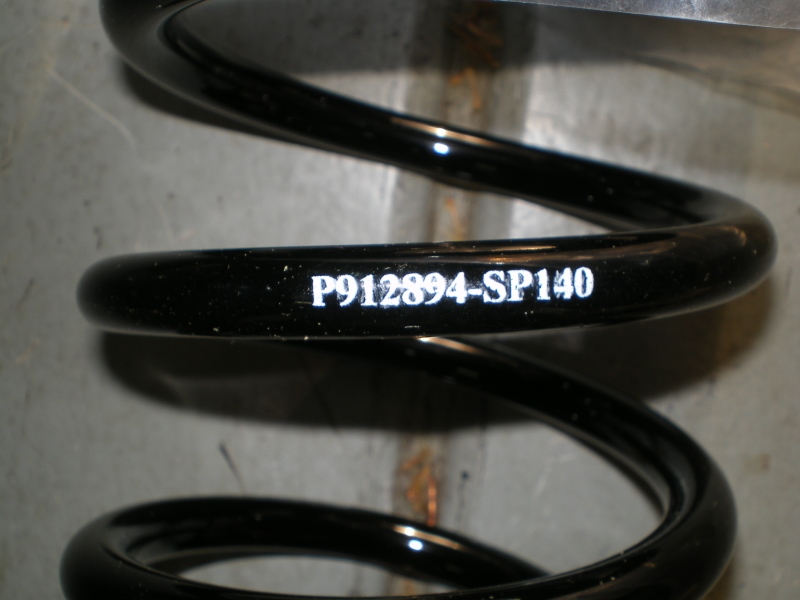

and a shot of the new 140lb Weltmeister's sans colour coding.
I'll do the squash test (as described by DD) to both old and new springs before I button this up. I want to see how well the old springs have held up for 35 + years. More on this, later.

the progressives will have a softer rate for the first amount of compression and then the final will be 140lb.
the tighter spaced coils will compress with the lighter weight and then the coils will stack and the rest of the spring will compress.
