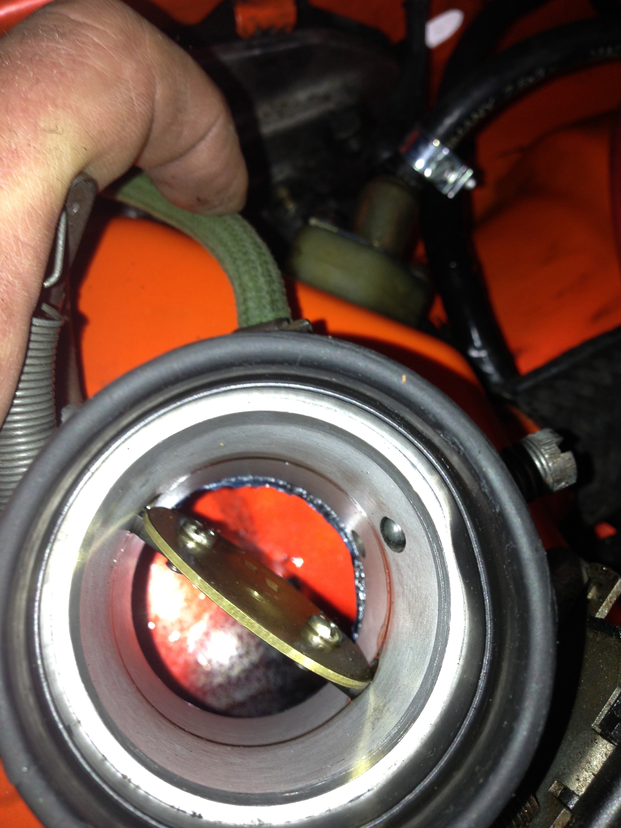

ChristopherB   Working on the car today and the throttle cable po...   Apr 7 2013, 11:20 AM
ChristopherB   I popped the cable back on the pedal. I think the ...   Apr 7 2013, 11:35 AM
