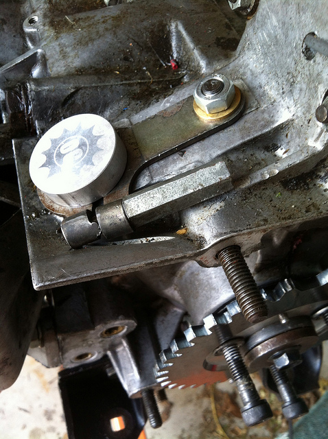

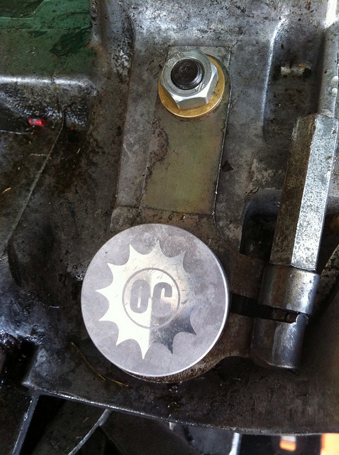

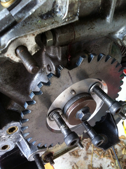

Since I have not added pic in a while...
(IMG:http://www.914world.com/bbs2/uploads_offsite/farm9.staticflickr.com-1435-1365463511.1.jpg)
Crank fire!
(IMG:http://www.914world.com/bbs2/uploads_offsite/farm9.staticflickr.com-1435-1365463512.2.jpg)
What dizzy?
(IMG:http://www.914world.com/bbs2/uploads_offsite/farm9.staticflickr.com-1435-1365463512.3.jpg)
The knob is on the wrong side. Not going to change it unless the tin does not fit. It not like I will have to adjust a dizzy any longer...
