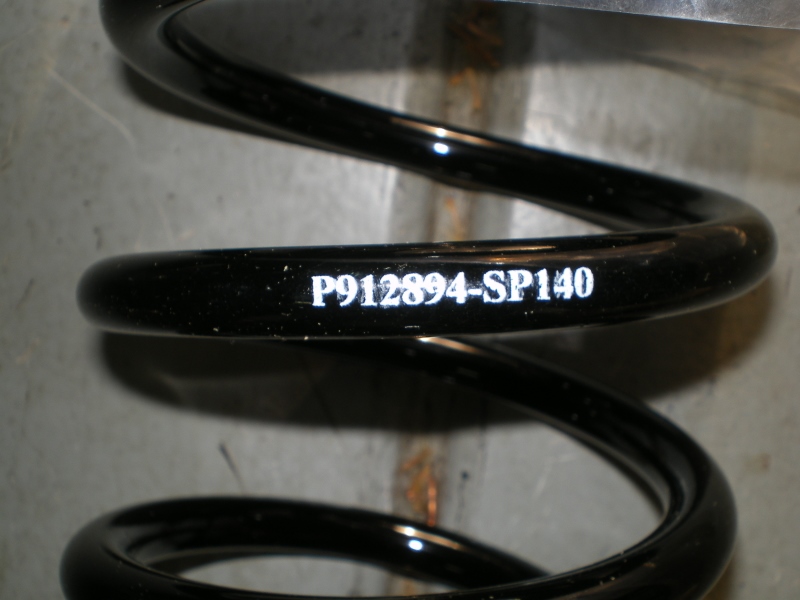

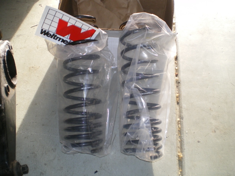

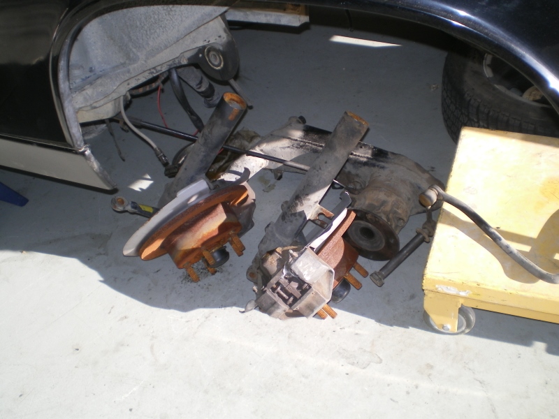

Time to get the suspension upgraded. I've covered most of this in other threads but I thought I'd at least hit the highlights here so I can relive it from the old age home one day. 1st some 914 porn courtesy of PMB.

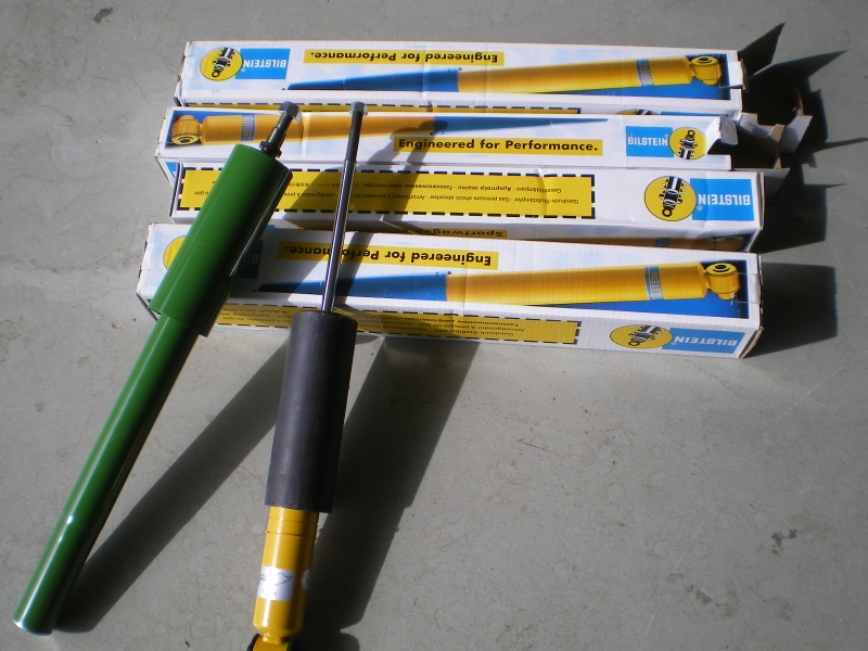

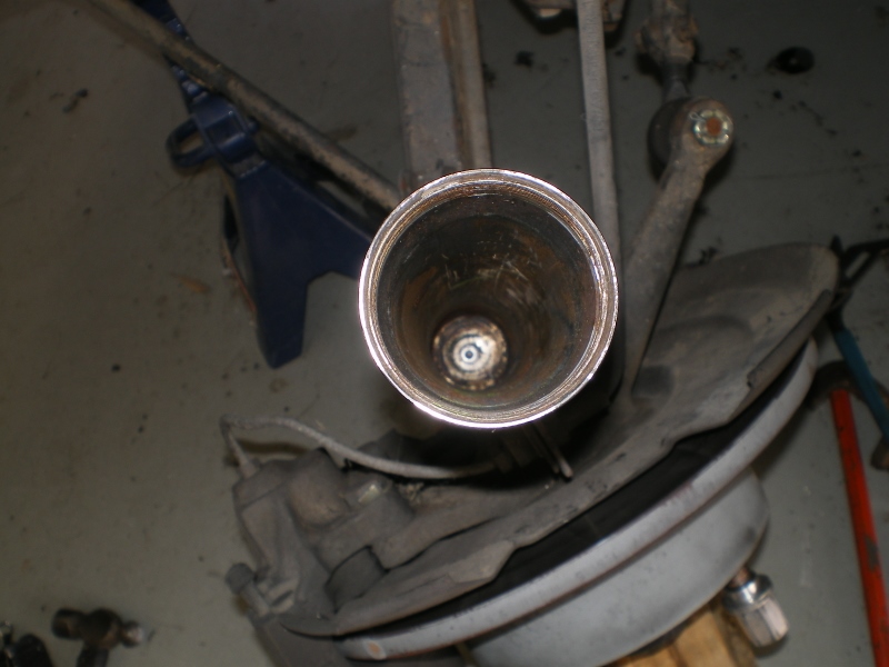

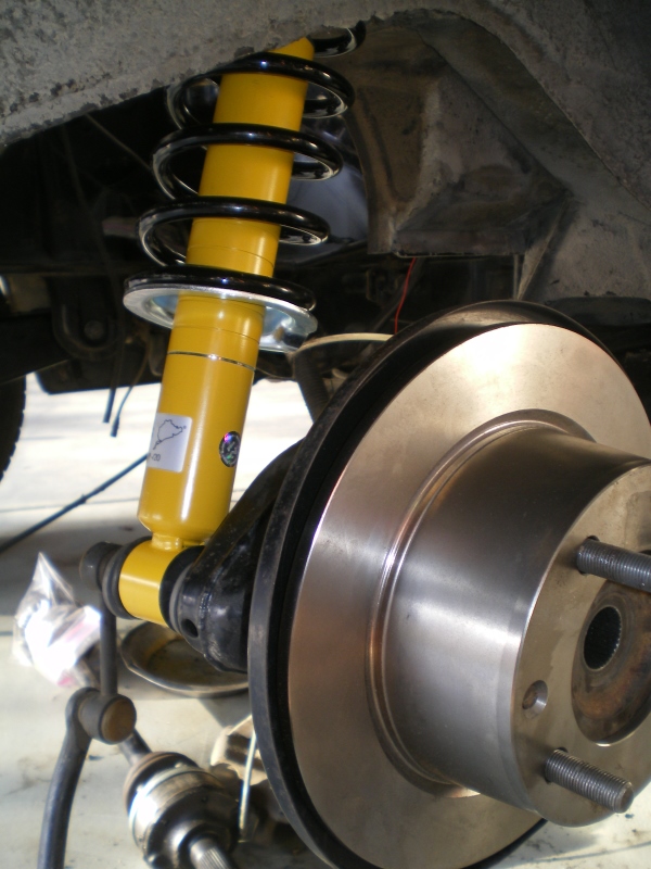

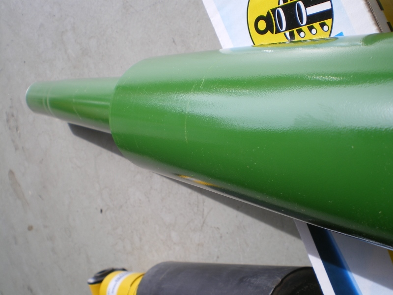

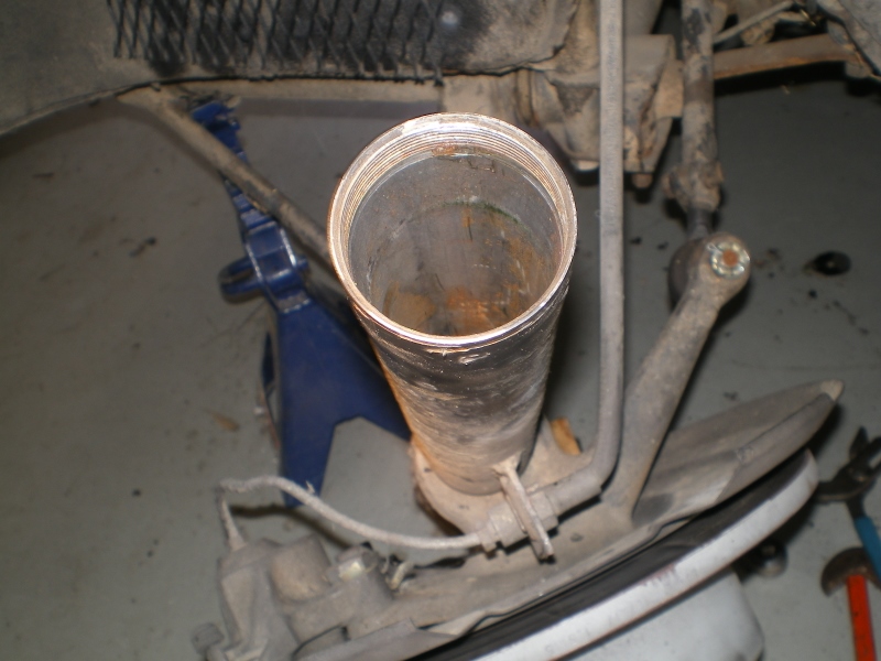

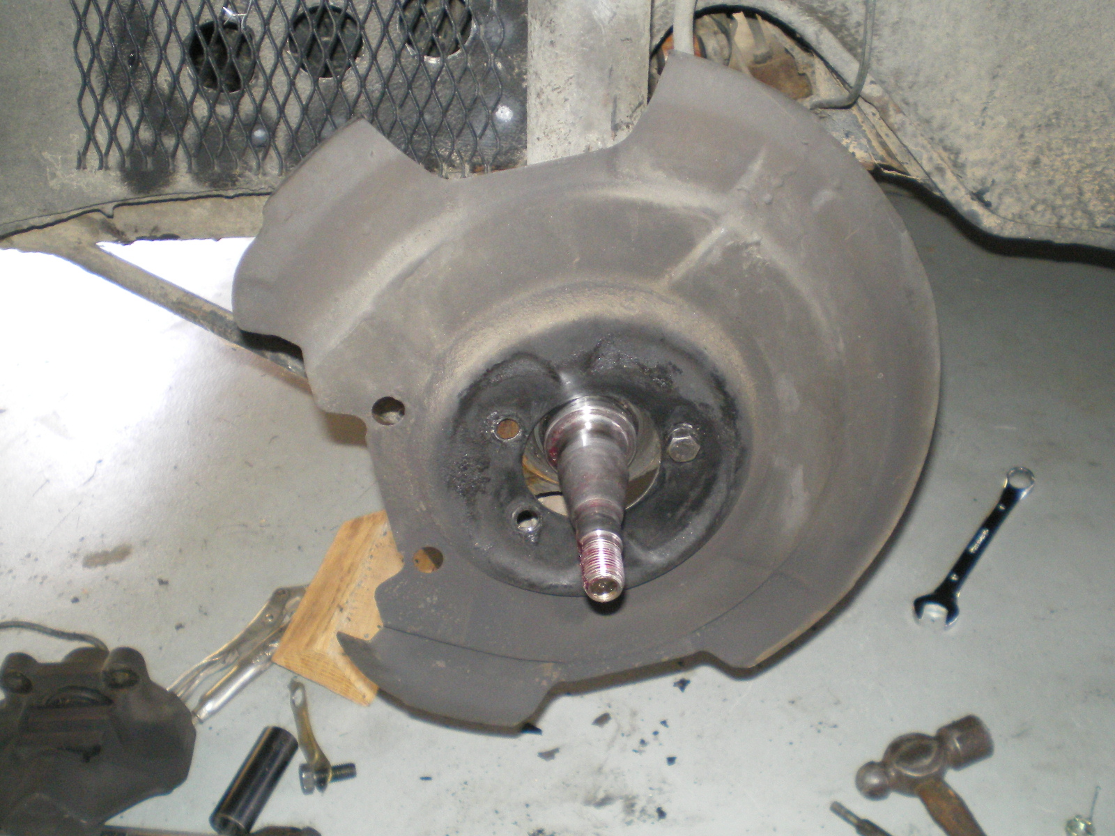

I began with the L front. I had done ball joints/tie rods, brakes, etc. previously so shocks were all that were necessary. The old shock was a blown out KYB which accounted for a noise I heard occasionally. When I dropped the new Bilstein it went 90% in and stopped. The old shock was narrow but this new one is fat and binding. Pulled it out and looked inside and found this bit of rust.
Ran a 2" wire fitting brush thru it several times. I even ran a rotary file over the areas that had rust, in case the metal had raised but it still would not fit. (IMG:style_emoticons/default/stromberg.gif)

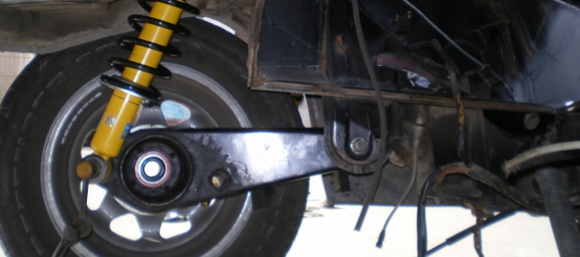

I discovered that area where it bound was the spot where the brake tab is welded on. It probably took a hit there and PO replaced with these skinny shits as a go around. Anyway, my buddy Ethan had these laying around so I cleaned up the L one and I was back in business.

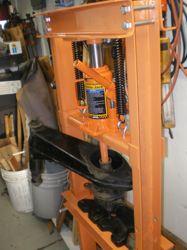

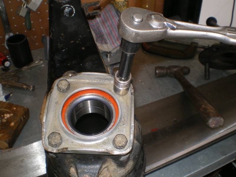

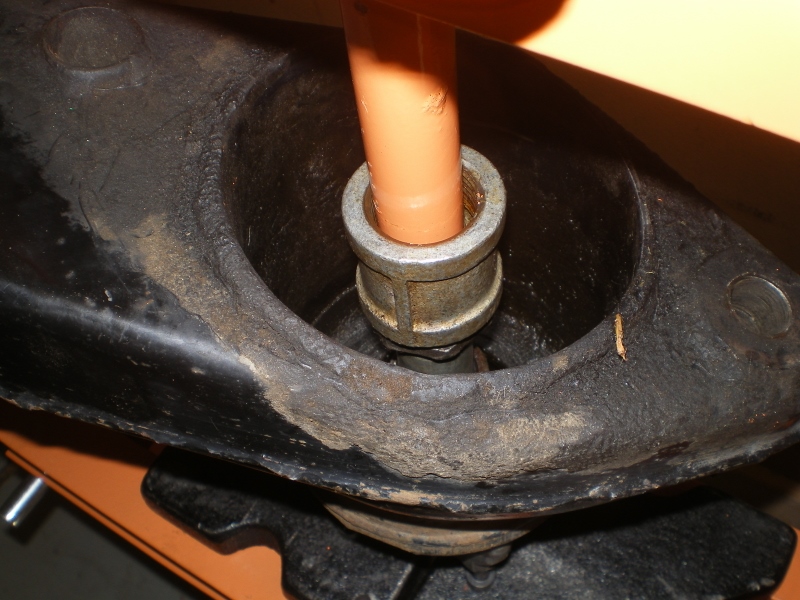

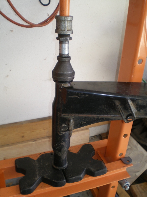

Bought this little tool to aid in refurbishing the trailing arms.

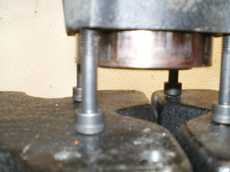

Pressing out the old bearing from the inside.
And here it is from the other side exiting the arm.
New poly bushings going in
Final assembly of the trailing arm

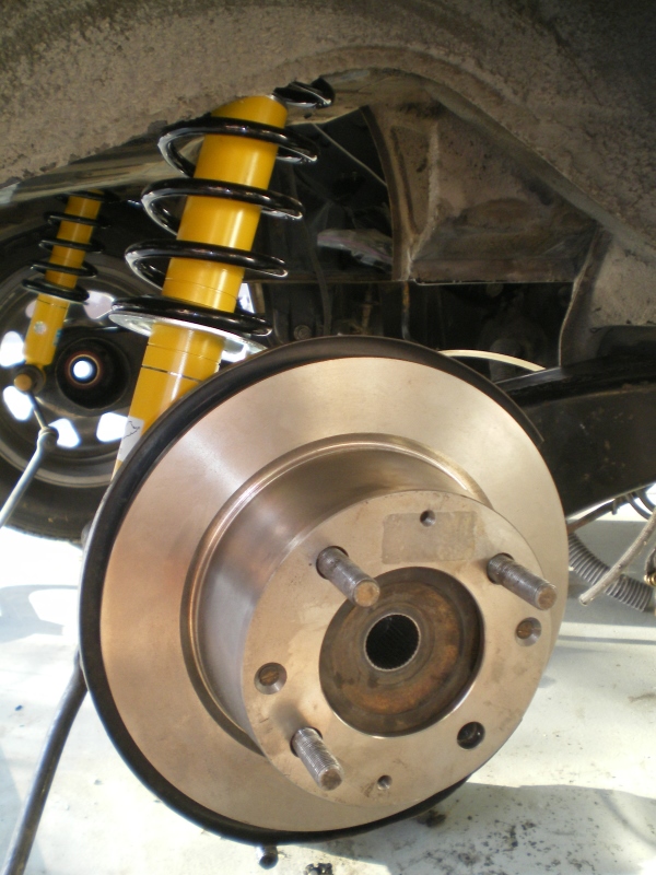

A few installed (less brakes) pics. Rear brake caliper rebuild is next.
