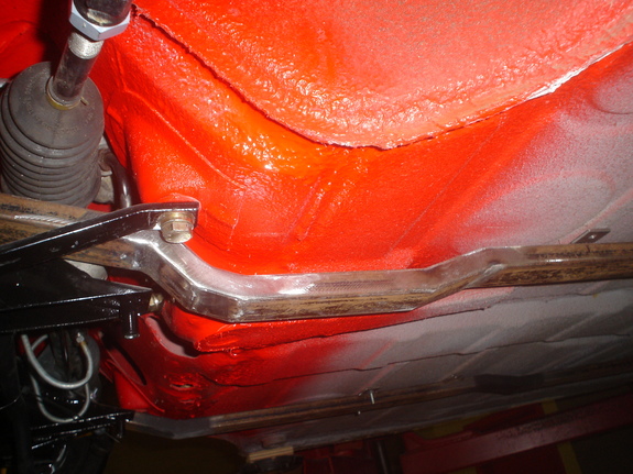

76-914   Before the fitting can happen I need to locate the...   Jan 12 2013, 09:17 PM
76-914   So, weld areas are sanded, cleaned and hit with so...   Jan 12 2013, 09:18 PM
76-914   There are places that need to be bent or formed an...   Jan 12 2013, 09:38 PM

76-914   I got around to welding on the r&l long stiffn...   Jan 20 2013, 10:05 PM
76-914   When I was banging around bracing the panels with ...   Jan 20 2013, 10:06 PM

76-914   Here is another view of the same corner but with t...   Jan 20 2013, 10:23 PM
76-914   I finally finished the welding of the Engman kit. ...   Jan 22 2013, 09:01 PM
