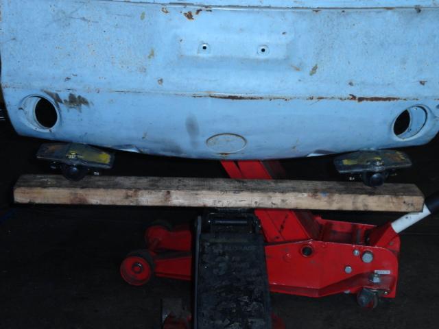

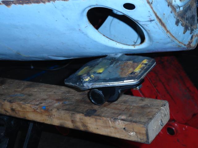

I finally got the Porsche front mounts that I cut from a derelict 914 trimmed down and prepped for mock-up. In these shots, they are mounted to the a-arms and the whole lower front-end is mocked in place so I could get a really good look at where the cut lines will need to be made. These will be recessed into the nose at the rear about 3/4", but will need to be boxed outward significantly at the front. I'm going to first recess the rear edge so that it fits correctly. Then after that is done, then I can tackle the box structure in the front.
(IMG:http://www.914world.com/bbs2/uploads_offsite/images.thesamba.com-9730-1365525972.1.jpg)
(IMG:http://www.914world.com/bbs2/uploads_offsite/images.thesamba.com-9730-1365525972.2.jpg)
The material it's boxed with will be the same .75" (2.0mm) sheet that the Porsche mounts are made from. This will then have plates on the inside that tie it all to the body and pan via the upper frame horns. So far everything is going according to my sick plans. . . (IMG:style_emoticons/default/happy11.gif)
