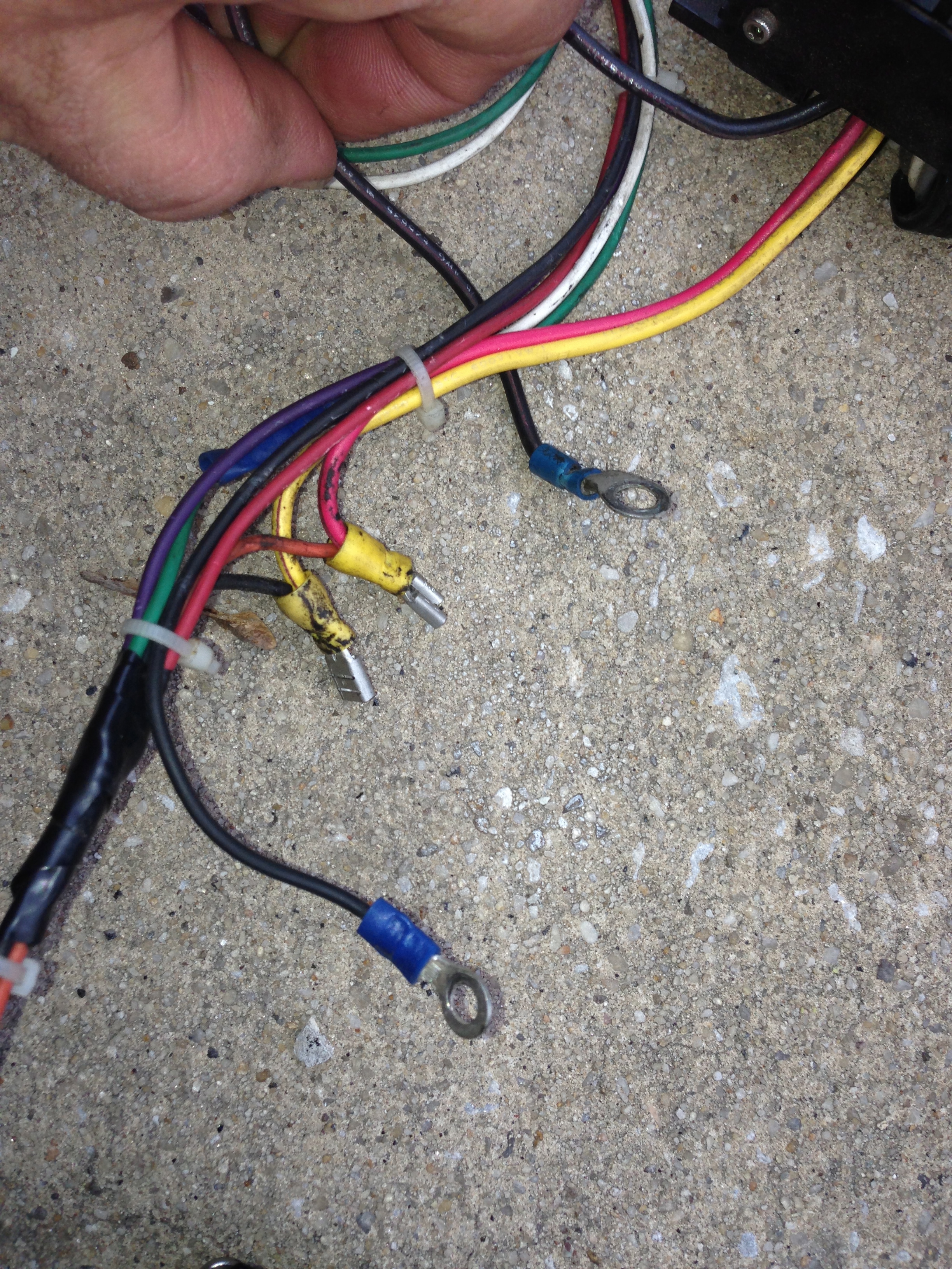

I am ready to connect the ignition. I have a dizzy along with a crane ignition set up. I am wondering about the connections My harness coming from the starter has two female slide connectors that mounted to the blue coil. The new set up is all wired, but it also has female slide connectors. Howe should I proceed? I am thinking I should replace the two females on the crane ignition with males, and that connects to the starter harness. Is it that simple?Attached Image

ChristopherB   here are the two connectors on my car.   Apr 9 2013, 02:37 PM
ChristopherB   I also have these two connectors on my positive ba...   Apr 9 2013, 02:41 PM
904svo   I also have these two connectors on my positive b...   Apr 9 2013, 03:58 PM
ChristopherB   Thanks. That could be it. Car doesn't have h...   Apr 9 2013, 05:37 PM
Dave_Darling   Those first wires are all aftermarket. Someone ad...   Apr 9 2013, 06:10 PM
ChristopherB   Thanks Dave and dpires, I don't know the color...   Apr 11 2013, 03:47 PM
