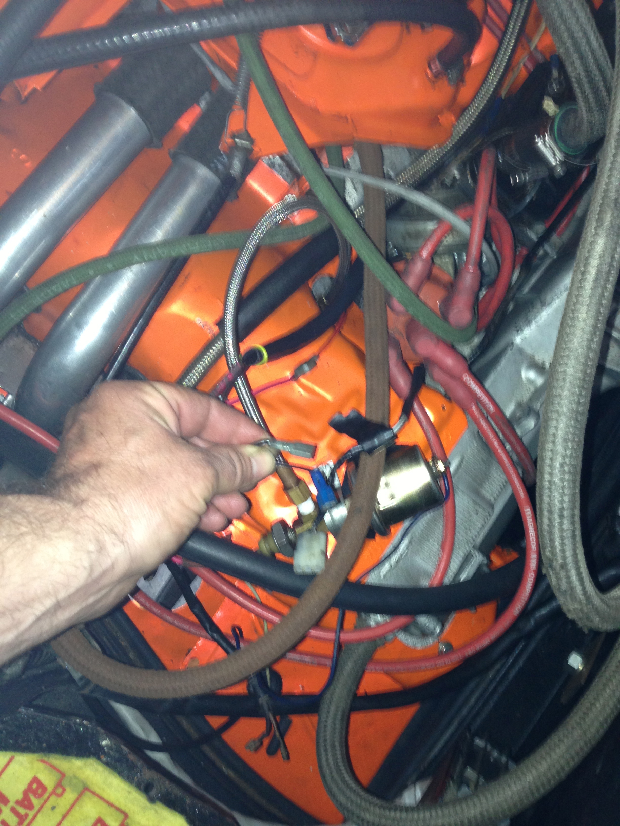

ChristopherB   I am ready to connect the ignition. I have a dizz...   Apr 9 2013, 02:36 PM
ChristopherB   here are the two connectors on my car.   Apr 9 2013, 02:37 PM
ChristopherB   I also have these two connectors on my positive ba...   Apr 9 2013, 02:41 PM
904svo   I also have these two connectors on my positive b...   Apr 9 2013, 03:58 PM
ChristopherB   Thanks. That could be it. Car doesn't have h...   Apr 9 2013, 05:37 PM
Dave_Darling   Those first wires are all aftermarket. Someone ad...   Apr 9 2013, 06:10 PM
ChristopherB   Thanks Dave and dpires, I don't know the color...   Apr 11 2013, 03:47 PM
