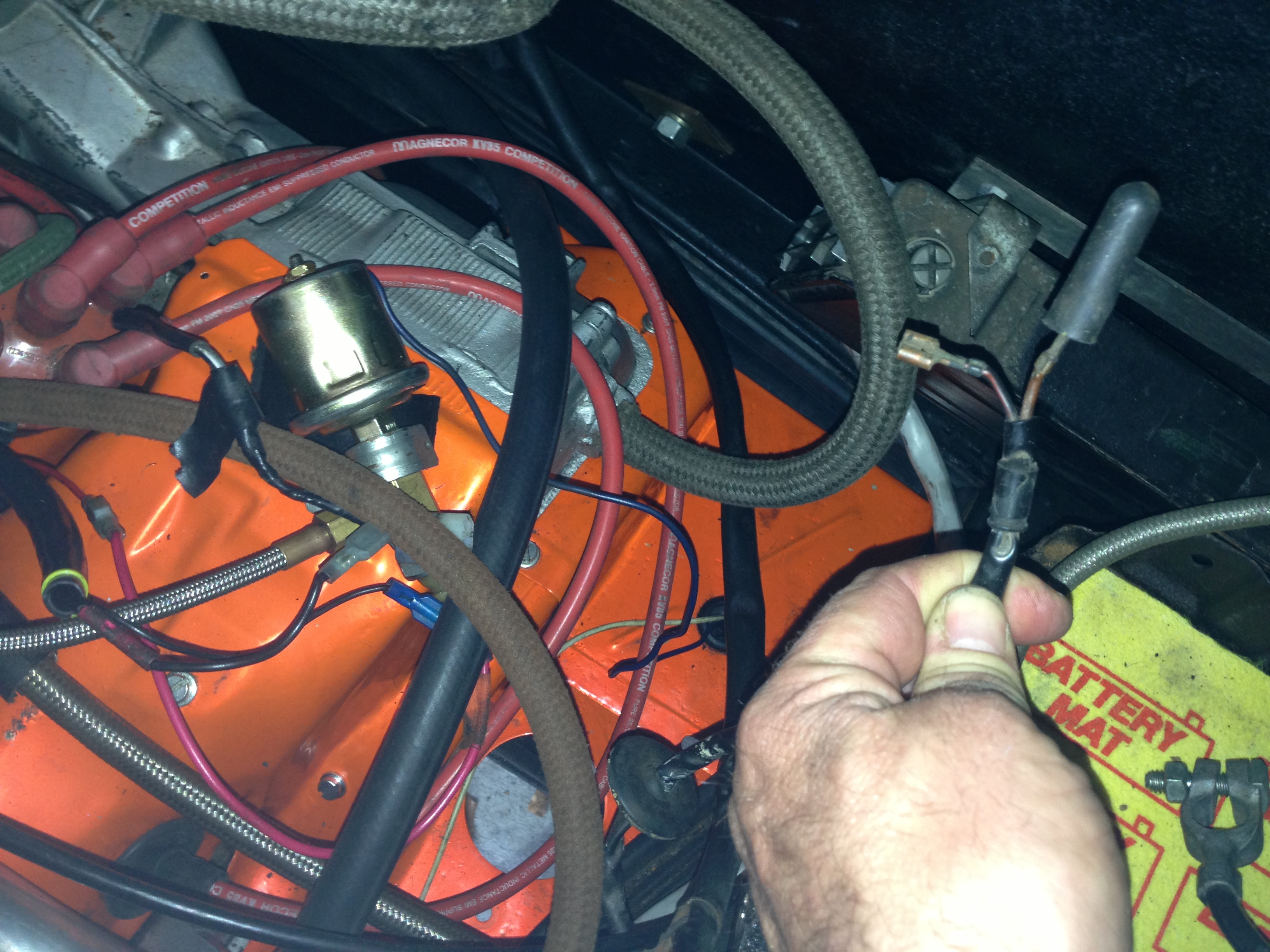

I also have these two connectors on my positive battery cable. One of them was wrapped and the other exposed. Are they used?Attached Image

ChristopherB   I also have these two connectors on my positive ba...   Apr 9 2013, 02:41 PM
904svo   I also have these two connectors on my positive b...   Apr 9 2013, 03:58 PM
ChristopherB   Thanks. That could be it. Car doesn't have h...   Apr 9 2013, 05:37 PM
Dave_Darling   Those first wires are all aftermarket. Someone ad...   Apr 9 2013, 06:10 PM
